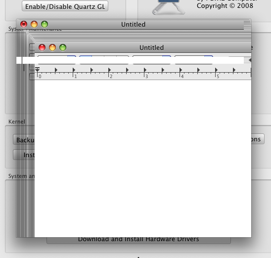

scott_donald Posted February 8, 2009 Share Posted February 8, 2009 hey still having big problems... cant get 9600gt to work... with the drivers from the drivers thread for it - i insall and get no change except scroll is screwed... with drivers and efi string - same as above... with drivers, efi string, nvdarwin 1.25... i get a reboot into a blank black screen... all in 10.5.6... any ideas??? also how with the new chameleon affect an install when it is released??? Link to comment https://www.insanelymac.com/forum/topic/144639-how-to-install-leopard-retail-dvd-on-asus-p6t-deluxe-lga-1366-core-i7/page/11/#findComment-1074195 Share on other sites More sharing options...

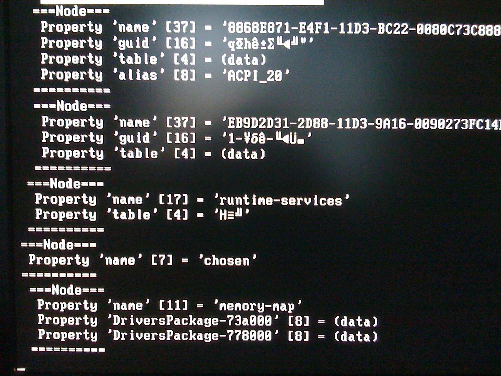

ayacode Posted February 17, 2009 Share Posted February 17, 2009 Ok, some new issues, heh. So i gave in and got an ati 3870 to replace my gtx260 for now. Now I'm getting this when I boot up through EFI: Any ideas? It doesn't come up if boot up with -x. I rebuilt my dsdt file and put it in the EFI disk, still no luck. Installed drivers for the 3870 from http://www.insanelymac.com/forum/index.php?showtopic=107526 still no change. I'm getting mutlimonitor support under safe mode even, so that makes me very happy...but still irking me that i'm in safe mode. Update: aaaand I just noticed I don't have audio =(. But that just might be due to the fact I'm in safe mode, so i won't fret yet. Link to comment https://www.insanelymac.com/forum/topic/144639-how-to-install-leopard-retail-dvd-on-asus-p6t-deluxe-lga-1366-core-i7/page/11/#findComment-1083832 Share on other sites More sharing options...
ayacode Posted February 18, 2009 Share Posted February 18, 2009 Ok, got it fixed.... I had a <key>'Graphics Mode'</key> in my com.apple.boot.plist for the gtx260...I guess my ati card didn't like that, once I took it out...everything is perfect, even audio...now to install xnu, vmware, and try my vpn software again (it had crapped out earlier =p). Link to comment https://www.insanelymac.com/forum/topic/144639-how-to-install-leopard-retail-dvd-on-asus-p6t-deluxe-lga-1366-core-i7/page/11/#findComment-1083951 Share on other sites More sharing options...
