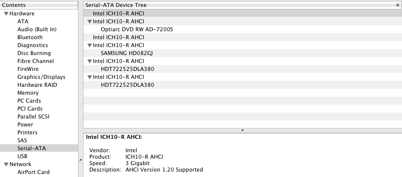

cipz Posted April 27, 2009 Share Posted April 27, 2009 hi Robert.. is esata supported in this mobo? i have maximus II formula on my own i have all drivers needed for my mobo but i can't see esata port in system profiler where to look it? thanks in advanced sorry for my bad english Link to comment https://www.insanelymac.com/forum/topic/144020-mac-os-x-leopard-retail-on-asus-p5q-p5q-pro-p5q-em-and-others/page/25/#findComment-1142557 Share on other sites More sharing options...
Nathan Law Posted April 27, 2009 Share Posted April 27, 2009 After going through a few guides trying to get this to work, I am finally running a near perfect install of Mac OSX retail 10.5.6 . The only thing I did different from the guide was to use EFIstudio to install my video card. I am having a problem detecting my dvd rom drive though. I thought the problem may be that it isn't detecting my ICH10 chipset or something, but I'm not really even sure how to check if thats the problem. Otherwise I installed the AHCI fix and I have no orange discs and everything else, my other hard drives and usb drives, are all detected fine. Any advice? Link to comment https://www.insanelymac.com/forum/topic/144020-mac-os-x-leopard-retail-on-asus-p5q-p5q-pro-p5q-em-and-others/page/25/#findComment-1142574 Share on other sites More sharing options...
apreichner Posted April 27, 2009 Share Posted April 27, 2009 hi Robert.. is esata supported in this mobo? i have maximus II formula on my own i have all drivers needed for my mobo but i can't see esata port in system profiler where to look it? thanks in advanced sorry for my bad english Did you check where all the other SATA ports are listed? It's built in, so IDK, but I would assume it would be there still if it's even supported at all. Have you tried plugging in a drive to it? After going through a few guides trying to get this to work, I am finally running a near perfect install of Mac OSX retail 10.5.6 . The only thing I did different from the guide was to use EFIstudio to install my video card. I am having a problem detecting my dvd rom drive though. I thought the problem may be that it isn't detecting my ICH10 chipset or something, but I'm not really even sure how to check if thats the problem. Otherwise I installed the AHCI fix and I have no orange discs and everything else, my other hard drives and usb drives, are all detected fine. Any advice? I assume the DVD drive is SATA? It shouldn't be a problem with ICH10 considering all other drives work. What motherboard are you using? If it is P5Q ProMake sure the drive is plugged into the red SATA and not the white or orange ones; they are not supported as of yet in OS X. I don't know if this is the same for other boards or not... To All: I see that Robert is taking a vacation to see his girl , so in the mean-time I'll try my best to help anybody, so you can keep asking questions... Link to comment https://www.insanelymac.com/forum/topic/144020-mac-os-x-leopard-retail-on-asus-p5q-p5q-pro-p5q-em-and-others/page/25/#findComment-1142604 Share on other sites More sharing options...
rocksteady Posted April 27, 2009 Share Posted April 27, 2009 Update for anyone following my guide: You can use the retail Mac OS X Install DVD 10.5.6 (9G55) and thus save more time, 100% confirmed-working on P5Q-EM is esata supported in this mobo?but i can't see esata port in system profiler where to look it? there's nothing special about e-sata as long as your sata controller gets recognized correctly + as long as your eSATA ports are part of the same controller (ie OnBoard vs. extra PCI/PCIe card) i tested an external eSATA RAID on P5Q-EM, worked just fine on the OnBoard controller (ICH10) Link to comment https://www.insanelymac.com/forum/topic/144020-mac-os-x-leopard-retail-on-asus-p5q-p5q-pro-p5q-em-and-others/page/25/#findComment-1142808 Share on other sites More sharing options...

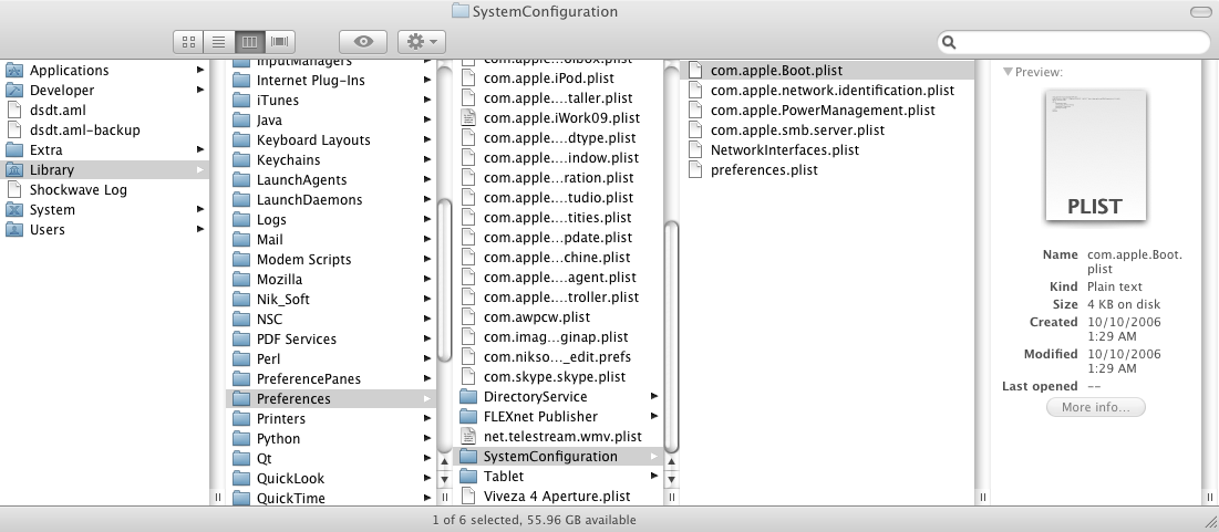

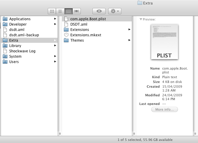

barnum Posted April 27, 2009 Share Posted April 27, 2009 Hi all, Does someone use the /EFI/Extra/Extensions Folder with chameleon 2 bootloader ? If yes can you tell me which Kext did you put on it. Thanks Vincent Link to comment https://www.insanelymac.com/forum/topic/144020-mac-os-x-leopard-retail-on-asus-p5q-p5q-pro-p5q-em-and-others/page/25/#findComment-1142849 Share on other sites More sharing options...
rocksteady Posted April 27, 2009 Share Posted April 27, 2009 Does someone use the /EFI/Extra/Extensions Folder with chameleon 2 bootloader ? i do, If yes can you tell me which Kext did you put on it. just 2 are necessary for any hackintosh: 1) dsmos.kext or AppleDecrypt.kext + 2) Disabler.kext additional kexts you might put in /Extra depend on your setup/hardware Link to comment https://www.insanelymac.com/forum/topic/144020-mac-os-x-leopard-retail-on-asus-p5q-p5q-pro-p5q-em-and-others/page/25/#findComment-1142936 Share on other sites More sharing options...
