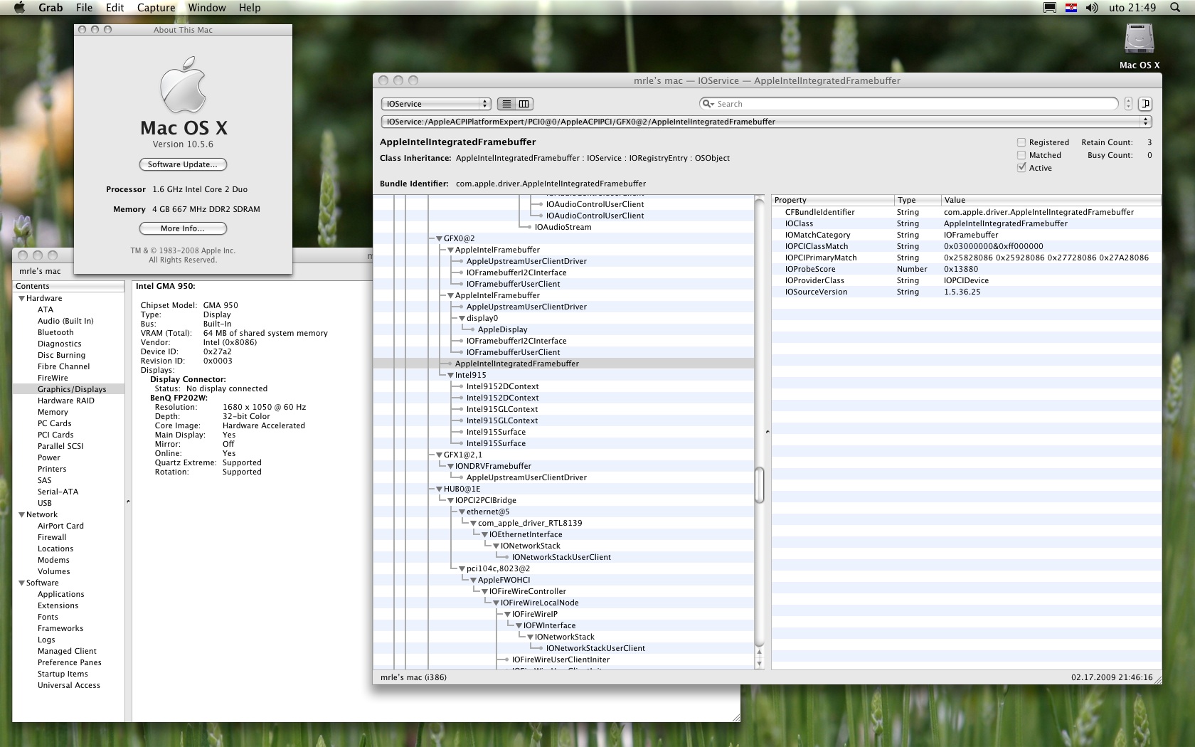

mrle Posted February 15, 2009 Share Posted February 15, 2009 Does anyone know how to get secondary display to work with dsdt patch? I have an Abit il90-MV mainboard, i945GT chipset, GMA950 device 0x27a2. The board has VGA and HDMI output (HDMI can work in DVI mode). So, without the patch, I have both primary (VGA) and secondary (DVI) display working, same picture on both, limited to 1024x768. With the patch, both seem to work during boot, and then when the driver loads, DVI gets no signal and VGA keeps working, at proper resolution (1680x1050). System profiler shows "No display connected" on first Display Connector, and correctly detected analog monitor on second. I'd really like to use DVI, since the VGA output at this resolution is very blurry. I tried adding another Device in the dsdt, but that didn't help at all... Link to comment https://www.insanelymac.com/forum/topic/143340-final-solution-fix-for-gma950-desktop-edition-new-28-dec-08/page/13/#findComment-1081395 Share on other sites More sharing options...

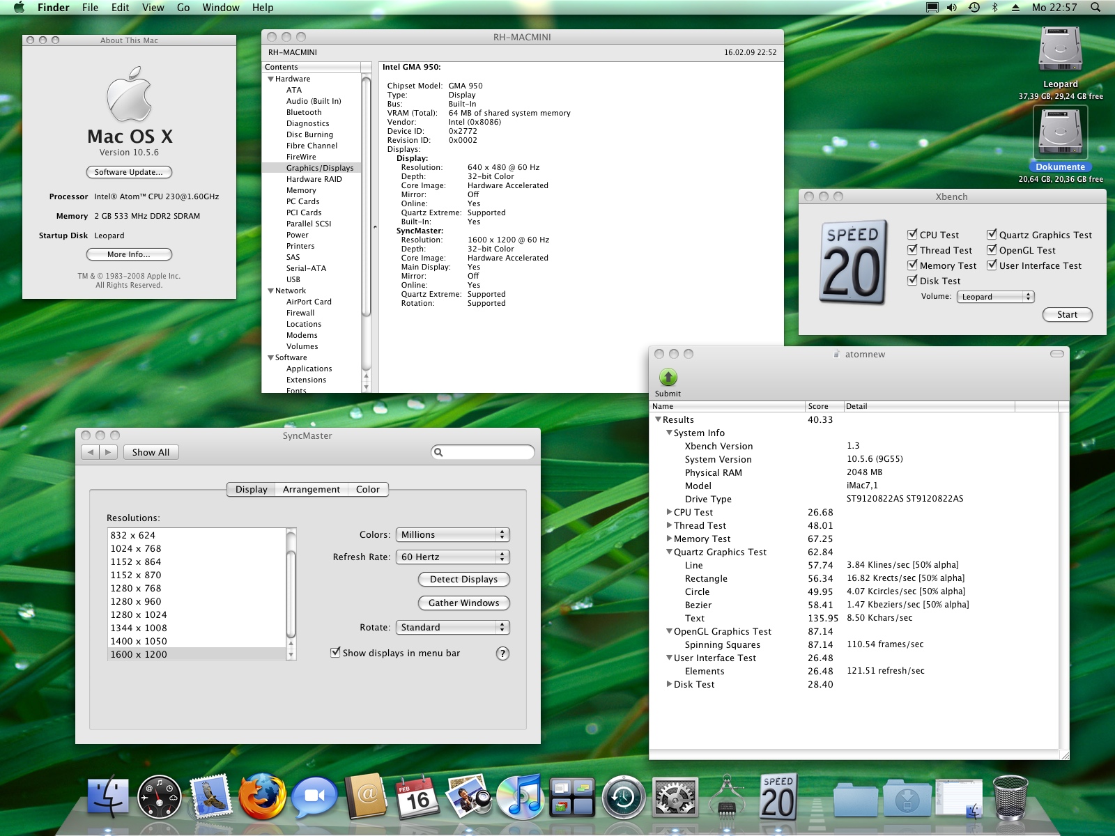

rickberman66 Posted February 16, 2009 Share Posted February 16, 2009 Working for me to on a D945GCLF Intel Board with Retail Install/Kernel, Chameleon DSDT. One Problem on the install: There was no "Scope (_SI)" in my DSDT.dsl so i pasted it above "Scope (_SB)" but it works too. OS X recognized two monitors and extended the desktop to this two, but physically this board just has one graphics-connector, so the second screen is not existing. If you select syncronisizing/mirrroring the screen gets scrambled an you can't see anything clear but the cursor. Nevertheless, QE/CI working, no tearing, no graphic errors, resolution/refresh rate selection possible, Color-profiles working ... Great Work! rick Link to comment https://www.insanelymac.com/forum/topic/143340-final-solution-fix-for-gma950-desktop-edition-new-28-dec-08/page/13/#findComment-1082715 Share on other sites More sharing options...

mrle Posted February 17, 2009 Share Posted February 17, 2009 OS X recognized two monitors and extended the desktop to this two, but physically this board just has one graphics-connector, so the second screen is not existing. If you select syncronisizing/mirrroring the screen gets scrambled an you can't see anything clear but the cursor. In my case, it looks like the second AppleIntelFramebuffer is detected, but the display attached to it is not. I'm also getting some "family specific matching fails" errors with GFX0 in system.log. And another strange thing, there is one other GMA 950 display adapter at the address 00020001. I created Device section for it in dsdt, and gets detected as GFX1. But it has device id 0x27a6 so stock GMA 950 kext doesn't recognize it correctly. Link to comment https://www.insanelymac.com/forum/topic/143340-final-solution-fix-for-gma950-desktop-edition-new-28-dec-08/page/13/#findComment-1083771 Share on other sites More sharing options...

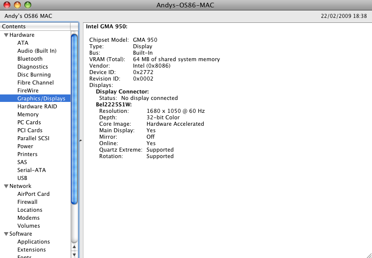

awaddon Posted February 22, 2009 Share Posted February 22, 2009 Dr Hurt, Ive been following this thread with interest as i have a Asrock Conroe 1333 DVI/H mobo with GMA950, i have had glitches and artifacts etc, so i thought id give it a go!, I first installed the PC EFI chameleon bootloader that posted on the start of this thread and then installed the stock kexts also supplied. Following the first part of your guide I created a normal DSDT.aml file and did the reboot to test as stated by the guide! now when it restarted with this 'normal DSDT.aml' file I had: All resolutions Core image - Hardware Accelerated Quartz Extreme - Supported Rotation - Supported All that without even inserting the additional code in the second part of the guide graphics are smooth and no glitches artifacts or mouse tearing whatsoever! Is the extra code going to do something extra, or should i just stick with what i have!, is there something I can do to test all is fine and performing well?! Also, if possible, is there any way of getting the full 224mb of shared memory my board has, instead of just 64mb? Thanks in advance Andy Link to comment https://www.insanelymac.com/forum/topic/143340-final-solution-fix-for-gma950-desktop-edition-new-28-dec-08/page/13/#findComment-1088284 Share on other sites More sharing options...
Dr. Hurt Posted February 22, 2009 Author Share Posted February 22, 2009 Dr Hurt, Ive been following this thread with interest as i have a Asrock Conroe 1333 DVI/H mobo with GMA950, i have had glitches and artifacts etc, so i thought id give it a go!, I first installed the PC EFI chameleon bootloader that posted on the start of this thread and then installed the stock kexts also supplied. Following the first part of your guide I created a normal DSDT.aml file and did the reboot to test as stated by the guide! now when it restarted with this 'normal DSDT.aml' file I had: All resolutions Core image - Hardware Accelerated Quartz Extreme - Supported Rotation - Supported All that without even inserting the additional code in the second part of the guide graphics are smooth and no glitches artifacts or mouse tearing whatsoever! Is the extra code going to do something extra, or should i just stick with what i have!, is there something I can do to test all is fine and performing well?! Also, if possible, is there any way of getting the full 224mb of shared memory my board has, instead of just 64mb? Thanks in advance Andy Strange - Are you using the stock kexts?! If everything is working well without the extra code then its fine. Also, it's already using the whole 244MB of vram, but os x reports it as 64MB (only cosmetic issue). Link to comment https://www.insanelymac.com/forum/topic/143340-final-solution-fix-for-gma950-desktop-edition-new-28-dec-08/page/13/#findComment-1088300 Share on other sites More sharing options...
awaddon Posted February 22, 2009 Share Posted February 22, 2009 Strange - Are you using the stock kexts?!If everything is working well without the extra code then its fine. Also, it's already using the whole 244MB of vram, but os x reports it as 64MB (only cosmetic issue). Yes, using the stock kexts available at start of this thread! thanks for the guide, it was the only thing that didn't work properely!, all is good now! Does this work with custom kernels? im running the Voodoo 9.5.0 right now as i cant get Vanilla working Anybody got this working with the ASROCK Conroe1333-D667 and has a working DSDT? @Sonic-NKT Try using the, 9.4.0 StageXNU Universal Kernel it is listed on the OSX86 H.C.L for your board, (I assume you used the OSX86 install disk!) My board is of the same family 'Conroe1333 DVI/H' and it worked for me too! after this patch for GMA950 everything works great for me! but like i said before I only followed the first part of the guide and it worked on the normal DSDT file without adding the extra code! Link to comment https://www.insanelymac.com/forum/topic/143340-final-solution-fix-for-gma950-desktop-edition-new-28-dec-08/page/13/#findComment-1088304 Share on other sites More sharing options...
Sonic-NKT Posted February 22, 2009 Share Posted February 22, 2009 which version did you use? V3 or V4? i installed the different kext with OSX86 tool and installed the bootloader but couldnt get it working (it crashed on the boot screen) Is it save to use 9.4.0 on 10.5.6? voodoo 9.5.0 runs fine. Link to comment https://www.insanelymac.com/forum/topic/143340-final-solution-fix-for-gma950-desktop-edition-new-28-dec-08/page/13/#findComment-1088524 Share on other sites More sharing options...
awaddon Posted February 23, 2009 Share Posted February 23, 2009 Strange - Are you using the stock kexts?!If everything is working well without the extra code then its fine. Also, it's already using the whole 244MB of vram, but os x reports it as 64MB (only cosmetic issue). HI Dr Hurt!, Sorry, scratch what i said before i think i still had the kexts from the OSx86 installation or something when i actually created the first DSDT.aml file!, maybe,... went wrong somewhere!, Anyway I was not getting proper shutdown or sleep so i decided to start form scratch - i still had the stock kexts installed so i removed and trashed the current DSDT.aml file - Rebooted and got default resolution (only one choice, cant remember what it was now!) - Then followed part one the guide and created a new DSDT.aml file - Rebooted and got same resoution! - Then went on to part two entering the relevant code as described but like others here had no part where it said 'Scope (_SI)' so after a bit of trawling through others uploaded DSDT files I found they were inserting the code in different places depending on board, I found one from 'vani' who has newer revision of my board - Thanks vani!! and put my code where he did (after the "Method (GPRW, 2, NotSerialized)" bit!), like so: Method (GPRW, 2, NotSerialized) { Store (Arg0, Index (PRWP, Zero)) Store (ShiftLeft (SS1, One), Local0) Or (Local0, ShiftLeft (SS2, 0x02), Local0) Or (Local0, ShiftLeft (SS3, 0x03), Local0) Or (Local0, ShiftLeft (SS4, 0x04), Local0) If (And (ShiftLeft (One, Arg1), Local0)) { Store (Arg1, Index (PRWP, One)) } Else { ShiftRight (Local0, One, Local0) If (LOr (LEqual (OSFL (), One), LEqual (OSFL (), 0x02))) { FindSetLeftBit (Local0, Index (PRWP, One)) } Else { FindSetRightBit (Local0, Index (PRWP, One)) } } Return (PRWP) } Name (WAKP, Package (0x02) { Zero, Zero }) OperationRegion (DEB0, SystemIO, 0x80, One) Field (DEB0, ByteAcc, NoLock, Preserve) { DBG8, 8 } OperationRegion (DEB1, SystemIO, 0x90, 0x02) Field (DEB1, WordAcc, NoLock, Preserve) { DBG9, 16 } Method (DTGP, 5, NotSerialized) { If (LEqual (Arg0, Buffer (0x10) { /* 0000 */ 0xC6, 0xB7, 0xB5, 0xA0, 0x18, 0x13, 0x1C, 0x44, /* 0008 */ 0xB0, 0xC9, 0xFE, 0x69, 0x5E, 0xAF, 0x94, 0x9B })) { If (LEqual (Arg1, One)) { If (LEqual (Arg2, Zero)) { Store (Buffer (One) { 0x03 }, Arg4) Return (One) } If (LEqual (Arg2, One)) { Return (One) } } } Store (Buffer (One) { 0x00 }, Arg4) Return (Zero) } Scope (_SB) { Name (PR00, Package (0x12) { Package (0x04) - Then added the second bit of code as described in the guide, saved it, recompiled and rebooted! restarted with all resolutions, Core Image , Quartz Extreme etc. and shutdown, sleep and restart all work fine now!! pheww! Thanks again! which version did you use? V3 or V4? i installed the different kext with OSX86 tool and installed the bootloader but couldnt get it working (it crashed on the boot screen) Is it save to use 9.4.0 on 10.5.6? voodoo 9.5.0 runs fine. @Sonic-NKT from the 10.5.6 OSx86 disc I installed: - 9.4.0 StageXNU Universal Kernel - works fine! - Intel ICHx SATA Drivers (in the chipsets folder) - GMA 950 Video Driver (but skip this and let it install stock ones so you can patch your DSDT.aml) - Realtek 1000 network driver - Azalia Audio Driver - Patched USB Drivers there is also the chameleon bootloader in "alternative bootloaders" but i used the one at the beginning of this thread after install - not sure if its the same one! ...and now with this GMA 950 patch found here thanks to the guys involved!, everything works sweet! Hope this helps..., I have also attached my DSDT.aml file and DSDT.dsl files incase they might help with the placement of you code ASROCK_Conroe1333_DVI_H.zip Link to comment https://www.insanelymac.com/forum/topic/143340-final-solution-fix-for-gma950-desktop-edition-new-28-dec-08/page/13/#findComment-1088652 Share on other sites More sharing options...
