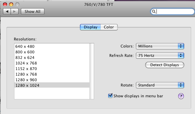

GnatGoSplat Posted March 24, 2009 Share Posted March 24, 2009 I'm using a Jetway J9F2-KHDE. It has GMA950 (Dev: 0x27A2, Ven: 0x8086, Rev: 0x0003) and 4 possible video connections: LVDS, DVI, HDMI, and VGA. Right now I would really like to use DVI. With original 10.5.6 kexts, DVI works, but I got no resolutions, no QE/CI, and max resolution was 1280x1024 (I need 1920x1200). VGA did not work at all. I required an old, hacked AppleIntelIntegratedFramebuffer.kext to get resolutions and QE/CI, etc., BUT only VGA worked perfectly, DVI did not work at all, it would go to blue screen until I plugged the monitor into VGA. With both the DSDT.aml in V3 and also patching my own with Patcher.zip, I am now able to have everything working with VGA and stock kexts... resolution change, rotation, QE/CI, it all works great w/VGA... only DVI doesn't work. Just the fact that a DSDT.aml got the stock kexts working this well makes me think a DSDT.aml could get my DVI working, or better yet, both DVI+VGA for dual monitor. Is this possible? Would someone please help? I've been searching for a solution to the DVI problem for quite some time now! Link to comment https://www.insanelymac.com/forum/topic/143340-final-solution-fix-for-gma950-desktop-edition-new-28-dec-08/page/14/#findComment-1114191 Share on other sites More sharing options...

joeydg Posted May 15, 2009 Share Posted May 15, 2009 hello !SUCCESS !!! ASUS P5 GC-MX 1333 - GMA 950 integrated graphics fully working with leopard 10.5.6... So, the solution was to use a 13 pins VGA cable instead of a 14 pins or 15 pins. With this configuration, the boot doesn't end on a blue screen, but switch automatically in 1400*1050@85Hz mode. The missing pins are pin 5 and pin 9. The problem was just the cable !!! The DSDT patched with the method of Dr.Hurt and Roisoft works perfectly ! And, now, my monitor is recognized as "GDM5403", and not like before as "Unknown Monitor". Cool ! MANY THANKS FOR DR. HURT AND ROISOFT (and nebulOSX ) !!! Can you post links and a quick tutorial for your motherboard? I understand the pins, but not the rest of what you did. I have the same mother board, but don't understand what I need to do or which files you're talking about. Thanks. Also, my install method was using Pacifist to open the main package and then install contents of the updater from Apple. Then I reinstalled my sound, LAN, and video kexts. I am not using vanilla. Is that OK? My old install was 10.5.4 Link to comment https://www.insanelymac.com/forum/topic/143340-final-solution-fix-for-gma950-desktop-edition-new-28-dec-08/page/14/#findComment-1156941 Share on other sites More sharing options...
joeydg Posted May 15, 2009 Share Posted May 15, 2009 OK. I followed the method. I removed pins 5 and 9, followed the instructions from Dr. Hurt's tutorial, and inserted the code in the places specified in Roisoft's post. I ended with 5 warnings and 0 errors. On reboot, I got the blue screen until I unplugged the monitor. After that, I got tons of resolutions from the "display preferences" pane... but not the resolution of my monitor (1440x900). What gives? And when is that magic patcher going to be ready. I'm anxious to have it patch itself for me. Also, when I do the patching process, Im always left with an extre DSDT.asm file in addition to the DSDT.aml file. Below is the result: /DSDT.dsl 2967: Method (OCOP, 1, Serialized) Warning 1087 - ^ Not all control paths return a value (OCOP) /DSDT.dsl 3243: Method (PROC, 3, Serialized) Warning 1087 - ^ Not all control paths return a value (PROC) /DSDT.dsl 3380: Subtract (Local2, 0x1E) Warning 1105 - Result is not used, operator has no effect ^ /DSDT.dsl 3381: Subtract (Local4, 0x4B) Warning 1105 - Result is not used, operator has no effect ^ /DSDT.dsl 3480: Store (PROC (Local0, Local1, Zero), Local2) Warning 1092 - ^ Called method may not always return a value ASL Input: /DSDT.dsl - 7091 lines, 231543 bytes, 3307 keywords AML Output: //DSDT.aml - 26051 bytes, 857 named objects, 2450 executable opcodes Link to comment https://www.insanelymac.com/forum/topic/143340-final-solution-fix-for-gma950-desktop-edition-new-28-dec-08/page/14/#findComment-1157112 Share on other sites More sharing options...
