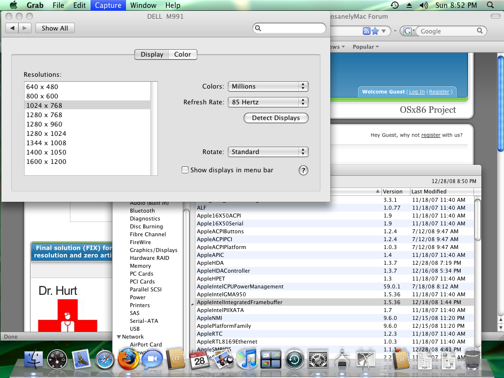

OS X had trouble detecting the proper address of the GMA950 desktop version (due to broken DSDT ) so the newer framebuffers would not load.
The proper GMA950 address was added (hard coded) to the DSDT.aml (using lspci from linux) to make OS X recognize the GMA950 and load the newer framebuffer. No EFI strings, not injectors, no nothing!!
This will allow you to use stock drivers and not worry about graphics in system updates.

It appears to almost work, I have everything setup, after the grey apple boot screen the blue screen comes and resolution changes (which it didn't do before) but the cursor doesn't appear and it freezes on my wallpaper, no finder, loginwindow dock or anything.
So its a step in the right direction, but no worky..

Does the same thing as before :s freezes on wallpaper, but there is a resolution change before the wallpaper is displayed...
Share this post
Link to post
Aha, i realize what its doing! It thinks theres two displays! I can move the mouse over to this display... The main monitor is being seen as the secondary monitor and the primary monitor is.... non existant.
