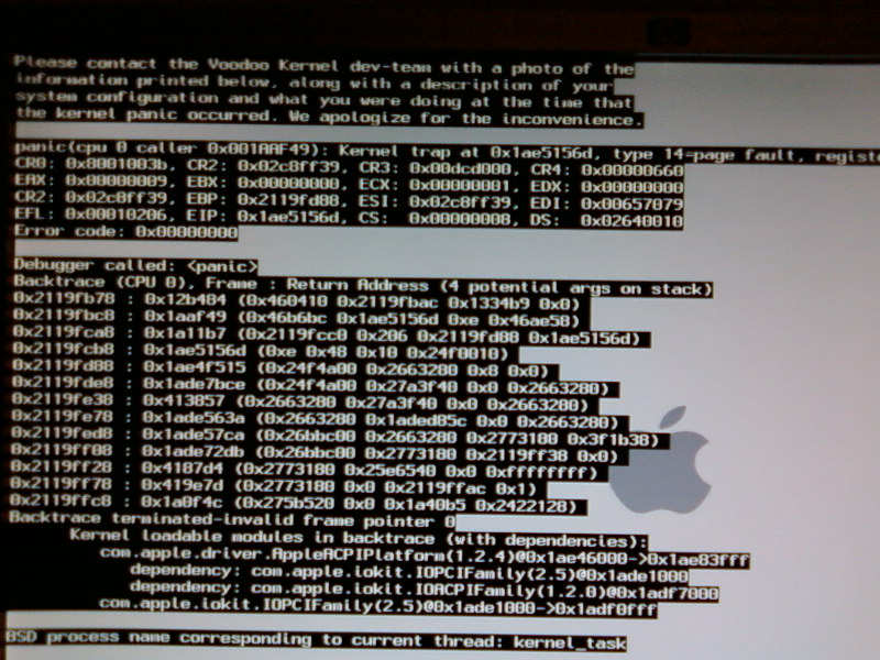

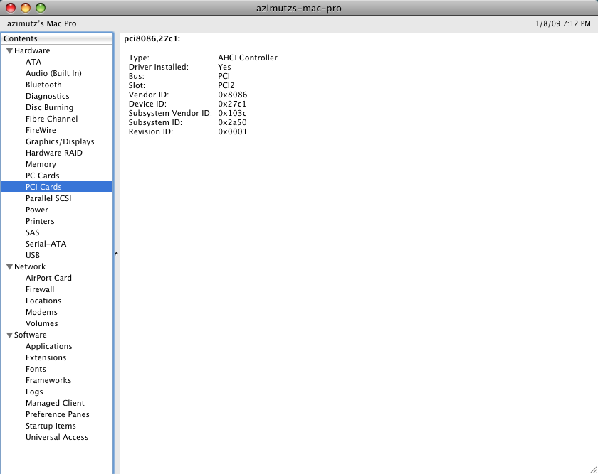

Azimutz Posted January 8, 2009 Share Posted January 8, 2009 Hello good people.. Dr. Hurt.. v3 works for me! It only adds a PCI device and it's a correct one. (check pic) V4 gives me a kp.. check pic too. The only problem i have is Time Machine.. that is a problem i didn't had but, i don't really know were or when it started. I don't use TM that much so, i didn't used it since 10.5.6 update but, it was working after that. Now i have to use the device string fix or i'll get "network device not found..". I did removed DSDT.aml to see if it was the cause but, problem still there. Will check again.. Not that important as long as there's a fix Checked your guide.. looks pretty easy.. will give it a try soon, though the DSDT.aml i'm using (made by roisoft) works fine. I have to start messing with DSDT and these guides are a good start. Thanks mate Link to comment https://www.insanelymac.com/forum/topic/143340-final-solution-fix-for-gma950-desktop-edition-new-28-dec-08/page/8/#findComment-1032786 Share on other sites More sharing options...
Dr. Hurt Posted January 8, 2009 Author Share Posted January 8, 2009 Given the vast amount of differences between DSDT in different systems, and the large amount of problems people having, I thought it would be best i everyone just creates thier own DSDT. Time Machine can be fixed either by DSDT, Kext patching, or EFI strings. V3 has the time machine fix, V4 doesn't. I don't recommend adding the TM fix in the DSDT. It tends to cause ethernet issues. Again, I highly recommend that everyone creates his own patched DSDT to avoid problems and ensure best overall system performance. Azimutz, you too should create your own DSDT. Although roisoft's DSDT and my V3 work, they still won't give the performance you'll get when you create your own DSDT. Link to comment https://www.insanelymac.com/forum/topic/143340-final-solution-fix-for-gma950-desktop-edition-new-28-dec-08/page/8/#findComment-1032805 Share on other sites More sharing options...
Azimutz Posted January 8, 2009 Share Posted January 8, 2009 Given the vast amount of differences between DSDT in different systems, and the large amount of problems people having, I thought it would be best i everyone just creates thier own DSDT. Time Machine can be fixed either by DSDT, Kext patching, or EFI strings. V3 has the time machine fix, V4 doesn't. I don't recommend adding the TM fix in the DSDT. It tends to cause ethernet issues. Again, I highly recommend that everyone creates his own patched DSDT to avoid problems and ensure best overall system performance. Azimutz, you too should create your own DSDT. Although roisoft's DSDT and my V3 work, they still won't give the performance you'll get when you create your own DSDT. Dr. Hurt.. DSDT.aml i'm using, made by roisoft, was made from dsdt.dat, ioreg and lspci from my machine certainly it's better than if i do it But you are right and i will do it my self.. need to learn. Totally agree with you! DSDTs are very "machine specific". I had "all" my devices working without DSDT so, i have every interest in doing one myself and add only what i need. Time Machine is under control.. added device string with EFIStudio to Boot.plist. My network sometimes fails to load, mainly when i tested diferent DSDT.. maybe related with TM patch in DSDT (following your lead).. i think roisoft placed TM patch in my DSDT, not shure!? have to talk to him.. If he placed it, it's NOT working cause, i have to use the string. And it doesn't work with your v3 too. When i stop tests and things get stable, no problems! Best OS X install so far. Much better handling of graphics=better overall performance. Just wish i could do the same to ATI. Anyway.. Your v3 works fine for me! The Time Machine problem is not from DSDT. Just confirmed it without DSDT. And the kp with v4, may not be caused by DSDT, though every time i used it had that kp. I'll come around when i have done the guide or if i have any tip.. Thanks again. Link to comment https://www.insanelymac.com/forum/topic/143340-final-solution-fix-for-gma950-desktop-edition-new-28-dec-08/page/8/#findComment-1032976 Share on other sites More sharing options...
