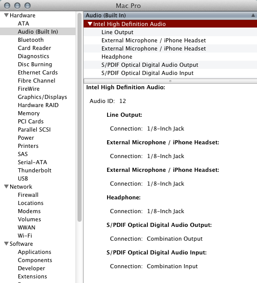

T a D Posted October 24, 2011 Share Posted October 24, 2011 Another data point for others to find.... GA-P35-DS3P, BIOS F12B (Rev 1.1 board I think) OS X 10.7.2 with vanilla AppleHDA.kext and no other HDA related kexts installed (only non-vanilla next is FakeSMC.kext) ALC-889a audio working with the following DSDT patch for HDEF: Device (HDEF) { Name (_ADR, 0x001B0000) Method (_PRW, 0, NotSerialized) { Return (Package (0x02) { 0x0D, 0x05 }) } Method (_DSM, 4, NotSerialized) { Store (Package (0x0A) { "built-in", Buffer (One) { 0x01 }, "codec-id", Buffer (0x04) { 0x85, 0x08, 0xEC, 0x10 }, "layout-id", Buffer (0x04) { 0x0C, 0x00, 0x00, 0x00 }, "device-type", Buffer (0x10) { "Realtek ALC889A" }, "PinConfigurations", Buffer (0x01) { 0x00 } }, Local0) DTGP (Arg0, Arg1, Arg2, Arg3, RefOf (Local0)) Return (Local0) } } Tested with codec-id of 0x85, 0x08, 0xEC, 0x10 and 0x89, 0x08, 0xEC, 0x10 - both worked Tested with layout-id of 0x0C, 0x00, 0x00, 0x00 and 0x0C, 0x00, 0x00, 0x00 - both worked, gave slightly different names for the connections. DSDT attached - includes patches to make SATA drives appear as internal and a couple of others I forget (Time Machine fix probably). It's not 100% though, the following errors appear in the system log after boot: 24/10/11 2:16:20.000 PM kernel: Sound assertion "0 != result" failed in AppleHDAWidget at line 3875 goto handler 24/10/11 2:16:20.000 PM kernel: Sound assertion "0 != widget->setUnsolicited ( true )" failed in AppleHDACodecGeneric at line 1162 goto handler 24/10/11 2:16:20.000 PM kernel: Sound assertion "0 != result" failed in AppleHDAWidget at line 3875 goto handler 24/10/11 2:16:20.000 PM kernel: Sound assertion "0 != widget->setUnsolicited ( true )" failed in AppleHDACodecGeneric at line 1162 goto handler 24/10/11 2:16:20.000 PM kernel: Sound assertion "0 != result" failed in AppleHDAWidget at line 3875 goto handler 24/10/11 2:16:20.000 PM kernel: Sound assertion "0 != widget->setUnsolicited ( true )" failed in AppleHDACodecGeneric at line 1162 goto handler 24/10/11 2:16:20.000 PM kernel: Sound assertion "0 != result" failed in AppleHDAWidget at line 3875 goto handler 24/10/11 2:16:20.000 PM kernel: Sound assertion "0 != widget->setUnsolicited ( true )" failed in AppleHDACodecGeneric at line 1162 goto handler 24/10/11 2:16:20.000 PM kernel: Sound assertion "0 != result" failed in AppleHDAWidget at line 3875 goto handler 24/10/11 2:16:20.000 PM kernel: Sound assertion "0 != widget->setUnsolicited ( true )" failed in AppleHDACodecGeneric at line 1162 goto handler 24/10/11 2:16:20.000 PM kernel: Sound assertion "0 != result" failed in AppleHDAWidget at line 3875 goto handler 24/10/11 2:16:20.000 PM kernel: Sound assertion "0 != widget->setUnsolicited ( true )" failed in AppleHDACodecGeneric at line 1162 goto handler dsdt_hda_sata_patched.aml.zip Link to comment https://www.insanelymac.com/forum/topic/140941-alc889a-gigabyte-intel-now-having-a-working-front-mic/page/45/#findComment-1763928 Share on other sites More sharing options...

ummd Posted November 8, 2011 Share Posted November 8, 2011 Another data point for others to find.... GA-P35-DS3P, BIOS F12B (Rev 1.1 board I think) OS X 10.7.2 with vanilla AppleHDA.kext and no other HDA related kexts installed (only non-vanilla next is FakeSMC.kext) ALC-889a audio working with the following DSDT patch for HDEF: First off, thanks for the layout-id! Finally I have come across the right one.. I am seeing the exact same assertions as you, but I also noticed that my line out audio outputs to the black speaker jack and not the green, are you seeing the same thing? Does anybody have an idea how to correct this? Link to comment https://www.insanelymac.com/forum/topic/140941-alc889a-gigabyte-intel-now-having-a-working-front-mic/page/45/#findComment-1768932 Share on other sites More sharing options...
