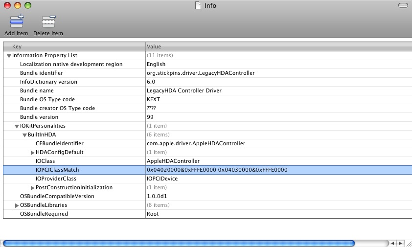

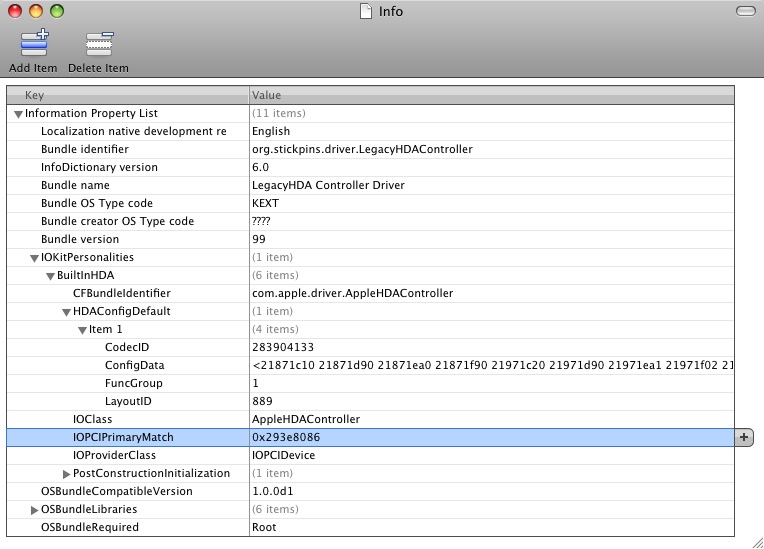

VCH888 Posted February 19, 2009 Author Share Posted February 19, 2009 @Yardie 1) Try to remove Node 0x11 in Controller.kext and see what happens. 2) Try to change from IOPCIClassMatch to IOPCIPrimaryMatch (Value type as String) in Controller and find what is your PCIprimary of soundcard. You can see properties in Windows. For example, my MOBO is EP35-DS3P, IOPCIPrimaryMatch = 0x293e8086. For Example; Before After @winktinkler Could you post errors of Sound assertion? Link to comment https://www.insanelymac.com/forum/topic/140941-alc889a-gigabyte-intel-now-having-a-working-front-mic/page/5/#findComment-1085450 Share on other sites More sharing options...
