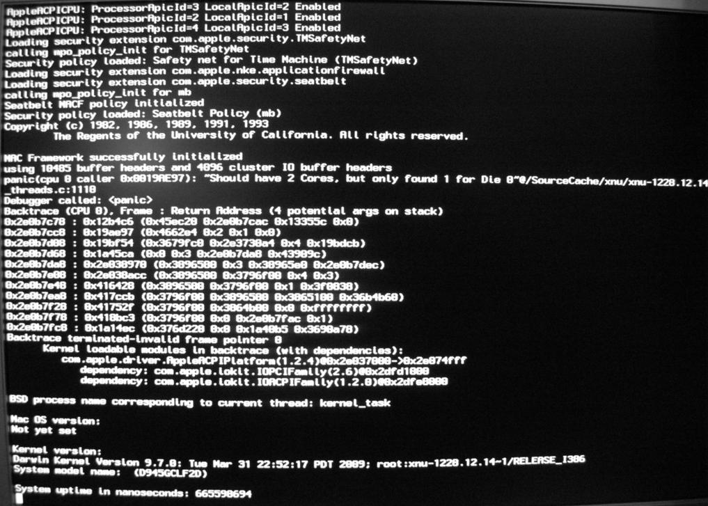

has anyone updated using software update to 10.5.7 yet? it was just released today and i built this system for my sister...would like to have an idea if this is gonna crash her 'mini'. i did a retail install only with DSDT for gma950....thanks
10.5.7 boots up with cpus=1 for me
else: uhohx.th.jpg
(kernel panic: "Should have 2 Cores, but only found 1 for Die 0")
Fresh 10.5.0 retail install with Boot 132 + 10.5.7 combo update.
I am getting the same error. I'm trying to go back as I type this.
I have this board, and last night installed the update - of course I get the same kernel panic as is posted - kind of a bummer.
I'm using a retail 10.5.6 installation disk - uefi/refit install - no chameleon. - Same error.
I thought it might be the machine identifier as mine is set to Mac Pro (its looking for more cores than I have) but nope.
thats not it.
Kind of stopped this machine dead in its tracks hey.
Same error here, i guess we need a fix :)
Hey everyone,
I just picked one of these up this week and updated to 10.5.7 today as well.. While there may be a better fix - to atleast get things running again go into your BIOS and disable hyperthreading
This isnt the best solution as it will impact performance some - but its better than disabling the 2nd core by using cpus=1.
Hope this helps, still haven't found a better fix and I've spent an hour on it tonight.

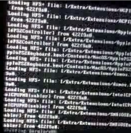

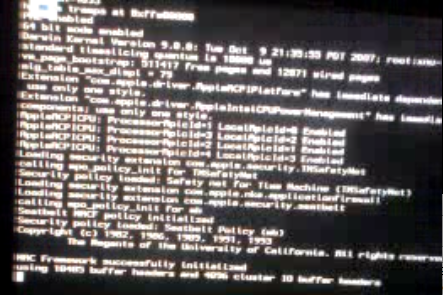

...when I swap my Leopard DVD into the drive and have it boot I get a few flashes of the classic grey screen + Apple logo and the machines immediately resets...
Anyone have some idea on what I could do about this?
Any help will be much appreciated.
Boot with -v and report where it stops...
Patrick
OK. I managed to record it with my cell phone as it boots. I've attached two images.
It appears to be booting, then (with -v) it prints out a bunch of messages and the last batch is seen on the first picture.
Then the screen flashes, and the text on the second picture appears so briefly (like a 1/8th of a second) you can only tell there's text. The machine immediately resets after that.
PS: Sorry for the crappy image quality and not actually typing the text to make it easier but most of it is blur and I've no idea what it would read like (though someone more experienced with this would).
