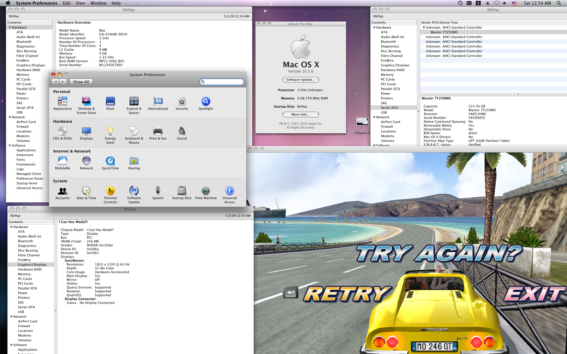

netcastle Posted April 28, 2009 Share Posted April 28, 2009 I see - according to this test I have the shared memory issue after all, though other than this test, I haven't seen any evidence of the problem. Regular computing doesn't seem to be affected by the memory issue this board has, but when you start dealing with larger files the results can be pretty frustrating. Did your screen snow when you ran the memtest? What kexts are you using? With my setup I end up with snow when running onboard video with 4 gigs installed. It doesn't matter what kexts I use. But this is a board bought back in December. I can't believe this board is so popular. Who would have thought back in Decemeber that this discussion would be this persistent. Link to comment https://www.insanelymac.com/forum/topic/136510-gigabytes-nvidia-9400-powered-m-atx-mobo/page/24/#findComment-1143356 Share on other sites More sharing options...

leppy700m Posted April 29, 2009 Share Posted April 29, 2009 I think it works pretty well for not working. I have confirmed that I in fact do have the onboard video/memory issue with 'noob's memory test, and sleep is broken. Link to comment https://www.insanelymac.com/forum/topic/136510-gigabytes-nvidia-9400-powered-m-atx-mobo/page/24/#findComment-1144799 Share on other sites More sharing options...

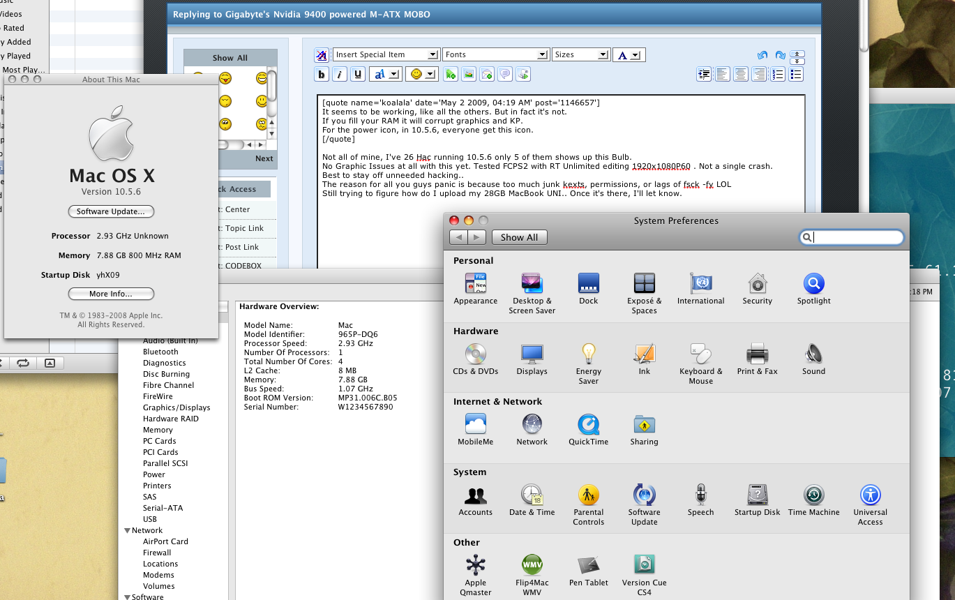

OSO Posted May 2, 2009 Share Posted May 2, 2009 It seems to be working, like all the others. But in fact it's not.If you fill your RAM it will corrupt graphics and KP. For the power icon, in 10.5.6, everyone get this icon. Not all of mine, I've 26 Hac running 10.5.6 only 5 of them shows up this Bulb. No Graphic Issues at all with this yet. Tested FCPS2 with RT Unlimited editing 1920x1080P60 . Not a single crash. Best to stay off unneeded hacking.. The reason for all you guys panic is because too much junk kexts, permissions, or lags of fsck -fy LOL Still trying to figure how do I upload my 28GB MacBook UNI.. Once it's there, I'll let know. Link to comment https://www.insanelymac.com/forum/topic/136510-gigabytes-nvidia-9400-powered-m-atx-mobo/page/24/#findComment-1146975 Share on other sites More sharing options...
chrilled Posted May 3, 2009 Share Posted May 3, 2009 Not all of mine, I've 26 Hac running 10.5.6 only 5 of them shows up this Bulb.No Graphic Issues at all with this yet. Tested FCPS2 with RT Unlimited editing 1920x1080P60 . Not a single crash. Best to stay off unneeded hacking.. The reason for all you guys panic is because too much junk kexts, permissions, or lags of fsck -fy LOL Still trying to figure how do I upload my 28GB MacBook UNI.. Once it's there, I'll let know. yhX. Congrats to your working system. Could you try to -for example- zip a folder containing two 900 meg files or similar. After that try mrosxnoobs mem test that was posted here a few weeks ago. If your system doesn't "snow" on any of them you don't have the problem. I'm really curious about your success. Link to comment https://www.insanelymac.com/forum/topic/136510-gigabytes-nvidia-9400-powered-m-atx-mobo/page/24/#findComment-1147284 Share on other sites More sharing options...
