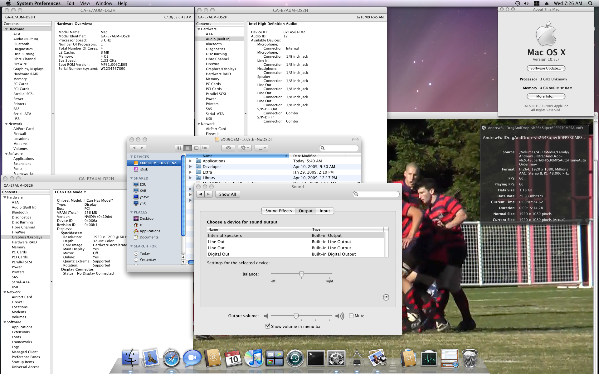

dlach Posted June 6, 2009 Share Posted June 6, 2009 EFI v8 Patched a Clean 10.5.6 disk original from my MacBook (Aluminum Unibody)Dropped NVkush, AppleSMBIOSEFI, OpenHaltRestart, IntelCPUPMDisabler, HDA889a 10.5.6 fix(HDAEnabler & AppleHDA) into /S*/L*/E*/ Done! QE CI Audio LAN works out of original files. NO DSDT!!!!! Remember Don't Need to waste your time to update, patching anything extra.. i.e. DSDT!!!! BIOS!!!! LOL This one goes out to yhX. LOL! Yeah no need to waste your time patching, no DSDT, just waste your time applying Nvkush and IntelCPUPMdisabler, HDAEnabler kext *instead*, it takes *so* much effort. LOL! What a joke! LOL! And what do the poor sods without a "clean original disk" from your Macbook pro do? Nothing? LOL!! Ha! Ha! Ha! all of you guys doing retail install are such idiots! LOL! Sheesh. Link to comment https://www.insanelymac.com/forum/topic/136510-gigabytes-nvidia-9400-powered-m-atx-mobo/page/25/#findComment-1170763 Share on other sites More sharing options...

OSO Posted June 9, 2009 Share Posted June 9, 2009 ...whatever you guys take it. **Updated** Lag video fix rm -rf /S/L/E/AppleUpstreamUserClient.kext GA-E7AUM-DS2H Hac Kext Pack With Missing Audio Kext** I just want to help whomever couldn't figure out how to get it to work without the ORI MBK UNI 10.5.6/7 DISC Whomever don't have the Original 10.5.6/7 DISC for MacBook Unibody, just upgrade your own working Hac all the way to 10.5.7 from another Hac that had most Original files and it will be the same thing as soon as you've got it showing 10.5.7. Still as what I've said, no dSTD and BIOS Flash/Hack needed (Do it only if you like to have lower than 2GB Memory Detected). You don't need any other drivers too, so don't waste time to hack/edit your kext info.plist for the one you're starting from scratch. For fastest result, just download the Leo.5.7 Combo Update and do the update rules for Hac, This way you'll have as much kexts as those mbk uni. I'll just post you some kext I've used. These are the only kexts I've add to this NVMB Hac. **FOLLOWING IS WHAT I'VE TRIED FOR MY FRIENDS x3** No DSDT & BIOS Hack!! 1, A working 10.5.7 Leopard on a HD/SSD with as much Original Files as possible + EFIv8/9 + Posted Kexts. 2, Plug it to your NVMB 3, Fire it Up,Press F8 then -v -f -s 4, fsck -fy 5, mount -uw / 6, rm -rf /System/Library/Extensions/AppleUpstreamUserClient.kext (Know issue for all NV 9xxx, 2xx ) 7, rm /System/Library/Extensions.* 8, reboot Take it easy... and Remember to Thanks for those who made these kext I really have no juice to upload the whole DMG of mine and don't know anything legal or not to do such thing. I don't even know this post is still here as I saw it crossed out. I'll swing back and see if I get anyone mad again~* GA_E7AUM_DS2H_Hac_Kexts.zip Link to comment https://www.insanelymac.com/forum/topic/136510-gigabytes-nvidia-9400-powered-m-atx-mobo/page/25/#findComment-1173155 Share on other sites More sharing options...

chrilled Posted June 10, 2009 Share Posted June 10, 2009 ...whatever you guys take it.**Updated GA-E7AUM-DS2H Hac Kext Pack With Missing Audio Kext** (snipp) I'll just post you some kext I've used. These are the only kexts I've add to this NVMB Hac. Hi yhX. Have you tried the memtest or anything else? Could you do me a favor and at least right-click the 700 meg combo 5.7 update and choose compress... It goes to about 400 meg before my screen garbles and the graphics is unresponsive.. This only happens with 4 gig+ ram.. /c Link to comment https://www.insanelymac.com/forum/topic/136510-gigabytes-nvidia-9400-powered-m-atx-mobo/page/25/#findComment-1174637 Share on other sites More sharing options...
dlach Posted June 11, 2009 Share Posted June 11, 2009 ...whatever you guys take it.**Updated GA-E7AUM-DS2H Hac Kext Pack With Missing Audio Kext** I just want to help whomever couldn't figure out how to get it to work without the ORI MBK UNI 10.5.6/7 DISC Whomever don't have the Original 10.5.6/7 DISC for MacBook Unibody, just upgrade your own working Hac all the way to 10.5.7 from another Hac that had most Original files and it will be the same thing as soon as you've got it showing 10.5.7. Still as what I've said, no dSTD and BIOS Flash/Hack needed (Do it only if you like to have lower than 2GB Memory Detected). You don't need any other drivers too, so don't waste time to hack/edit your kext info.plist for the one you're starting from scratch. For fastest result, just download the Leo.5.7 Combo Update and do the update rules for Hac, This way you'll have as much kexts as those mbk uni. I'll just post you some kext I've used. These are the only kexts I've add to this NVMB Hac. **FOLLOWING IS WHAT I'VE TRIED FOR MY FRIENDS x3** No DSDT & BIOS Hack!! 1, A working 10.5.7 Leopard on a HD/SSD with as much Original Files as possible + EFIv8/9 + Posted Kexts. 2, Plug it to your NVMB 3, Fire it Up,Press F8 then -v -f -s 4, fsck -fy 5, mount -uw / 6, rm /System/Library/Extensions.* 5, reboot Take it easy... and Remember to Thanks for those who made these kext I really have no juice to upload the whole DMG of mine and don't know anything legal or not to do such thing. I don't even know this post is still here as I saw it crossed out. I'll swing back and see if I get anyone mad again~* "Still as what I've said, no dSTD and BIOS Flash/Hack needed (Do it only if you like to have lower than 2GB Memory Detected). You don't need any other drivers too, so don't waste time to hack/edit your kext info.plist for the one you're starting from scratch." Anybody thinking of following this advice would do well to spend some time reading through this topic. There is no evidence that this approach will get >2GB working, and in fact there is plenty of evidence to the contrary. yhX should at least run the memory test on that installation as well as his MBP recovery disk method before boasting that it really gets you >2GB. The memory limitation problem does not appear evident initially. If the mem test runs successfully under either method I think I won't be the only who is quite surprised. But hey, whatever. It is your time, use it however you want and if either method actually does get you >2GB really working, I'll happily try to figure out why and get the fix into the retail install guide. Link to comment https://www.insanelymac.com/forum/topic/136510-gigabytes-nvidia-9400-powered-m-atx-mobo/page/25/#findComment-1174722 Share on other sites More sharing options...
OSO Posted June 11, 2009 Share Posted June 11, 2009 Hi yhX. Have you tried the memtest or anything else? Could you do me a favor and at least right-click the 700 meg combo 5.7 update and choose compress... It goes to about 400 meg before my screen garbles and the graphics is unresponsive.. This only happens with 4 gig+ ram.. /c Yo Chrilled, Thanks for your check point. The result was same as yours. I'll try to play with it and see if anything can help solving it. I think I'll try to dump its rom into string to get exact INFO of it via the BIOS dump. Thing I've already tried as follow. 1, DSDT 2, NVkush (Work out great. Less performance compare to NVdarwin tho **100+ CB less**) 3, EFI GFX String Only NVRasman work 4, NVdarwin (Best Result overall, up to 500MB+...but well) 5, BIOS dump to string via windows (Not Yet Done) I'll try to keep on to this... when I'm refilled. Link to comment https://www.insanelymac.com/forum/topic/136510-gigabytes-nvidia-9400-powered-m-atx-mobo/page/25/#findComment-1174840 Share on other sites More sharing options...
dlach Posted June 11, 2009 Share Posted June 11, 2009 Yo Chrilled, Thanks for your check point. The result was same as yours. I'll try to play with it and see if anything can help solving it. I think I'll try to dump its rom into string to get exact INFO of it via the BIOS dump. Thing I've already tried as follow. 1, DSDT 2, NVkush (Work out great. Less performance compare to NVdarwin tho **100+ CB less**) 3, EFI GFX String Only NVRasman work 4, NVdarwin (Best Result overall, up to 500MB+...but well) 5, BIOS dump to string via windows (Not Yet Done) I'll try to keep on to this... when I'm refilled. OK so al least we're all clear now. yhX's methods do not solve the >2GB memory problem. yhX you should go back and edit your post so that people are not mislead. Signal64 et al indicated that the memory limitation is a problem of the BIOS having an incorrect memory map in the SSDT. So we're either going to need a BIOS update (unlikely) or try to patch the SSDT. One way to do this is apparently using the new Chameleon bootloader with SSDT and DSDT override HERE. Link to comment https://www.insanelymac.com/forum/topic/136510-gigabytes-nvidia-9400-powered-m-atx-mobo/page/25/#findComment-1175199 Share on other sites More sharing options...
