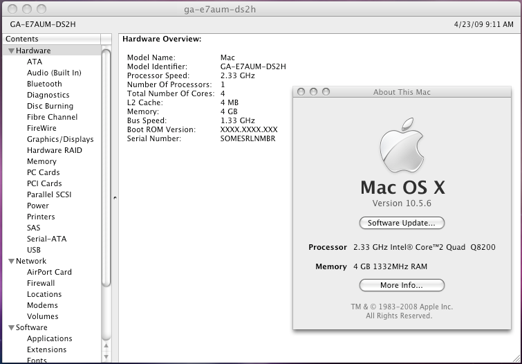

guibzh Posted April 22, 2009 Share Posted April 22, 2009 Thank you. I got everything in profiler working except when I drill down to the memory page - it says "There was an error while gathering this information". I think I am really liking this board. I stuck a Q8200 CPU with a stock fan in it, 4 GB of cheap GSKILL memory, a 1 TB western digital SATA hard drive and LG SATA DVD burner. Relatively cheap machine that played nice with IPC from the very first boot. Very very nice. I've heard some of you guys looking for the ethernet kext, but it's right in the IPC distro. Just pick Realtek (There was only one Realtek option for all of their LAN chips) during the intall. Even though the lan chipset isn't listed, it worked for me OOB with no fuss and no muss. Thank you for your feedbacks. Could you please give us the kernel, drivers and fixes you selected during iPC installation? By the way, which version of iPC did you use? Is it iPC 10.5.6 PFF5? Link to comment https://www.insanelymac.com/forum/topic/136510-gigabytes-nvidia-9400-powered-m-atx-mobo/page/23/#findComment-1139244 Share on other sites More sharing options...

leppy700m Posted April 23, 2009 Share Posted April 23, 2009 It's a beautiful thing.... Link to comment https://www.insanelymac.com/forum/topic/136510-gigabytes-nvidia-9400-powered-m-atx-mobo/page/23/#findComment-1140095 Share on other sites More sharing options...
