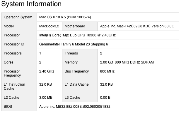

BlackCH Posted November 12, 2010 Author Share Posted November 12, 2010 Hey guys/girls, I've done a CPU upgrade on my HP 6720s. Now it runs a T8300 instead of the T7250 that was originally shipped with. Im really happy about the upgrade. Not so much for the extra processing power (eventhough the machine runs snappier) but for the temperatures; almost 20° less than before and that means much more quiet fan. I've put some pictures in my blog if you are interested. Now I've also undervolted it via DSDT so the tempeartures are even better: idle at 33-35°, full load 55,60°. I guess another factor for the better temps is the fact that I cleaned the heatsink so the air can flow better and also replace the pathetic thermal clay HP used with Artric Silver 5. If you want to try this on your own dont hesitate to contact me for details. Cheerz Link to comment https://www.insanelymac.com/forum/topic/135410-hp-6520s-6720s-6820s-550-sl-install-package/page/26/#findComment-1581701 Share on other sites More sharing options...

BlackCH Posted November 19, 2010 Author Share Posted November 19, 2010 Anyways, BlackCH have you already changed your wifi card? If so how's it working && which steps did you do? The wifi card has not arrived yet (bummer!). What did arrive is a new CPU (t8300) Im running now. Works great, Im really happy about the upgrade   I would like to get deep-sleep (hibernation) to work. Anyone has tryied on this machine? Link to comment https://www.insanelymac.com/forum/topic/135410-hp-6520s-6720s-6820s-550-sl-install-package/page/26/#findComment-1587351 Share on other sites More sharing options...
