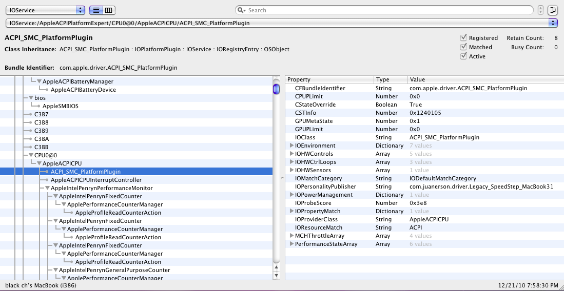

juanerson Posted December 17, 2010 Share Posted December 17, 2010 Some captures HERE and HERE of native SpeedStep activated (for sure) again. CoolBook is showing correctly the information, because the last DSDT I posted is STANDARD, I mean keeping default CPU section, to allow each own (particular) factory CPU states from SSDT Tables. Link to comment https://www.insanelymac.com/forum/topic/135410-hp-6520s-6720s-6820s-550-sl-install-package/page/30/#findComment-1603781 Share on other sites More sharing options...

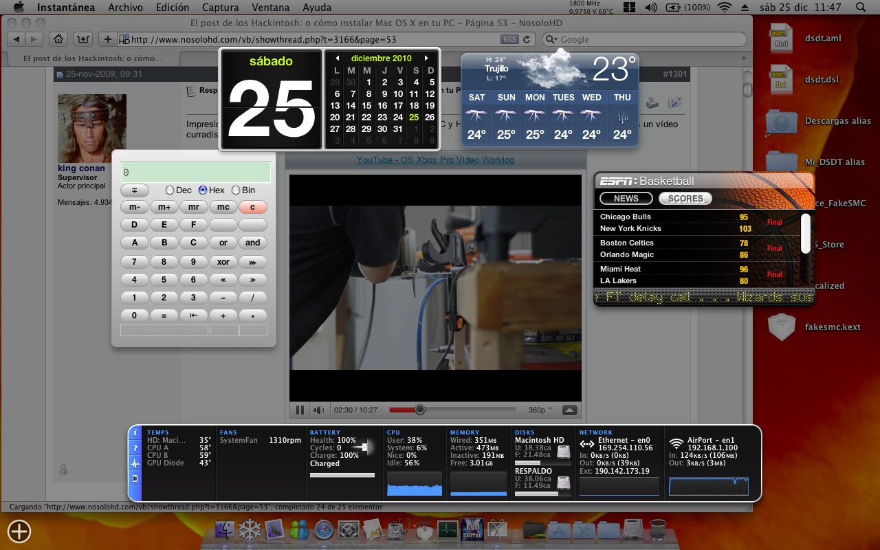

BlackCH Posted December 23, 2010 Author Share Posted December 23, 2010 Fan readings on HP6720s (with Mozodojo/Slide FakeSMC & FakeSMCACPIMonitor plugin) DSDT edit: add this code to the EC device: OperationRegion (ECOR, EmbeddedControl, Zero, 0xFF) Field (ECOR, ByteAcc, NoLock, Preserve) { Offset (0xD7), FAN1, 8 } Then add this code for the ACPIMonitor (just before Device (PDRC)) : Device (SPIO) { Name (_HID, EisaId ("PNP0C02")) Name (_CID, "monitor") Name (_STA, 0x0F) Method (SMC0, 0, NotSerialized) //System FAN0 { Store (\_SB.PCI0.LPCB.EC.FAN1, Local1) Xor (Local1, 0xFF, Local0) Multiply(Local0, 2, Local0) Return (Local0) } } Then you need to install the FakeSMC.kext 2.7.2 on /S/L/E (newer versions works also from /E/E/). Be carefull to remove any other version you might be using. You need the following plugins inside the kext´s plugin folder: FakeSMCACPIMonitor.kext (fan), FakeSMCIntelMonitor.kext (cpu temp/volt), FakeSMCx3100plugin.kext (gpu temp) When I identified the register holding fan rotation percentuals in the EC device (offset D7), I could write to this register to set the fan speed (with RW tool, under windows), so I guess it might be possible to add manual fan control too. The RPM values are not acurated. I need to know the fan full speed in order to calculate the rest of the speeds, as the register holds speed percentual and not actual RPM. For now the value goes up and down following the fan, and should be proportional to the real fan speed; thats good enough to start with Link to comment https://www.insanelymac.com/forum/topic/135410-hp-6520s-6720s-6820s-550-sl-install-package/page/30/#findComment-1607593 Share on other sites More sharing options...

juanerson Posted December 26, 2010 Share Posted December 26, 2010 Fan readings on HP6720s Black, please sorry for the late report, but today Im been testing it with some adjust to DSDT trying to keep the most original code in Device EC to obtain the same results about automatic fan readings, at least I think should works for all of us, because from your point of start (thanks) is working here using istat pro widget... So, now I can say this really looks great my friend! Thank you very much. P.D. Si te parece bien podemos intercambiar experiencias por msn, ya que obtengo lecturas suficientemente consistentes, distinto a lo que comentas aquí si te entiendo bien, es decir, en mi caso los porcentajes se corresponden (en concordancia) con las revoluciones. Tal vez estoy equivocado o no entienda tu punto, pero es lo que muestra el widget de Istat Pro, puedo ver como suben las rpm a medida que sube la velocidad del ventilador. Espero tu respuesta, Feliz Navidad y Saludos. In the screenshot, second Fan Speed 65% from 61C until it reaches 70C (1310 rpm), while the reading 1010 rpm is the initial activated (in theory) speed from 45-50C, and the minimal (I think) factory speed reported in my case is 10 rpm (almost OFF below 45C). About top speed (not 100% of F.S.) was 1610 rpm at 72C during intensive CPU test (20 mins - both cores), and never it reaches 80C. So, I think logically the maximum fan speed (100%) maybe is 1010 x 2 = 2020 rpm, but I don't know. Important note of clarifying: All the readings were taken loading default fan speed settings from DSDT v0.20 according to this. Link to comment https://www.insanelymac.com/forum/topic/135410-hp-6520s-6720s-6820s-550-sl-install-package/page/30/#findComment-1608947 Share on other sites More sharing options...
