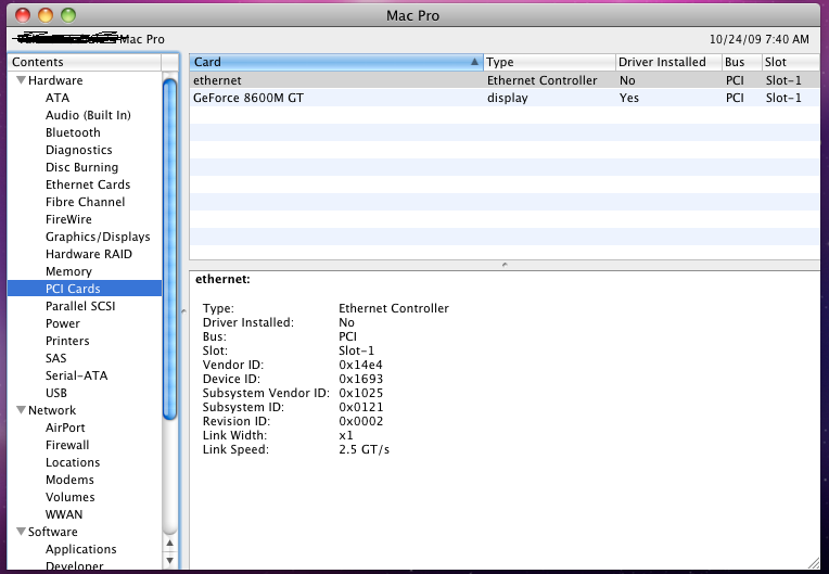

icecups Posted October 24, 2009 Share Posted October 24, 2009 Hey guys, I've installed Snow Leopard based on the how-to of Lifehacker. The installation went fine, but now I have a problem with my ethernet adapter. It doesn't appear under "networks". Does anyone know how i can install the drivers or where i get the drivers? Does the ethernet only work with a working wifi card? I tried it with the "ethernet drivers" from Vood, but they didnt work. Thanks and regards, PS: sry for my bad english Link to comment https://www.insanelymac.com/forum/topic/134310-acer-5920g-leopard-1055-vanilla-retail-guide-20/page/16/#findComment-1308938 Share on other sites More sharing options...

jvloendersloot Posted November 8, 2009 Share Posted November 8, 2009 Hey guys, I've installed Snow Leopard based on the how-to of Lifehacker. The installation went fine, but now I have a problem with my ethernet adapter. It doesn't appear under "networks". Does anyone know how i can install the drivers or where i get the drivers? Does the ethernet only work with a working wifi card? I tried it with the "ethernet drivers" from Vood, but they didnt work. Thanks and regards, PS: sry for my bad english I have the same problems. Patched my own dsdt.aml under linux, cmos fix , AZAL to HDEF etc. Chameleon 2.0RC3 and PC_Efi 10.5 for the video. Still haven't got my ethernet working. I'm using a Zydas for now, but want my Broadcom working. Anybody a solution? Link to comment https://www.insanelymac.com/forum/topic/134310-acer-5920g-leopard-1055-vanilla-retail-guide-20/page/16/#findComment-1323528 Share on other sites More sharing options...
