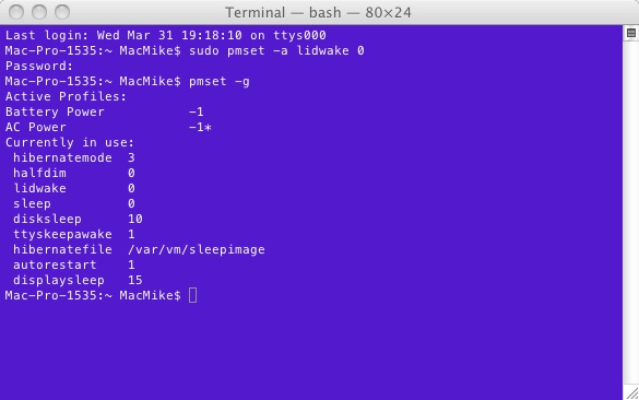

bluedogmike Posted March 5, 2010 Share Posted March 5, 2010 I know this is an old thread, but has anyone been able to achieve sleep while running Leopard or Snow Leopard on this model. (with 3100 graphics) If so please share your experience, it would be greatly appreciated. Well to answer my own question here it is. I was able to enable sleep by tweaking my dsdt.aml file. It has a powerbutton fix and speedstepping (p-states) . Sleep is working well and wakes via powerbutton. Sleep on lid close is working. *Sleep only works while plugged in to ac (10.5.8), Works on battery also on 10.6.1..... Find attached the dsdt.aml file. Working on 10.5.8, also works with Snow Leo 10.6.1 You MUST set your lidwake to 0 for this fix to work at all. Attached is a shot of the terminal with the proper commands dsdt.aml.zip Link to comment https://www.insanelymac.com/forum/topic/133702-leo4allv3-dell-studio-graphics-and-wifi/page/9/#findComment-1423612 Share on other sites More sharing options...

bluedogmike Posted June 2, 2010 Share Posted June 2, 2010 did you try it under 10.6.3 ? ... did you know its working with dell studio 1737 ? Are you talking about my dsdt.aml? If so thats even better, haven't even tried on 10.6.2, don't know about 10.6.3 either. Link to comment https://www.insanelymac.com/forum/topic/133702-leo4allv3-dell-studio-graphics-and-wifi/page/9/#findComment-1480854 Share on other sites More sharing options...
