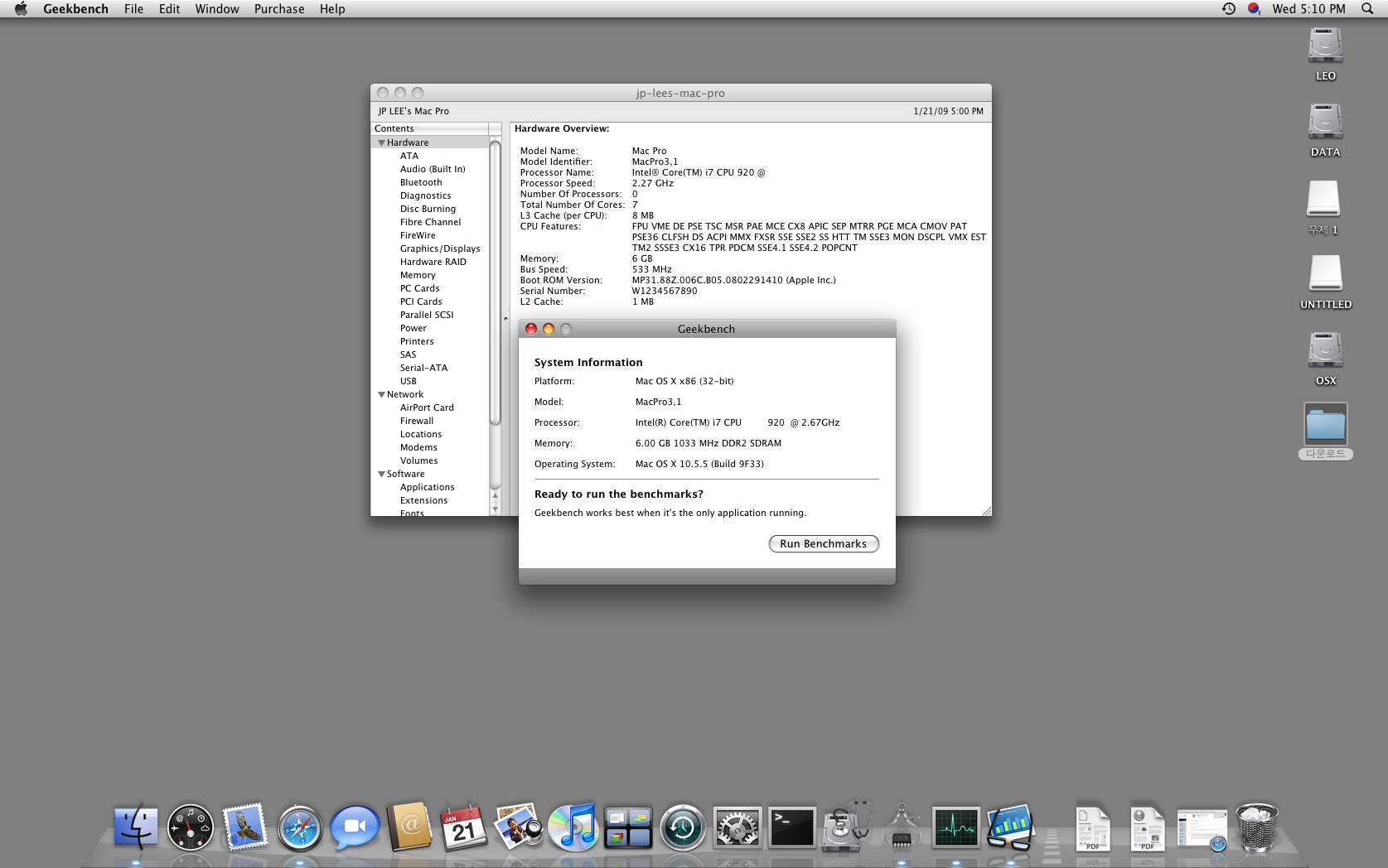

JaE-V Posted January 22, 2009 Share Posted January 22, 2009 Hey guys, i'm fully up and running with the 9.6.0 kernel with 10.5.6. But only a few things are giving me issues. My machine in the system profiler is detected as a macbook pro, i hate that...if anyone can help me out with that i'd appreciate it. Then, it only shows one of my cores in the system profiler correctly. Its says "number of processors: 1, number of cores: 4". All of my cores are turned on in my bios with HT enabled of course. However i just ran geekbench and it said "number of processors: 0, active cores: 8. I'm completely lost, activity monitor is showing one core active. Also what does the busratio=20 do? Its in my boot.plist, just dont quite understand it. Memory is detected as ddr2. Could all of these issues be related to the smbios? Geekbench score was still at a thousand. So, you are up and running, eh? EVGA? Nice board from what I've seen. Of course, this would be for later, but I enjoyed looking through this thread: EVGA X58 Overclocking Guide. Does it have the core activation issue that ASUS has? I have a hard time getting technical information on EVGA's boards. Their website has nothing! The only info I have (from peering at the WIN drivers) is that the X58 board has the Realtek chips for LAN (8169, 8168, or 8101E?) and audio (HDAHP880?). What info do you have? Does the info show up in the Profiler? Glad you're up and running after all that. regards, MAJ Yea, it has a ton of overclocking features, i basically just turned on the dummy OC switch and it automatically clocked the processor at 3.2 which is what i wanted, my temps are about 27 idle and right at 39 under load with the coolermaster, its an awesome fan. I'm not sure on the LAN, but i know its either 8169 or 8168, worked OTB. Audio is the 889 i believe, havent played with it yet because i use an adapter. Link to comment https://www.insanelymac.com/forum/topic/132960-upcoming-intel-x58-mobos-core-i7-cpus/page/29/#findComment-1051756 Share on other sites More sharing options...
Craig4 Posted January 22, 2009 Share Posted January 22, 2009 Hey guys, i'm fully up and running with the 9.6.0 kernel with 10.5.6. But only a few things are giving me issues. My machine in the system profiler is detected as a macbook pro, i hate that...if anyone can help me out with that i'd appreciate it. Then, it only shows one of my cores in the system profiler correctly. Its says "number of processors: 1, number of cores: 4". All of my cores are turned on in my bios with HT enabled of course. However i just ran geekbench and it said "number of processors: 0, active cores: 8. I'm completely lost, activity monitor is showing one core active. Also what does the busratio=20 do? Its in my boot.plist, just dont quite understand it. Memory is detected as ddr2. Could all of these issues be related to the smbios? Geekbench score was still at a thousand. Yea, it has a ton of overclocking features, i basically just turned on the dummy OC switch and it automatically clocked the processor at 3.2 which is what i wanted, my temps are about 27 idle and right at 39 under load with the coolermaster, its an awesome fan. I'm not sure on the LAN, but i know its either 8169 or 8168, worked OTB. Audio is the 889 i believe, havent played with it yet because i use an adapter. If geekbench is showing 8 cores then you should be fine. Busratio=20 is for the i7 920 to run the voodoo kernel, it is needed to boot. I am guessing the smbios is the reason you are seeing the computer as a mcbook pro. Your geekbench seems pretty low if it is only in the thousands. Mine is 10,250 or so when oc'd to 3ghz and using 64bit edit: to anyone that understands this here is the code I got when trying to run the single player of cod4, the multiplayer works tho.. Exception Type: EXC_BAD_ACCESS (SIGBUS) Exception Codes: KERN_PROTECTION_FAILURE at 0x0000000000000001 Crashed Thread: 0 Thread 0 Crashed: 0 ??? 0x0001e4a1 0 + 124065 1 ??? 0x01e32929 0 + 31664425 2 dyld 0x8fe11966 ImageLoaderMachO::doModInitFunctions(ImageLoader::LinkContext const&) + 246 3 dyld 0x8fe0d983 ImageLoader::recursiveInitialization(ImageLoader::LinkContext const&, unsigned int) + 307 4 dyld 0x8fe0da69 ImageLoader::runInitializers(ImageLoader::LinkContext const&) + 57 5 dyld 0x8fe03df2 dyld::initializeMainExecutable() + 130 6 dyld 0x8fe0720d dyld::_main(mach_header const*, unsigned long, int, char const**, char const**, char const**) + 2173 7 dyld 0x8fe01872 dyldbootstrap::start(mach_header const*, int, char const**, long) + 818 8 dyld 0x8fe01037 _dyld_start + 39 (dyldStartup.s:112) Thread 0 crashed with X86 Thread State (32-bit): eax: 0x0001e4a1 ebx: 0x01e3311a ecx: 0x00000000 edx: 0x0001e39f edi: 0x00000001 esi: 0x000013f4 ebp: 0xbffff268 esp: 0xbffff23c ss: 0x0000001f efl: 0x00010246 eip: 0x0001e4a1 cs: 0x00000017 ds: 0x0000001f es: 0x0000001f fs: 0x00000000 gs: 0x00000037 cr2: 0x00000001 Binary Images: 0x8fe00000 - 0x8fe298a3 dyld 0.0 (???) <d1092af4e89e77aa121dd5fb0c855cd9> /usr/lib/dyld Link to comment https://www.insanelymac.com/forum/topic/132960-upcoming-intel-x58-mobos-core-i7-cpus/page/29/#findComment-1051869 Share on other sites More sharing options...

jplee4907 Posted January 22, 2009 Share Posted January 22, 2009 Hey guys, i'm fully up and running with the 9.6.0 kernel with 10.5.6. But only a few things are giving me issues. My machine in the system profiler is detected as a macbook pro, i hate that...if anyone can help me out with that i'd appreciate it. Then, it only shows one of my cores in the system profiler correctly. Its says "number of processors: 1, number of cores: 4". All of my cores are turned on in my bios with HT enabled of course. However i just ran geekbench and it said "number of processors: 0, active cores: 8. I'm completely lost, activity monitor is showing one core active. Also what does the busratio=20 do? Its in my boot.plist, just dont quite understand it. Memory is detected as ddr2. Could all of these issues be related to the smbios? Geekbench score was still at a thousand. Yea, it has a ton of overclocking features, i basically just turned on the dummy OC switch and it automatically clocked the processor at 3.2 which is what i wanted, my temps are about 27 idle and right at 39 under load with the coolermaster, its an awesome fan. I'm not sure on the LAN, but i know its either 8169 or 8168, worked OTB. Audio is the 889 i believe, havent played with it yet because i use an adapter. Conglaturation and good news for me! Could you give us more detail of how you installed? Currently I'm using iATKOS 10.5.5 with 9.5.0 fassle kernel. But the system starts really slow. I was wondering you were able to install 10.5.6 with 9.6.0 kernel, it must be voodoo kernel, right? Then, how your system starts without without bootflag "busratio=20'...when you have time, let us know. I think the lan is RealTek 8111C, the sound is ATL889a for EVGA X58. The temp is really good. I have a stock cooler, my idle temp is 47-51, that I think really high. I'm waiting my Xigmatek cooler now. Thanks Link to comment https://www.insanelymac.com/forum/topic/132960-upcoming-intel-x58-mobos-core-i7-cpus/page/29/#findComment-1052171 Share on other sites More sharing options...
