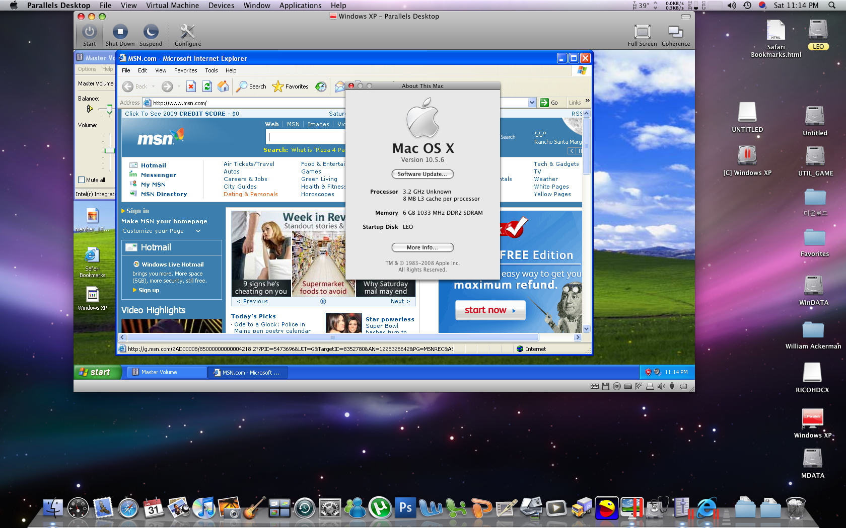

jplee4907 Posted February 1, 2009 Share Posted February 1, 2009 Parallels 4 With EVGA X58 working! Hi guys I'm sure how VM or Parallels are working on GA EX58 series. But I just successfully installed Parallels 4 in my EVGA EX58 system and it's working perfect. With this board and ATI HD3870, I was able to install OSX 10.5.6 by following Digital Dreamer's guide, exactly the same way for GA EX58-UD5. The system is set perfect except Audio. That's Ok, I got a USB sound card. Just today, I just tried Parallels install knowing I'd get KP in doing so. In the beginning, the installation didn't go further because of Virtualization not on. I went back to Bios. As I checked, under the CPU feature, Virtual Function was disabled, so changed it to enable then Parallels just installed as it should be. This is great! Now I got everything working for my need, I'm happy with EVAG X58! Thanks guys. Link to comment https://www.insanelymac.com/forum/topic/132960-upcoming-intel-x58-mobos-core-i7-cpus/page/32/#findComment-1064356 Share on other sites More sharing options...

JaE-V Posted February 1, 2009 Share Posted February 1, 2009 Parallels 4 With EVGA X58 working! Hi guys I'm sure how VM or Parallels are working on GA EX58 series. But I just successfully installed Parallels 4 in my EVGA EX58 system and it's working perfect. With this board and ATI HD3870, I was able to install OSX 10.5.6 by following Digital Dreamer's guide, exactly the same way for GA EX58-UD5. The system is set perfect except Audio. That's Ok, I got a USB sound card. Just today, I just tried Parallels install knowing I'd get KP in doing so. In the beginning, the installation didn't go further because of Virtualization not on. I went back to Bios. As I checked, under the CPU feature, Virtual Function was disabled, so changed it to enable then Parallels just installed as it should be. This is great! Now I got everything working for my need, I'm happy with EVAG X58! Thanks guys. Sweet, me and you are in the same boat! Got my system up and running perfectly, i'm using an audio adapter too lol. Havent dived into audio yet. Everything works great. I believe my virtualization is on. Link to comment https://www.insanelymac.com/forum/topic/132960-upcoming-intel-x58-mobos-core-i7-cpus/page/32/#findComment-1064984 Share on other sites More sharing options...
jplee4907 Posted February 1, 2009 Share Posted February 1, 2009 Sweet, me and you are in the same boat! Got my system up and running perfectly, i'm using an audio adapter too lol. Havent dived into audio yet. Everything works great. I believe my virtualization is on. Just for your information, one of my friend got Foxconn Blood Rage Mobo and he was able to install exactly the same way I did by following DD's guide (not wolfienukes) It's strange why the Wolfienuke's guide is not working since they use almost the same kext files. Well I'm a noobo, no way to know why! :-) He told me the system runs perfect except Audio! Foxconn uses the same ALC889a chip with a little variation. The Audio will be a homework to work on. Also, There's saying EVGA X58/Foxconn X58 is based on the same design as Lan Party DK X58 board. So, maybe someone with the LanParty board may be able to install soon. I guess we can confirm that DD's install guide works for GA EX58 series, EVGA X58, and Foxconn X58 Blood Rage! Happy Hackin! Waiting for "Snow" Link to comment https://www.insanelymac.com/forum/topic/132960-upcoming-intel-x58-mobos-core-i7-cpus/page/32/#findComment-1065051 Share on other sites More sharing options...
digital_dreamer Posted February 2, 2009 Share Posted February 2, 2009 Parallels 4 With EVGA X58 working! Unbelievable! You're the second person with virtualization working. Someone else had it running, but don't remember what board it was. Where's my envy emoticon when I need it? thinking of getting this. wht do you think? or this one, not gigabit but my router isnt anyway.... I think you got the right thing in mind to resolve your on-board LAN troubles. That Apple USB adapter will work OTB, obviously. One of the reviewers says it's got decent bandwidth for a USB adapter - 11MB/s - that's right up there for Fast Ethernet. I prefer PCIe, but don't know about that particular one. It's got the 82572GI chipset. Would that work OTB? I see Apple's stuff includes 8254X and 8255X. I know they have a Intel PRO/100 VE NIC and Intel 82566mm working. May just need a device ID change to 0x10b9. if it doesn't work OTB. I'm still trying to get the ALC888 Audio working on Gigabyte's EX58-DS4 - Digital_dreamer, do you think it might be possible to modify the relevant files in your EX58-UD5 package? It looks to me like the files n question are: AppleHDA.kext HDAEnabler.kext I am willing to explore this possibility, but I thought I would ask you first for your opinion, based with your experience with the ALC889 on the UD5. thanks bgd Yes, that's definitely an area we can work on. I have some threads I can point you to. Give me a minute. EDIT: Have you tried this ALC888? There are three folders in the zip. Try the "HDA_888_v0.2" first and let us know. regards, MAJ Link to comment https://www.insanelymac.com/forum/topic/132960-upcoming-intel-x58-mobos-core-i7-cpus/page/32/#findComment-1065530 Share on other sites More sharing options...
jplee4907 Posted February 2, 2009 Share Posted February 2, 2009 Unbelievable! You're the second person with virtualization working. Someone else had it running, but don't remember what board it was. Where's my envy emoticon when I need it?I think you got the right thing in mind to resolve your on-board LAN troubles. That Apple USB adapter will work OTB, obviously. One of the reviewers says it's got decent bandwidth for a USB adapter - 11MB/s - that's right up there for Fast Ethernet. I prefer PCIe, but don't know about that particular one. It's got the 82572GI chipset. Would that work OTB? I see Apple's stuff includes 8254X and 8255X. I know they have a Intel PRO/100 VE NIC and Intel 82566mm working. May just need a device ID change to 0x10b9. if it doesn't work OTB. Yes, that's definitely an area we can work on. I have some threads I can point you to. Give me a minute. regards, MAJ Thanks to you, DD! Link to comment https://www.insanelymac.com/forum/topic/132960-upcoming-intel-x58-mobos-core-i7-cpus/page/32/#findComment-1065536 Share on other sites More sharing options...
mattrb Posted February 2, 2009 Share Posted February 2, 2009 Parallels works for me as well(iPC/Iatkos) but just not in Boot-132 EFI Boot. Link to comment https://www.insanelymac.com/forum/topic/132960-upcoming-intel-x58-mobos-core-i7-cpus/page/32/#findComment-1065563 Share on other sites More sharing options...

JaE-V Posted February 2, 2009 Share Posted February 2, 2009 Just confirming that parallels works great on the EVGA x58. Havent tried vmware yet Link to comment https://www.insanelymac.com/forum/topic/132960-upcoming-intel-x58-mobos-core-i7-cpus/page/32/#findComment-1065622 Share on other sites More sharing options...
