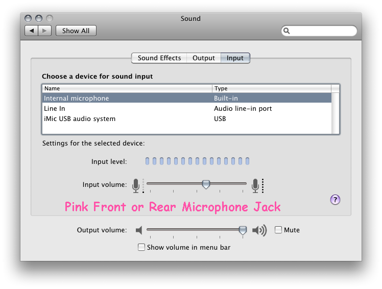

AlainTox714 Posted October 15, 2008 Author Share Posted October 15, 2008 I meant additional independent stereo outputs, like Line Out/Headphones (may be helpful in audio sequencing/mastering apps), not 5.1/7.1.Btw, about non-working rear mic - did you tested this pin sequense: 9-29-26-23-[14] (hope, you're understood)? Of course i test it and it's not working, as i told to someone: When i route Internal Microphone to rear Pink Jack, even if it show up in Sound pref and is selectable it doesn't work, no signal. Original Mac have a Microphone/Line Input at back which detects automaticly what is connected. So i have to choise between a Line Input or a Back Microphone which did not works. Link to comment Share on other sites More sharing options...

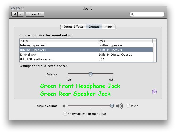

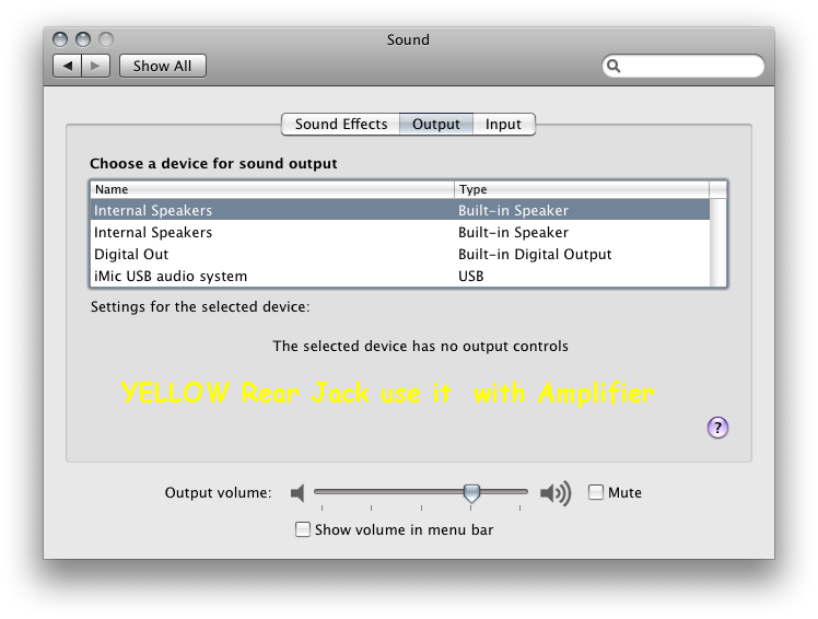

AlainTox714 Posted October 16, 2008 Author Share Posted October 16, 2008 Hi guys, some news I am abble today to get working: Green Rear Speaker Jack and Green Front Headphone with the same volume commande. Yellow Rear Line Out Jack with a separate volume commande no balance. Pink Front Microphone Jack OR Pink Rear Microphone Jack ONLY ONE, have to choise Rear or Front. Are you interested (what version Rear or Front)? Link to comment Share on other sites More sharing options...

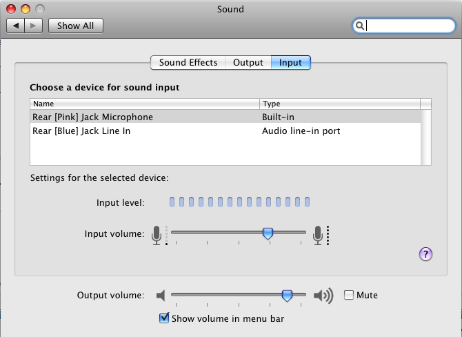

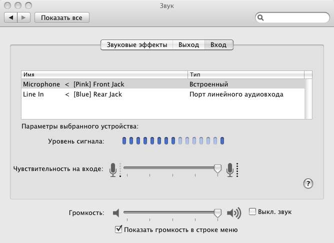

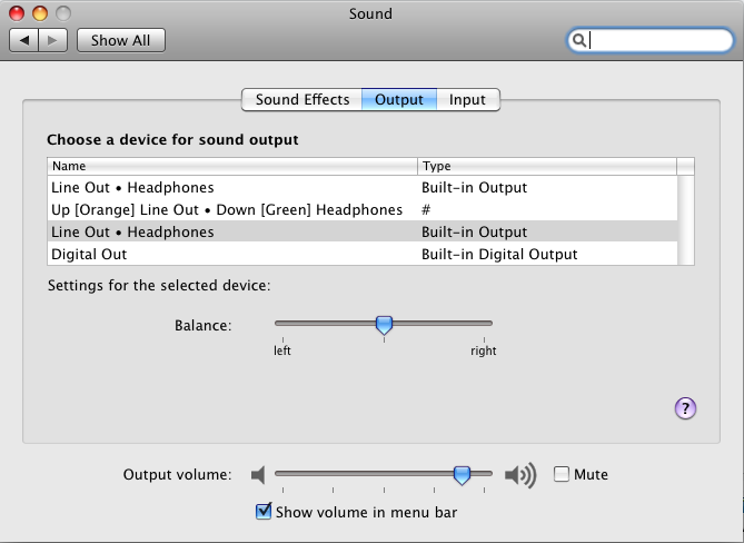

AlainTox714 Posted October 17, 2008 Author Share Posted October 17, 2008 Fully working v4 release Outputs : Line Out Rear Orange Jack, Headphones Rear and Front Green Jack, Digital Out*. Inputs : Microphone Rear Pink Jack, Line In Rear Blue Jack. Mute functionality working. * Digital Out not tested as i can't. This release is the closet to real Mac as you have Mic And Line Input at Rear and Heaphones at both Front and Rear DIFFERENT HDAEnabler.kext ************************************ REMOVE the old HDAEnabler.kext and use the new one Removed It's Buggy use v5 Link to comment Share on other sites More sharing options...

Leoopardoo Posted October 17, 2008 Share Posted October 17, 2008 At last !!! I've been waiting for this for ages... (more than one year ) Can't wait to test it. UPDATE: Well, mic is FULLY working ! I've just tested it with the SKYPE and YES, mic is working. Also, finally i have information about audio in my system profiler. So far have not tested digital out and 5.1 AlainTox714 - thank you very much - this was the last piece to resolve on BadAxeII mobo. Now I can say - I have 100% (literarily) working configuration. P.S.: next goal is to use efi strings also for the audio... Link to comment Share on other sites More sharing options...
AlainTox714 Posted October 17, 2008 Author Share Posted October 17, 2008 At last !!! I've been waiting for this for ages... (more than one year ) Can't wait to test it. UPDATE: Well, mic is FULLY working ! I've just tested it with the SKYPE and YES, mic is working Also, finally i have information about audio in my system profiler. So far have not tested digital out and 5.1 AlainTox714 - thank you very much - this was the last piece to resolve on BadAxeII mobo. Now I can say - I have 100% (hope so ) working config. Glad to read that. 5.1 is not working as Apple doesn't support it. Please report what kind of informations you get in SystemProfiler. If you can test Digital Ouput i will be very happy to have report as i can't test. Link to comment Share on other sites More sharing options...
Leoopardoo Posted October 17, 2008 Share Posted October 17, 2008 Glad to read that. 5.1 is not working as Apple doesn't support it. Please report what kind of informations you get in SystemProfiler. If you can test Digital Ouput i will be very happy to have report as i can't test. Thanx for info... Here are pics of my Sys. Profiler and Sound Settings: Link to comment Share on other sites More sharing options...
AlainTox714 Posted October 17, 2008 Author Share Posted October 17, 2008 Thanx for info... Here are pics of my Sys. Profiler and Sound Settings: Thanks works fine. Link to comment Share on other sites More sharing options...

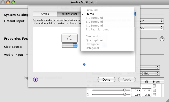

speedracer67 Posted October 17, 2008 Share Posted October 17, 2008 5.1 is not working as Apple doesn't support it. Thanks for all your hard work, Alain! The driver is working brilliantly on my Bad Axe 2. I'm not sure what you mean by the above statement, though, as OS X does indeed have 5.1 support. I have it working on another hackintosh right now with a different sound chipset. You enable it through the Audio Midi Setup utility in the Utilities folder by clicking 'configure speakers'. I hope you'll find a way to enable 5.1 or 7.1 audio in the future, but if not, your work is still very much appreciated! Link to comment Share on other sites More sharing options...
Leoopardoo Posted October 17, 2008 Share Posted October 17, 2008 Thanks for all your hard work, Alain! The driver is working brilliantly on my Bad Axe 2. I'm not sure what you mean by the above statement, though, as OS X does indeed have 5.1 support. I have it working on another hackintosh right now with a different sound chipset. You enable it through the Audio Midi Setup utility in the Utilities folder by clicking 'configure speakers'. I hope you'll find a way to enable 5.1 or 7.1 audio in the future, but if not, your work is still very much appreciated! Didn't know that... never tried to look for it under the Audio Midi Setup. Yes you are right It would be nice to have 5.1 or 7.1 working. So far only stereo - see pic. below. Link to comment Share on other sites More sharing options...
AlainTox714 Posted October 17, 2008 Author Share Posted October 17, 2008 Thanks for all your hard work, Alain! The driver is working brilliantly on my Bad Axe 2. I'm not sure what you mean by the above statement, though, as OS X does indeed have 5.1 support. I have it working on another hackintosh right now with a different sound chipset. You enable it through the Audio Midi Setup utility in the Utilities folder by clicking 'configure speakers'. I hope you'll find a way to enable 5.1 or 7.1 audio in the future, but if not, your work is still very much appreciated! My mistake, you are right and i am not wrong, it was a very short answer. The problem here is Front Right/Left, Rear Right/Left and Sub central are software implemented for STAC2221 and not for STAC9274/1D and i really don't see a way to reimplement to get 5.1 surround sound. Otherwise quoted from that site: http://www.thismuchiknow.co.uk/?p=24 "What does this all mean? It means that right now, the only way to play multichannel audio (from a .mov file or .mp4 file) on a Mac is to buy a six-channel sound card - something like the Gigaport AG - and set this up in Audio MIDI Setup to support 5.1 sound. You then need to plug the six discrete outputs into an amp with six discrete inputs. You also need to install A52Codec if your source file has an AC-3 soundtrack. Which means that very, very few people will bother to do so." Sorry i am just a hacker who doesn't knows mac a few years ago and of course not a sound ingeneer. With my hacked AppleHDA.kext YOU CAN'T GET 5.1 Surround sound. The reason easy to understand is i can't already have 6 Jacks working (black is always mute, i haven't figure out a way to get it working). Link to comment Share on other sites More sharing options...
