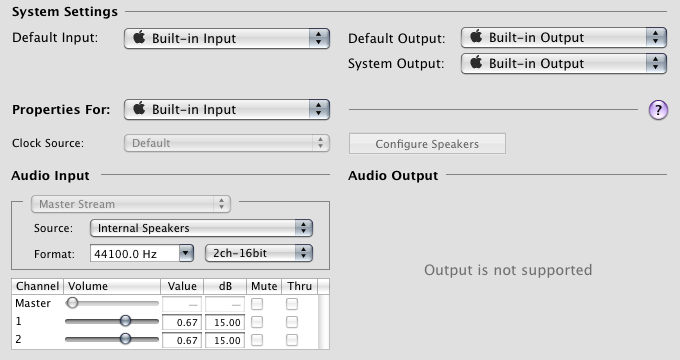

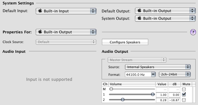

AlainTox714 Posted November 3, 2008 Author Share Posted November 3, 2008 Intel HDA Audio Codec STA9227, DQ965GF, (Mic, Headphones, MuteButton) v1 10.4.9 release for test. REMOVE the old HDAEnabler.kext and use the new one. Check if you are using another AUDIO injector like EFI strings or ALCinject and remove it otherwise it will not works. The new HDAEnabler report in startup log: localhost kernel[0]: HDAEnabler: Copyright © 2008 by Kabyl localhost kernel[0]: HDAEnabler: Added SPAudio support LayoutID:4 the old ones: localhost kernel[0]: HDAEnabler: Copyright © 2008 by Kabyl localhost kernel[0]: HDAEnabler: 05/05/2008 Added SPAudio support:Taruga I did this little hack (sorry Taruga) to avoid missmatching errors between HDAEnabler.kext and AppleHDA.kext which don't use the same layoutID 4 in this case. Now when you boot your system in mode verbose, you will see the used layoutID. Obviously it is also writen in system log. v1 release Outputs : Headphones Rear and Front Green Jack, Inputs : Microphone Rear Pink Jack, Line In Rear Blue Jack. Mute functionality expected working. System Profiler Audio report should only report 3 lines. Audio System preferences selection should be correct. STAC9227.v1_toTest.zip Link to comment https://www.insanelymac.com/forum/topic/130380-intel-hda-audio-codec-sta9274d/page/8/#findComment-954133 Share on other sites More sharing options...
sharms Posted November 3, 2008 Share Posted November 3, 2008 Finally, after 2 weeks of endlees installation of iDeneb's, iAkos's I succeeded (first week didn't noticed the SKIP button while verifying installation DVD ). Mobo: Intel DX48BT2 aka Bonetrail 2 CPU: Intel Core2 Quad Q9300 @ 2,5gHz RAM: 2GB CD/DVD: TSST corp CDDVDW SH-S223Q Controllers: Intel ICH9 Family LAN: Intel82566MM (onboard) VGA: ASUS (NVIDIA) GeForce 9600GT Silent (QE/CI: working) Audio: STAC9274D (SigmaTel High Definition Audio CODEC) (onboard) OS's: WinXP SP3 original @ Partinion1 / iDeneb 1.3 Leopard 10.5.5 @ Partition2 FireWire: Yes iDeneb 1.3 install notes: Vanilla Kernel, ICH9Fix, AppleBios = 1333 (as my RAM), no VGA/LAN drivers, onboard LAN/AUDIO disabled (!!!) in BIOS while installing and while first boot. After registration - enable them back. Then while installing ALL drivers: boot using mode '-x' in boot. LAN/VGA/Audio drivers: found @ InsanelyMac. Use OSXTools to repair permissions, set permissions, clear system cache after each driver is installed and before reboot. Problems: Doesn't reboot/shutdown. Not tested: Sleep. Link to comment https://www.insanelymac.com/forum/topic/130380-intel-hda-audio-codec-sta9274d/page/8/#findComment-954252 Share on other sites More sharing options...
wayover Posted November 4, 2008 Share Posted November 4, 2008 Intel HDA Audio Codec STA9227, DQ965GF, (Mic, Headphones, MuteButton) v1 10.4.9 release for test. .. Rear Mic, Headphones, Line-In works fine (9F33)!!! master slider disabled(gray) in audio setup. Thank you, Alain! Link to comment https://www.insanelymac.com/forum/topic/130380-intel-hda-audio-codec-sta9274d/page/8/#findComment-954314 Share on other sites More sharing options...

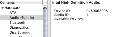

Vertigo555 Posted November 5, 2008 Share Posted November 5, 2008 Hi, I kind of new to this, I am running Leopard 10.5.2 with the vanilla kernel on a Gateway GT5238E. Everything works great except I have no sound. I have tried installing a variety of kexts, but to no avail. System Profiler says my Audio Device: Intel High Definition Audio Device ID: 0x107B505A Audio ID: 4 Available Devices: And thats it. I don't know what to do. Any help? Link to comment https://www.insanelymac.com/forum/topic/130380-intel-hda-audio-codec-sta9274d/page/8/#findComment-955418 Share on other sites More sharing options...
Amit Jakhar Posted November 5, 2008 Share Posted November 5, 2008 First of all i don't understand how your "Sigmatel VendorID is 8384 and my DevID is 7680". Otherwise for Sigmatel STAC9274D the DevID is 7621 and nothing else will works STAC9274D v-7. So what is your mobo? If your Codec is Sigmatel STAC9274D for installation just check the first post and this one: http://forum.insanelymac.com/index.php?sho...st&p=948875 Hope this help. Thanks for instant reply AlainTox714 i was hoping the same from you. Now let me put all clear details - Mobo is- Intel original 945GCL I am using Kalyway 10.5.2 with vanilla kernel Audio hardware- Sigmatel 9220, dev id 8384 and vendor id is- 7680 Now i think you have got all what u need so please now let me know what i need to do, thanks. Have a great day Link to comment https://www.insanelymac.com/forum/topic/130380-intel-hda-audio-codec-sta9274d/page/8/#findComment-955554 Share on other sites More sharing options...
AlainTox714 Posted November 5, 2008 Author Share Posted November 5, 2008 Thanks for instant reply AlainTox714 i was hoping the same from you. Now let me put all clear details - Mobo is- Intel original 945GCL I am using Kalyway 10.5.2 with vanilla kernel Audio hardware- Sigmatel 9220, dev id 8384 and vendor id is- 7680 Now i think you have got all what u need so please now let me know what i need to do, thanks. Have a great day OK thanks, AppleMacBook use Sigmatel STAC9221(D) D not shure, it's the same DevID than yours so you have to try with original AppleHDA.kext, pick an AUDIO enabler and set you mobo IOPCIPrimaryMatch in plist file at the right place, begin with old kext like 10.4.9, you will have more chance to get it working. If it doesn't work at all, later i will take a look because a few time ago i build an STAC9221D for a guy which was working i guess (no news). At this time i am busy with a work in progress (STAC9227 Codec). When i will be ready i will open a new thread so everybody will be able to find and catch it. I found very confusing to make a mix of all Sigmatel Codecs. Link to comment https://www.insanelymac.com/forum/topic/130380-intel-hda-audio-codec-sta9274d/page/8/#findComment-955585 Share on other sites More sharing options...
Amit Jakhar Posted November 5, 2008 Share Posted November 5, 2008 OK thanks, AppleMacBook use Sigmatel STAC9221(D) D not shure, it's the same DevID than yours so you have to try with original AppleHDA.kext, pick an AUDIO enabler and set you mobo IOPCIPrimaryMatch in plist file at the right place, begin with old kext like 10.4.9, you will have more chance to get it working. If it doesn't work at all, later i will take a look because a few time ago i build an STAC9221D for a guy which was working i guess (no news). At this time i am busy with a work in progress (STAC9227 Codec). When i will be ready i will open a new thread so everybody will be able to find and catch it. I found very confusing to make a mix of all Sigmatel Codecs. Thanks, I will try those .kext to make it work. And i read many comments it seems that the driver you have made its working about STAC9227. Great Job done. keep it up. Thanks one more time for giving advice. Link to comment https://www.insanelymac.com/forum/topic/130380-intel-hda-audio-codec-sta9274d/page/8/#findComment-955783 Share on other sites More sharing options...
AlainTox714 Posted November 5, 2008 Author Share Posted November 5, 2008 Thanks, I will try those .kext to make it work. And i read many comments it seems that the driver you have made its working about STAC9227. Great Job done. keep it up.Thanks one more time for giving advice. Take a look at this thread, could help. http://forum.insanelymac.com/index.php?s=&...st&p=170168 Hi, I kind of new to this, I am running Leopard 10.5.2 with the vanilla kernel on a Gateway GT5238E. Everything works great except I have no sound. I have tried installing a variety of kexts, but to no avail. System Profiler says my Audio Device: Intel High Definition Audio Device ID: 0x107B505A Audio ID: 4 Available Devices: And thats it. I don't know what to do. Any help? Both of you if you got time please make a Linux Codec Dump of your mobo and upload it. So i will look at it. Link to comment https://www.insanelymac.com/forum/topic/130380-intel-hda-audio-codec-sta9274d/page/8/#findComment-956023 Share on other sites More sharing options...
Vertigo555 Posted November 5, 2008 Share Posted November 5, 2008 Take a look at this thread, could help. http://forum.insanelymac.com/index.php?s=&...st&p=170168 Both of you if you got time please make a Linux Codec Dump of your mobo and upload it. So i will look at it. How could I go about making a linux codec dump? Link to comment https://www.insanelymac.com/forum/topic/130380-intel-hda-audio-codec-sta9274d/page/8/#findComment-956320 Share on other sites More sharing options...
