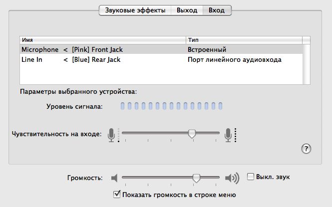

blood21 Posted October 14, 2008 Share Posted October 14, 2008 Here we are for test, please report. You have to set/check the right IOPCIPrimaryMatch 0x____8086 for your mobo in: AppleHDA.kext/Contents/PlugIns/AppleHDAController.kext/Contents/Info.plist wooooow !!! working my mic. you are my hero.. but i have one problem. when i select "headphones > [green] front jack" , i cannot hear anything. it show up in Sound pref, but both rear and front jack is not working sorry for my bad english thanks for your hard work Link to comment https://www.insanelymac.com/forum/topic/130380-intel-hda-audio-codec-sta9274d/page/3/#findComment-930048 Share on other sites More sharing options...

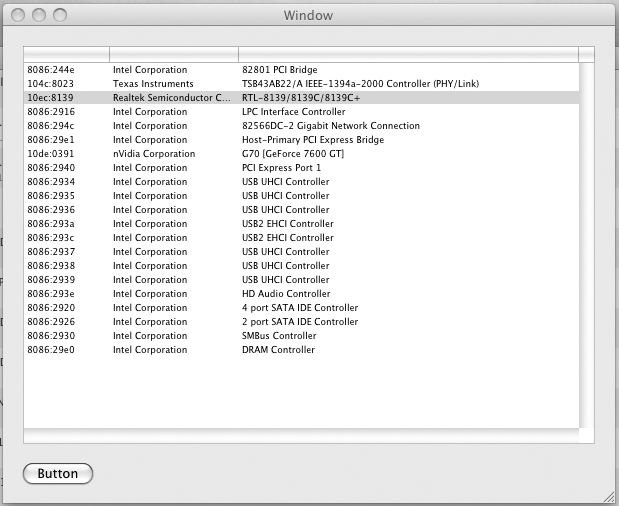

slim2001 Posted October 14, 2008 Share Posted October 14, 2008 have u checked whether "internal speakers" is selected (system preferences>sound>output tab)? coz it's default to headphones, thus, no sound will come out of your speakers. Yes i have checked that and its ok, how do i get the IOPCIPrimaryMatch? to set/check the right IOPCIPrimaryMatch 0x____8086 for your mobo in:AppleHDA.kext/Contents/PlugIns/AppleHDAController.kext/Contents/Info. 0x293E8086 thast my IOPCIPrimaryMatch which i got from Reggie SE Device id = 0x293E Vendor id = 0x8086 I did change the IOPCIPrimaryMatch data to 0x293E8086 but there is still no sound Link to comment https://www.insanelymac.com/forum/topic/130380-intel-hda-audio-codec-sta9274d/page/3/#findComment-930062 Share on other sites More sharing options...
slim2001 Posted October 14, 2008 Share Posted October 14, 2008 I got my ConfigData from vista <00a71c1f 00a71d40 00a71e21 00a71f02 00b71c2e 00b71d90 00b71ea1 00b71f02 00c71c21 00c71d30 00c71e81 00c71f01 00d71c10 00d71d40 00d71e11 00d71f01 00e71c20 00e71d90 00e71ea1 00e71f01 00f71c12 00f71d10 00f71e11 00f71f01 01071c11 01071d70 01071e11 01071f01 01171cfb 01171d00 01171e00 01171f40 01271cfe 01271d00 01271e00 01271f50 01371cff 01371d01 01371e00 01371f50 01471cfd 01471d01 01471e00 01471f50 02171c30 02171d21 02171e45 02171f01 02271cfc 02271d00 02271e00 02271f40> now in profiler it shows Device ID: 0x80860519 Audio ID: 2 Available Devices: Headphone: Connection: 1/8 inch Jack Microphone: Connection: 1/8 inch Jack S/P-DIF Out: Connection: Optical still no sound What is the name of this software? Link to comment https://www.insanelymac.com/forum/topic/130380-intel-hda-audio-codec-sta9274d/page/3/#findComment-930145 Share on other sites More sharing options...
AlainTox714 Posted October 14, 2008 Author Share Posted October 14, 2008 wooooow !!! working my mic. you are my hero.. but i have one problem. when i select "headphones > [green] front jack" , i cannot hear anything. it show up in Sound pref, but both rear and front jack is not working sorry for my bad english thanks for your hard work I was not shure it will works, the problem is that both green rear and front jack rely on the same NodeID, i guess it's forbidden or i don't know how to implement. This time i use the BLACK rear jack as speaker output and i am pretty shure headphone front green jack will work. kext REMOVED Please try and report. Link to comment https://www.insanelymac.com/forum/topic/130380-intel-hda-audio-codec-sta9274d/page/3/#findComment-930214 Share on other sites More sharing options...

AlainTox714 Posted October 14, 2008 Author Share Posted October 14, 2008 Yes i have checked that and its ok, how do i get the IOPCIPrimaryMatch?0x293E8086 thast my IOPCIPrimaryMatch which i got from Reggie SE Device id = 0x293E Vendor id = 0x8086 I did change the IOPCIPrimaryMatch data to 0x293E8086 but there is still no sound I compare again your linuxdump with mine and there is no real differences. Are you shure that the linuxdump come from your mobo? About the IOPCIPrimaryMatch data 0x293E8086 i am a little bit surprise as DP35DP mobo have the same or yours is X38 and use a different ICHx chipset. To check that use DPCIManager.app and report, if everything is OK it should work, BadAxe2 and DP35DP are working DPCIManager.app.zip you report: now in profiler it shows Device ID: 0x80860519 Audio ID: 2 Available Devices: Headphone: Connection: 1/8 inch Jack Microphone: Connection: 1/8 inch Jack S/P-DIF Out: Connection: Optical Normally with my kext you won't get that report. I guess you are using another audio injector kext or EFI audio string at the same time which interfere. Did you use v3 release? If not jump to v3. Can you test and confirm that your jacks are working with Linux or Windows please. Thanks for the information. On that link it says to tyr Team Scream's instead: http://forum.insanelymac.com/index.php?sho...=0&p=653520& So, I suppose if I can at least get up and running with Team Scream's tutorial then I can jump onto this thread and finish the job - in theory. Good guess and courage BadAxe is one of the most compatible and easy to install motherboard. Link to comment https://www.insanelymac.com/forum/topic/130380-intel-hda-audio-codec-sta9274d/page/3/#findComment-930244 Share on other sites More sharing options...

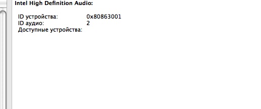

slim2001 Posted October 14, 2008 Share Posted October 14, 2008 you report: now in profiler it shows Device ID: 0x80860519 Audio ID: 2 Available Devices: Headphone: Connection: 1/8 inch Jack Microphone: Connection: 1/8 inch Jack S/P-DIF Out: Connection: Optical I got this report because i added configdata which i got from vista regedit This is the data i got on my audio from DPCIManager Link to comment https://www.insanelymac.com/forum/topic/130380-intel-hda-audio-codec-sta9274d/page/3/#findComment-930406 Share on other sites More sharing options...
