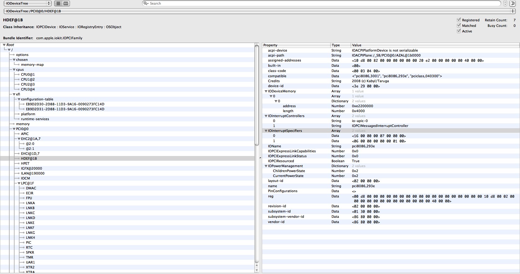

GLXOZ Posted October 14, 2008 Share Posted October 14, 2008 Maybe i must make another dump? This my hardware in DPCIManager in IORegistry Link to comment Share on other sites More sharing options...

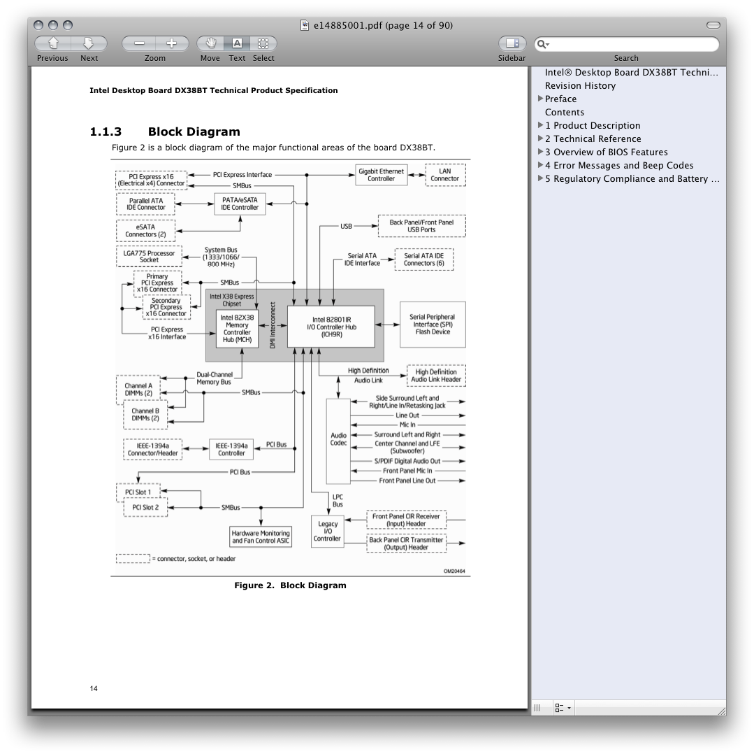

AlainTox714 Posted October 15, 2008 Author Share Posted October 15, 2008 Yes Vista is working Linux is working, SUSE 11 And Ubuntu 8.04 Windows Xp is also working no problem with sound. I have tried all jack ports and i am not getting any sound at all with Leopard Sorry to be very insitant, now i know for shure. About NodeID 36 both DX38BT and BADAXE 2 have the same node: Node 36 [Volume Knob Widget] wcaps 6291456: Mono Have you try another Custom DVD like Leo4All, i have reed a long time ago that iAtkos stripped all PPC code from is DVD and it is highly customized, so possibly something can prevent sound working. Personnaly i use a vanilla install with just a few kexts in EFI partition. Link to comment Share on other sites More sharing options...

AlainTox714 Posted October 15, 2008 Author Share Posted October 15, 2008 Do i always need the boot cd 123 in be in the drive to boot from vanilla? i dont know if i understood u right you installed from original leopard dvd? I remember i have somewhere iDeneb 10.5.4, so i make a clean install just add my 2 kexts and i can tell you it completely works. Otherwise yes i install from original leopard dvd. From a working partition, I mount the DVD on desktop and in terminal type: open /Volumes/Mac OS X Install DVD/System/Installation/Packages/OSInstall.mpkg enter your password when asked, then follow the usual procedure eg choise a partition erase and install. Don't reboot archive delete and add some specific kext like dsmos Install boot loader bootefi.v8 works fine or Chameleon then reboot. Normaly enjoy if you mobo is comptatible (i think yes) sound should works. Link to comment Share on other sites More sharing options...

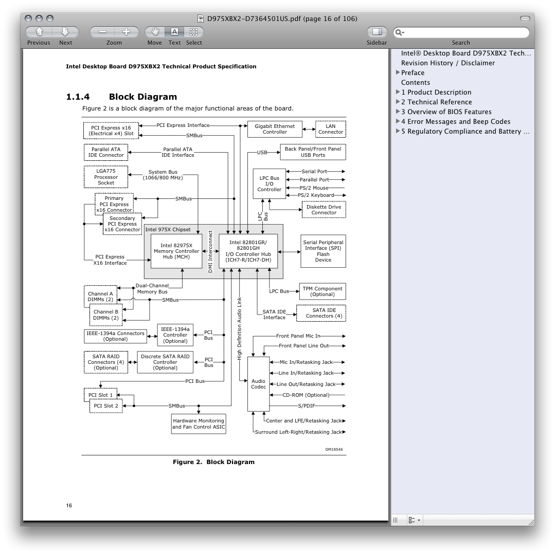

AlainTox714 Posted October 15, 2008 Author Share Posted October 15, 2008 i have tried ideneb before and i had a little problem with that just wondering which version other people using this audio patch are using maybe it is just this MB maybe it just need entirely different driver Couldn't say, Intel® Desktop Board D975XBX2 Intel® High Definition Audio subsystem in one of the following configurations: * 8-channel (7.1) audio subsystem with five analog audio outputs and two S/PDIF digital audio outputs (coaxial and optical) using the Sigmatel* 9274D audio codec Intel® Desktop Board DX38BT Intel® High Definition Audio subsystem in the following configuration: * 8-channel (7.1) Dolby Home Theater* Audio subsystem with five analog audio outputs and two S/PDIF digital audio outputs (coaxial and optical) using the Sigmatel* 9274D audio codec is the Dolby Home Theater* which makes difference, possibly as it is not manageable in OSX. It also seems that you don't benefit of Jack Sensing and Jack Retasking technology, could be another problem. "Do not mistake Jack Sensing and Universal Audio Jack, even if they are intimately related. The Universal Audio Jack is indeed a system, which allows the controller to automatically detect the type of media connected to all inputs and outputs." from: http://www.behardware.com/articles/555-3/i...nition-dio.html Notice the differences in the 2 diagrams are big enought to get sound not working. Otherwise a discover a very nice and complete ATX motherboard, if i don't own a Bad Axe i am pretty shure i had choise it. Link to comment Share on other sites More sharing options...
