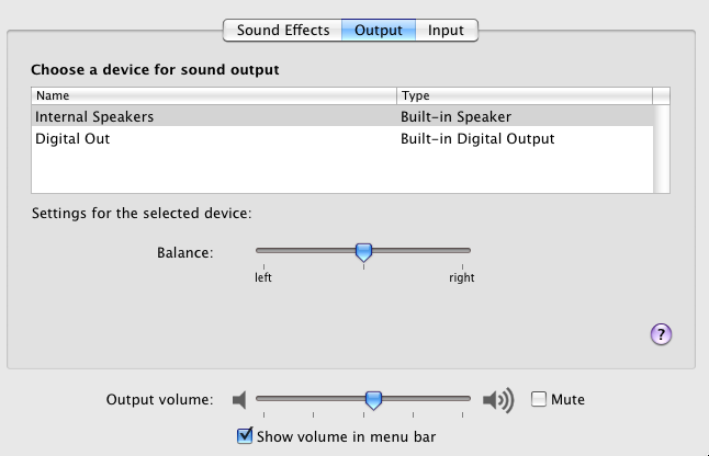

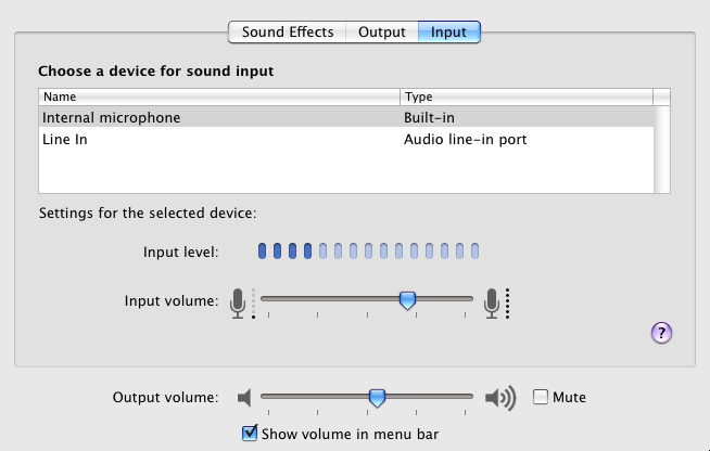

homer007 Posted February 15, 2009 Share Posted February 15, 2009 yes it does thankyou so much i had to edit AppleHDAController.kext to add new configdata and change CodecID from 283904133 to 283904131 at Address 0. proof: Edit: just one question can i not enable mic out aswell and have the internal mic option? Link to comment https://www.insanelymac.com/forum/topic/129058-boot-132-legacy-applehda/page/8/#findComment-1081230 Share on other sites More sharing options...
VCH888 Posted February 16, 2009 Share Posted February 16, 2009 yes it does thankyou so much i had to edit AppleHDAController.kext to add new configdata and change CodecID from 283904133 to 283904131 at Address 0. Edit: just one question can i not enable mic out aswell and have the internal mic option? Could you edit info.plist by changing from 01871f90 to 01871f01 in ConfigData of LegacyHDAController.kext? And changing PinConfigurations of HDAEnabler.kext from <10111101 4099a190 30318101 20014399> to <10111101 4099a101 30318101 20014399>. It should show as External Mic instead of Internal Mic. If you want to get "Encoded Digital Audio" through Digital Out, you have to patch AppleHDA binary from 85 08 ec 10 to 83 08 ec 10. See MadTux's guide and THe KiNG's guide. I think you can edit AppleHDA.kext since the legacy works on your Acer, and you know how to edit info.plists. Link to comment https://www.insanelymac.com/forum/topic/129058-boot-132-legacy-applehda/page/8/#findComment-1081747 Share on other sites More sharing options...
