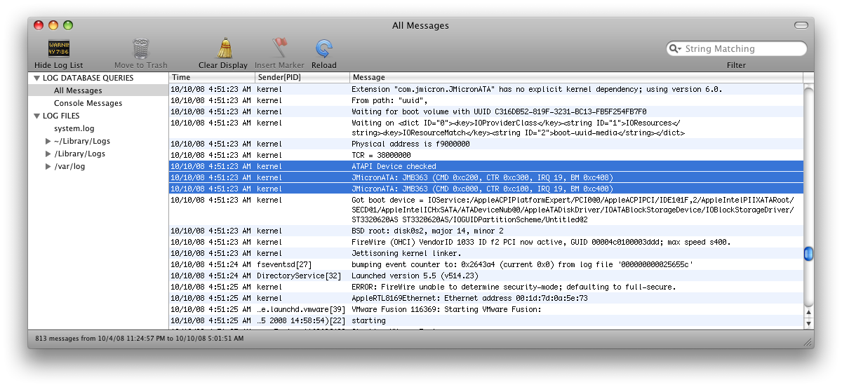

El Massman Posted October 9, 2008 Share Posted October 9, 2008 i'm getting the same problem can't determine immediate dependencies for com.jmicron.JMicronATA can't determine dependencies for com.jmicron.JMicronATA can't alloc class="JMicronATAPIroot" let me know if there's anything i can do to help testing wise. or any information you need. thanks, Marc Link to comment https://www.insanelymac.com/forum/topic/127611-appleviaata-over-4gb-ram-bug-solved-at-least-i-believe-so-jmicron-and-applenforceata-at-development/page/2/#findComment-923772 Share on other sites More sharing options...
slashack Posted October 9, 2008 Author Share Posted October 9, 2008 Ok i just got a working JmicronATA.kext form JMICRON ftp. It still has the RAM problem but at least it loads. So you can try modify this one hope this will help. I've uploaded a new version, using Info.plist from your kext. Did someone tried with the unmodified JMIcron? does it loads correctly? I think the problem might be in the original source code i'm working. Link to comment https://www.insanelymac.com/forum/topic/127611-appleviaata-over-4gb-ram-bug-solved-at-least-i-believe-so-jmicron-and-applenforceata-at-development/page/2/#findComment-923826 Share on other sites More sharing options...

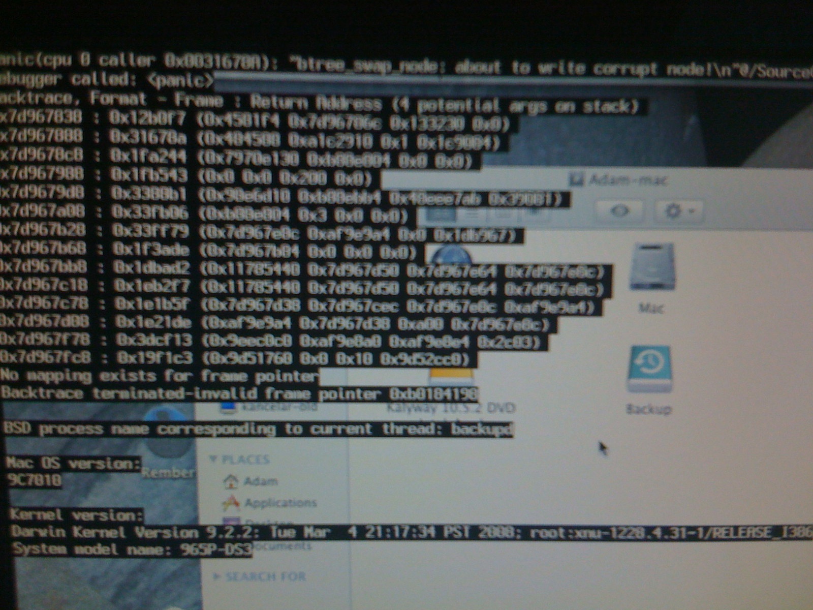

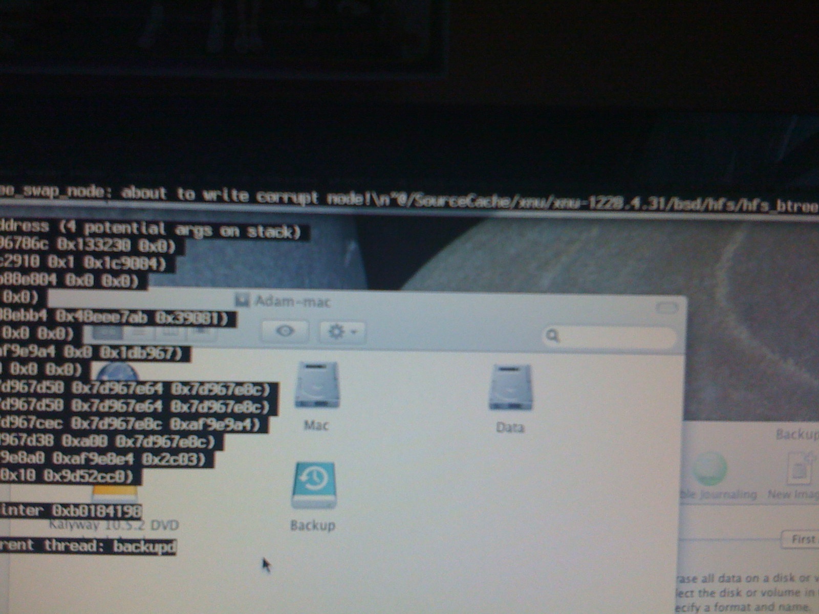

adusak Posted October 9, 2008 Share Posted October 9, 2008 Just tried the update and it gives me kernel panic while booting had to unplug my pata devices just to get back to the system Link to comment https://www.insanelymac.com/forum/topic/127611-appleviaata-over-4gb-ram-bug-solved-at-least-i-believe-so-jmicron-and-applenforceata-at-development/page/2/#findComment-924033 Share on other sites More sharing options...
slashack Posted October 9, 2008 Author Share Posted October 9, 2008 Just tried the update and it gives me kernel panic while booting had to unplug my pata devices just to get back to the system Can u give me some info on the panic? (boot with debug=0x100) Have u tried the original kext i uploaded? That's the source code without any modification by me. If this works, then my modification should work too, but if it doesn't work, then the source code is not usefull. Link to comment https://www.insanelymac.com/forum/topic/127611-appleviaata-over-4gb-ram-bug-solved-at-least-i-believe-so-jmicron-and-applenforceata-at-development/page/2/#findComment-924037 Share on other sites More sharing options...

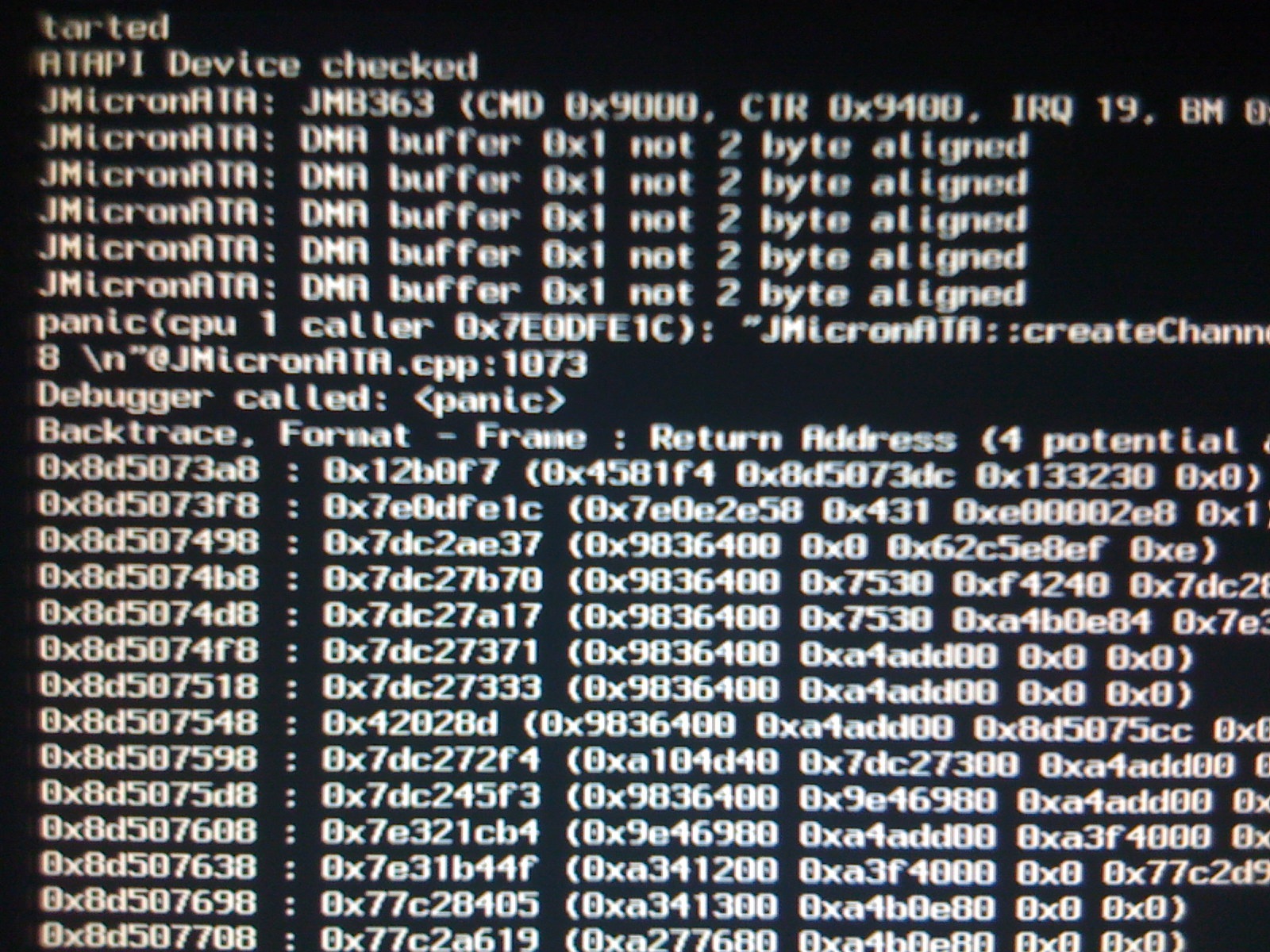

adusak Posted October 9, 2008 Share Posted October 9, 2008 Yes i tried your unmodified kext but after booting it didnt find my pata devices so it probably didnt load. I will upload some pictures of the kernel panic in a few moments. EDIT: Ok i attached images of the panic Link to comment https://www.insanelymac.com/forum/topic/127611-appleviaata-over-4gb-ram-bug-solved-at-least-i-believe-so-jmicron-and-applenforceata-at-development/page/2/#findComment-924060 Share on other sites More sharing options...
slashack Posted October 9, 2008 Author Share Posted October 9, 2008 Yes i tried your unmodified kext but after booting it didnt find my pata devices so it probably didnt load.I will upload some pictures of the kernel panic in a few moments. EDIT: Ok i attached images of the panic Ok, the driver is working now. That's good news. This issue is known to me. In AppleVIAATA, dma needed to be 2 byte aligned, but in JMicron, it needs to be 4 byte aligned. I'll fix that asap. Link to comment https://www.insanelymac.com/forum/topic/127611-appleviaata-over-4gb-ram-bug-solved-at-least-i-believe-so-jmicron-and-applenforceata-at-development/page/2/#findComment-924083 Share on other sites More sharing options...
slashack Posted October 9, 2008 Author Share Posted October 9, 2008 Yes i tried your unmodified kext but after booting it didnt find my pata devices so it probably didnt load.I will upload some pictures of the kernel panic in a few moments. EDIT: Ok i attached images of the panic I've updated JMicron kext (v0.4) Try them and tell me what happened. Sorry for all this, but i don't have such hardware to test them. Link to comment https://www.insanelymac.com/forum/topic/127611-appleviaata-over-4gb-ram-bug-solved-at-least-i-believe-so-jmicron-and-applenforceata-at-development/page/2/#findComment-924326 Share on other sites More sharing options...

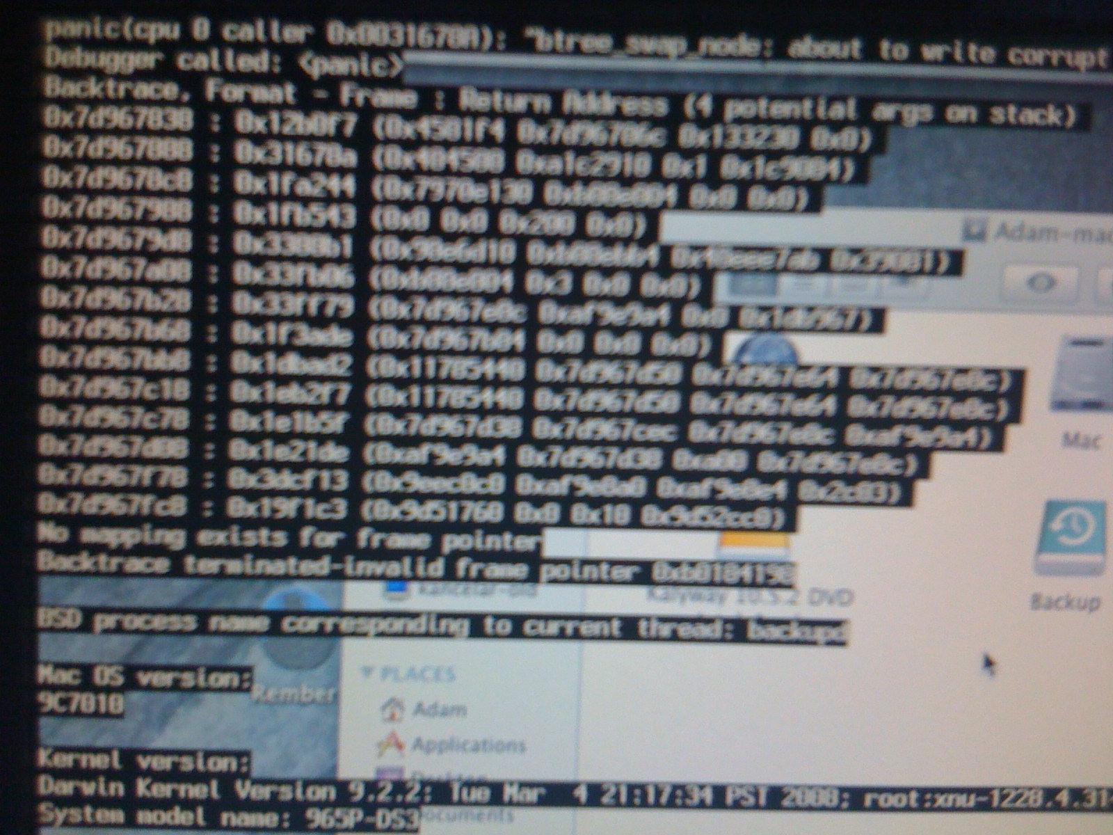

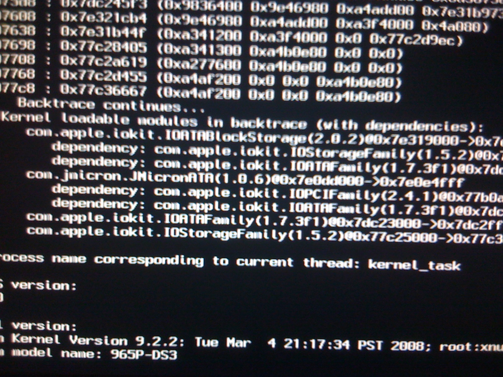

rfuilrez Posted October 9, 2008 Share Posted October 9, 2008 I've updated JMicron kext (v0.4) Try them and tell me what happened. Sorry for all this, but i don't have such hardware to test them. No dice on that one either. Attached is a photo of the Kernel Panic. Occurred during boot.. Link to comment https://www.insanelymac.com/forum/topic/127611-appleviaata-over-4gb-ram-bug-solved-at-least-i-believe-so-jmicron-and-applenforceata-at-development/page/2/#findComment-924356 Share on other sites More sharing options...
slashack Posted October 9, 2008 Author Share Posted October 9, 2008 No dice on that one either. Attached is a photo of the Kernel Panic. Occurred during boot.. Theres a new version (0.5). I forgot to update some pointer references in the transfer. Be patient, the 4gb issue is in the method i'm actually doing changes (createChannelCommands), the one that panics. I believe this kext might work. Thanks to the testers! Link to comment https://www.insanelymac.com/forum/topic/127611-appleviaata-over-4gb-ram-bug-solved-at-least-i-believe-so-jmicron-and-applenforceata-at-development/page/2/#findComment-924394 Share on other sites More sharing options...

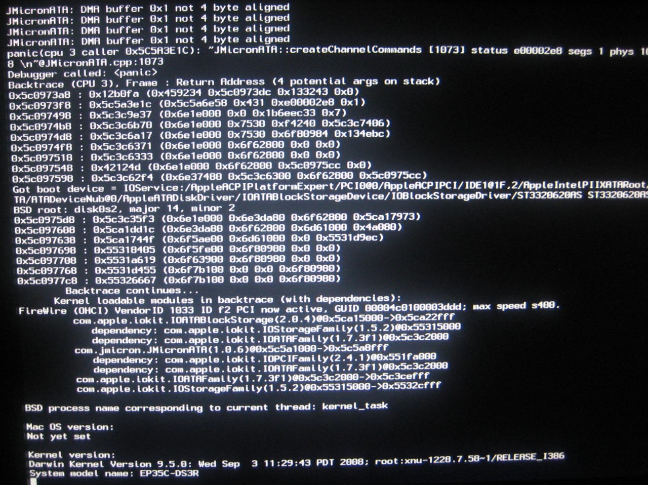

mitch_de Posted October 10, 2008 Share Posted October 10, 2008 Theres a new version (0.5). I forgot to update some pointer references in the transfer.Be patient, the 4gb issue is in the method i'm actually doing changes (createChannelCommands), the one that panics. I believe this kext might work. Thanks to the testers! Thanks to you also ! I buyed yesterday an 10 Euro IDE>SATA module to avoid that > 3 GB RAM problem with my JM until we get it fixed. WORKED. I now have disabled all IDE on my GA board. My solution may be helpful if you only have one IDE left (i have SATA DVD and one SATA HD, only one IDE HD). If you have more than one IDE i would wait for that great work or sell the IDEws to ebay and buy SATA therefor. Link to comment https://www.insanelymac.com/forum/topic/127611-appleviaata-over-4gb-ram-bug-solved-at-least-i-believe-so-jmicron-and-applenforceata-at-development/page/2/#findComment-924609 Share on other sites More sharing options...
rfuilrez Posted October 10, 2008 Share Posted October 10, 2008 Theres a new version (0.5). I forgot to update some pointer references in the transfer.Be patient, the 4gb issue is in the method i'm actually doing changes (createChannelCommands), the one that panics. I believe this kext might work. Thanks to the testers! Well, I'm not going to jump to any conclusions and say that it's 100% fixed for sure. However, this is me playing a video from my IDE Drive with the majority of 4GB allocated. And here's the only stuff I saw in the boot log. It seems to me, you may have hit the nail on the head with this fix. Link to comment https://www.insanelymac.com/forum/topic/127611-appleviaata-over-4gb-ram-bug-solved-at-least-i-believe-so-jmicron-and-applenforceata-at-development/page/2/#findComment-924819 Share on other sites More sharing options...

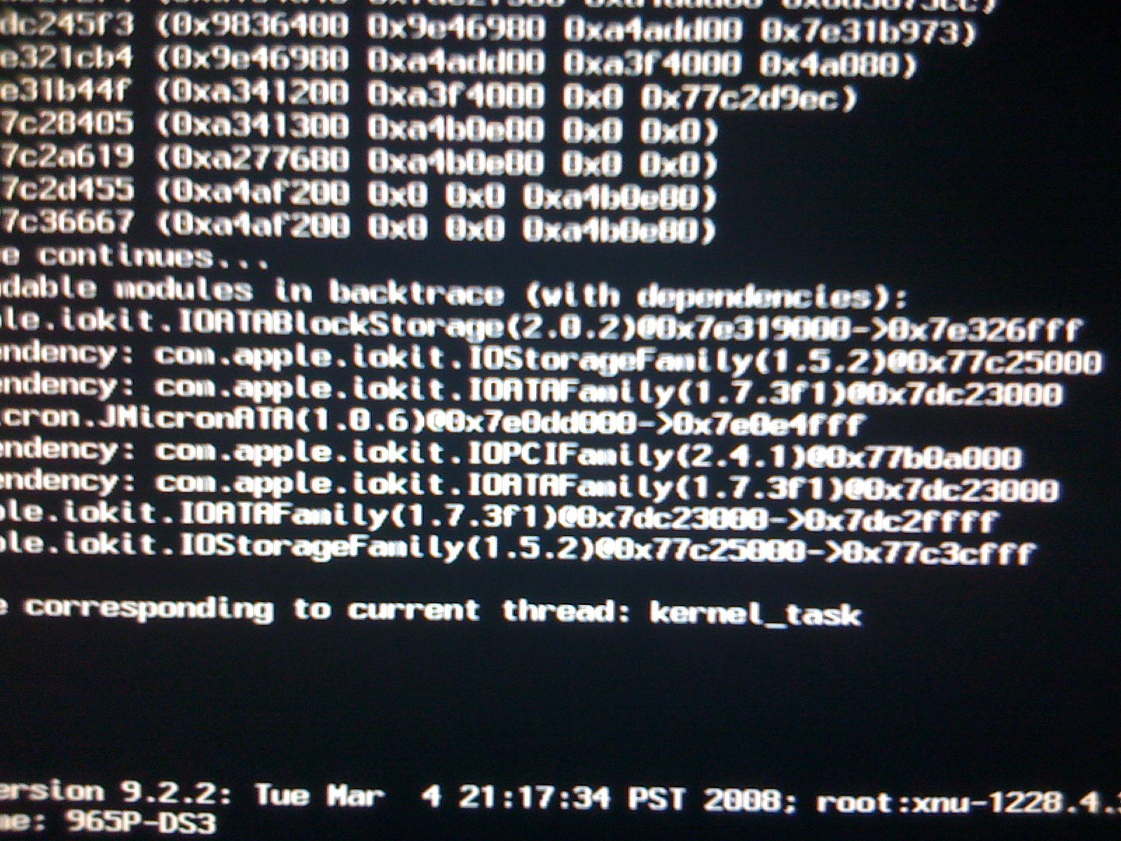

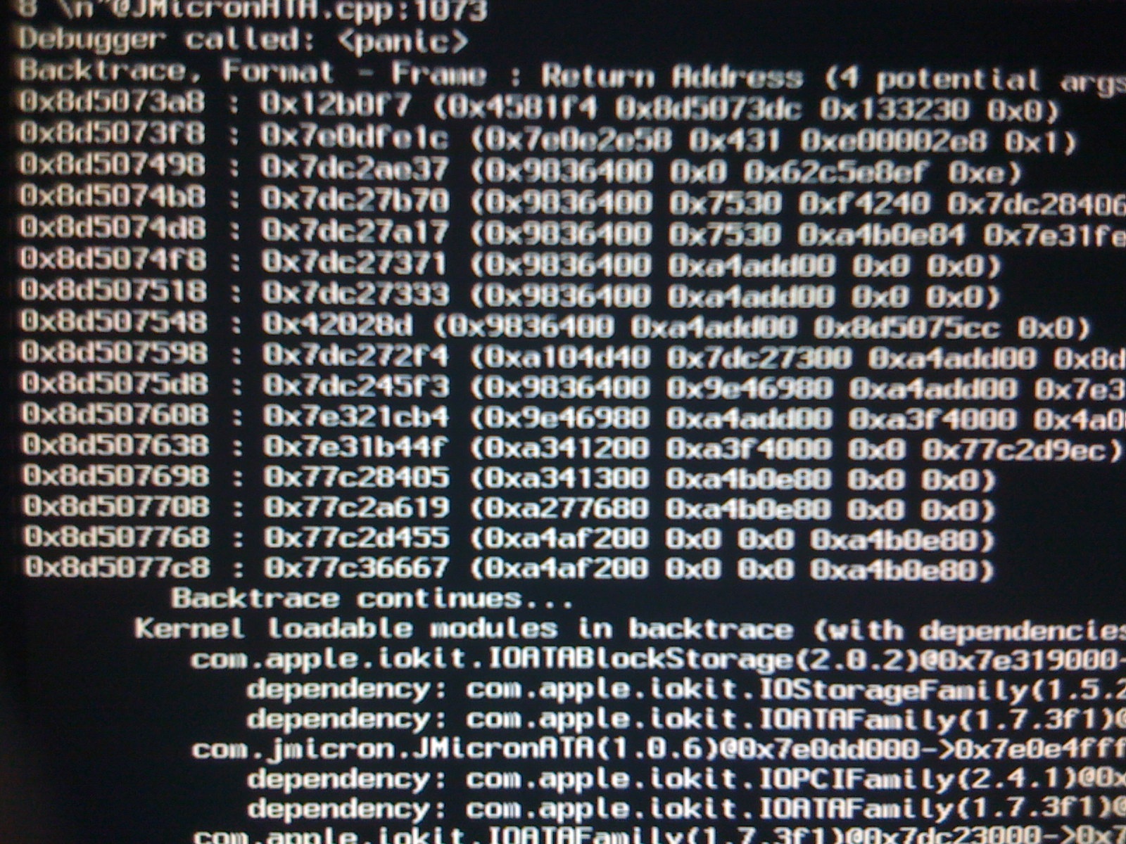

adusak Posted October 10, 2008 Share Posted October 10, 2008 Ok i think this could be the thing. But i still experienced panic i dont believe it is related but i attache pictures anyway. Link to comment https://www.insanelymac.com/forum/topic/127611-appleviaata-over-4gb-ram-bug-solved-at-least-i-believe-so-jmicron-and-applenforceata-at-development/page/2/#findComment-924941 Share on other sites More sharing options...
mitch_de Posted October 10, 2008 Share Posted October 10, 2008 Ok i think this could be the thing. But i still experienced panic i dont believe it is related but i attache pictures anyway. if you set maxmem=2000 (as kernel boot flag)do you also get panics ? I f yes something other may be wrong. I would also check RAM with REMBER / memtest - problematic RAM can also make much troubles. I got (now i use an IDE>SATA contr) kernel panic really early at boottime with JM and 4 GB. I never saw the desktop , crash was way before. Link to comment https://www.insanelymac.com/forum/topic/127611-appleviaata-over-4gb-ram-bug-solved-at-least-i-believe-so-jmicron-and-applenforceata-at-development/page/2/#findComment-925153 Share on other sites More sharing options...
slashack Posted October 10, 2008 Author Share Posted October 10, 2008 Ok i think this could be the thing. But i still experienced panic i dont believe it is related but i attache pictures anyway. I don't think those panics are related, but as rfuilrez said, don't jump to conclusions. The panic ocurred somewhere in hfs filesystem, the thread was backupd. Maybe your hdd has something wrong, and not the ide controller. The other issue might be memory. Try testint them (verify hdd in disk utility) and if panics is recurrent, try booting with maxmem=2048. If u keep having panics, then the issue is not this kext. Link to comment https://www.insanelymac.com/forum/topic/127611-appleviaata-over-4gb-ram-bug-solved-at-least-i-believe-so-jmicron-and-applenforceata-at-development/page/2/#findComment-925377 Share on other sites More sharing options...

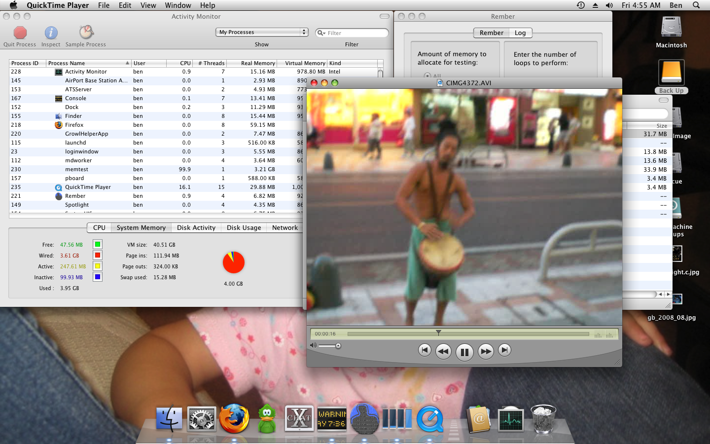

bikinifarm Posted October 15, 2008 Share Posted October 15, 2008 The memory issue is the one i solved. I'll try and solve the other issue. If u could test if kext work it would be great. (run rember to test all memory and try and open files from IDE disks) Can you attach a plist from v1.0? I am attaching the plist as well as a few screen shots as to how the DVD looks on the desktop. Many thanks slashack! The original JMicron v1.0: The JMicron 1.06 from their web site: The 64 bit corrected version by slashack: and the plist from the JMicron version 1.0: Info.plist.zip Link to comment https://www.insanelymac.com/forum/topic/127611-appleviaata-over-4gb-ram-bug-solved-at-least-i-believe-so-jmicron-and-applenforceata-at-development/page/2/#findComment-930915 Share on other sites More sharing options...
rfuilrez Posted October 15, 2008 Share Posted October 15, 2008 One thing I did notice with THIS driver is the allocated memorydidn't appear to come back to the free pool or it took its time. That's actually how OS X manages memory. Even without this kext it will do it the same way. It keeps the memory allocated, but flags it as inactive. So if you use the program again, it already has the data loaded. And then if you need memory for another program, it will free up what's needed, and allocate it for that app instead. Link to comment https://www.insanelymac.com/forum/topic/127611-appleviaata-over-4gb-ram-bug-solved-at-least-i-believe-so-jmicron-and-applenforceata-at-development/page/2/#findComment-931046 Share on other sites More sharing options...
