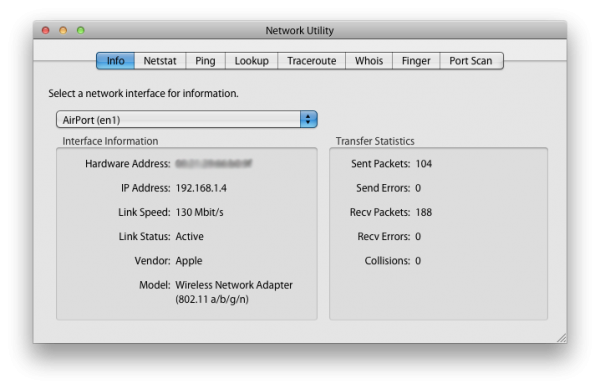

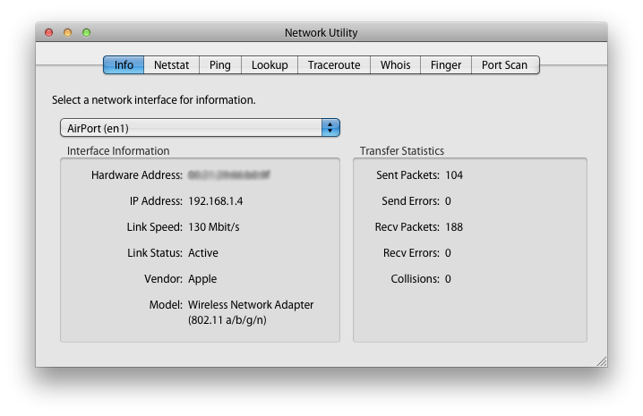

small cat Posted August 24, 2008 Share Posted August 24, 2008 Thanks for Chrand and BuildSmart Hey, It works. I rebrand my WMP300n. Now my OSX see WMP300N as Airport Extream card. Question: my wireless still show at 130mbps instead of 300mbps. Do i need to reaplce or add any kext file.(my install DVD is kalyway 10.5.2) edit: I think I found why wmp300n won't show 300mbps becouse this card doesn't support 40mhz band which require for 300mbps. (sigh, it says on the data sheet on Linksys website) Link to comment https://www.insanelymac.com/forum/topic/121293-rebranding-broadcom-based-80211bgn-cards/#findComment-867593 Share on other sites More sharing options...
Guest BuildSmart Posted August 25, 2008 Share Posted August 25, 2008 Thanks for Chrand and BuildSmartHey, It works. I rebrand my WMP300n. Now my OSX see WMP300N as Airport Extream card. Question: my wireless still show at 130mbps instead of 300mbps. Do i need to reaplce or add any kext file.(my install DVD is kalyway 10.5.2) edit: I think I found why wmp300n won't show 300mbps becouse this card doesn't support 40mhz band which require for 300mbps. (sigh, it says on the data sheet on Linksys website) Really, boot into windows and make a connection and tell me it doesn't connect at 270mbps or better? Rebranding corrects connection dropping and other stability issues, even real apple airport devices only connect at 130mbps on b/g/n networks, I've never seen anything higher myself. Link to comment https://www.insanelymac.com/forum/topic/121293-rebranding-broadcom-based-80211bgn-cards/#findComment-868136 Share on other sites More sharing options...

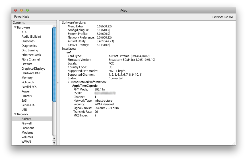

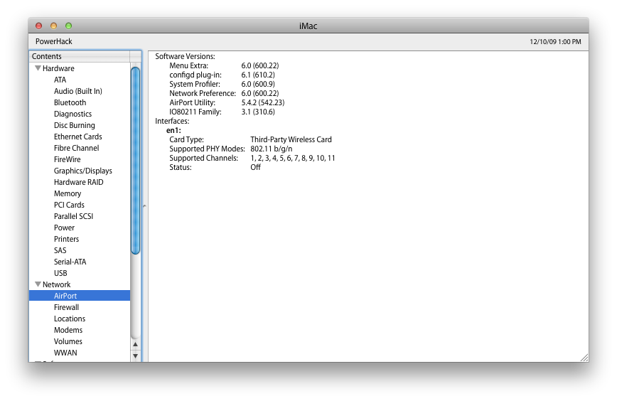

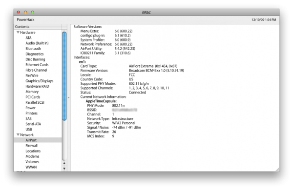

sk1nhead Posted December 10, 2009 Share Posted December 10, 2009 Perfect!!! Thanks to Prasys blog entry for pointing me to this post.. works on my Linksys WMP300N Rev1.. Before: After: 4) [Optional] Update the Broadcom kext info.plist - Depending on the method you used to install OSX, your machine may not recognize the card. This is because the PCI Product ID (14e4,4329) may not be in the list of IDs configured to use the Broadcom driver. There are various methods for modifying this file. One method is outlined in this post. The line you add should look like the one below. I have attached a copy of my info.plist as an example. question, why step #4 is optional? will my card work if i remove 4329? if not is it possible to keep the plist vanilla? DSDT injection perhaps? my card works only if I added 14e4,4329 on broadcom plist but haven't tried removing it after the rebrand. BTW AFAIR my WLAN works OOTB on 10.5.0 (first leopard DVD) without any plist editing or hack. scratch that, working now.. stupid me :-) Link to comment https://www.insanelymac.com/forum/topic/121293-rebranding-broadcom-based-80211bgn-cards/#findComment-1355486 Share on other sites More sharing options...
