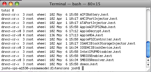

skeezen1 Posted May 6, 2009 Share Posted May 6, 2009 Wingrunr, thank you very much for your guide. After having decent success dualbooting OSX on my 1530 with the iDeneb distro I decided to do clean retail install. I have OSX installed and am at your 'Update to 10.5.6 Vanilla' step (even though I am on 10.5.6 I am sure there are updates to be had). I installed Chameleon 2.1.0-r431.pkg, I also installed the bootloader from netkas's site - overwriting the boot file in the root. I grabbed Brandon2004/Chrysaor's DSDT.am for the 1530 (tried the one originally posted and the most recent one) and applied the proper chown/chmod commands. I removed the boot cd to confirm I booted cleanly and I received what I assume to be a kernel panic (grey screen, pls reboot, etc). After reading through this thread I reinstalled Chameleon and did NOT overwrite the boot file from Netkas. Chameleon screen loaded, chose OSX, and eventually hit the same kernel panic. I can boot fine using the CD and choosing device 80. When it boot it doesn't give me the option to do a -v or provide other startup options. Any ideas what could be causing this, or how to best troubleshoot it? Thanks again! Link to comment https://www.insanelymac.com/forum/topic/119654-guide-leopard-on-an-xps-13301530/page/18/#findComment-1149428 Share on other sites More sharing options...

skeezen1 Posted May 7, 2009 Share Posted May 7, 2009 You should probably try reinstalling the chameleon, I would guess that is what is causing the problem. If that doesn't help, try removing kexts that you installed one by one untill you get the system to boot. If the kext is the one that is always required to boot the system(for example SMbiosResolver, Decryptor, etc) then just try to reinstall those. Meanwhile, I am have just noticed a problem when I can't boot into Mac Os if I have an SD card inserted in the slot. Do you guys have same effect when having an SD card in the slot? Is there a solution for that? I need to have it there all the time since I use it for ready boost on the Windows 7 partition. Do you guys also have the problem where you sometimes loose sound after you put the laptop to sleep? Thanks Danik, After reading this thread from start to finish I realized I did not copy the kexts from my boot-132 to my installation. I can't find it in the guide portion of thread that I printed out, but found it in a later reply. @Chrysaor: I installed your latest DSDT.aml that you mentioned included audio. While the graphics portion work great on my 1530 (QE/CI, VGA out, etc) the audio does not appear to work. Is another kext required? Link to comment https://www.insanelymac.com/forum/topic/119654-guide-leopard-on-an-xps-13301530/page/18/#findComment-1150057 Share on other sites More sharing options...

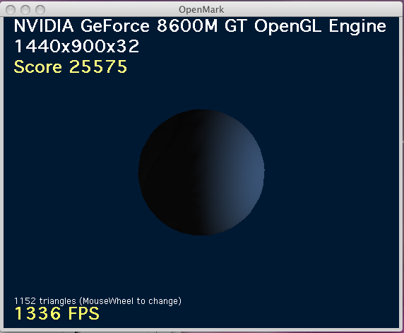

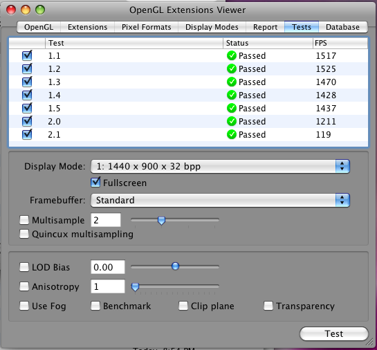

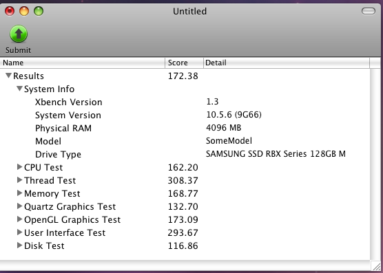

skeezen1 Posted May 8, 2009 Share Posted May 8, 2009 I'd like to again thank everyone who has responded to my questions. I'm pretty satisfied with the way I have my 1530 configured, but before I go off and start settling in on the system I wanted to check that my performance is within the range that you would expect. I'm attaching my xBench, OpenGL Extensions and OpenMark results. I'd appreciate a quick glance to confirm these are in line with what you would expect. Thanks again! Link to comment https://www.insanelymac.com/forum/topic/119654-guide-leopard-on-an-xps-13301530/page/18/#findComment-1150833 Share on other sites More sharing options...
