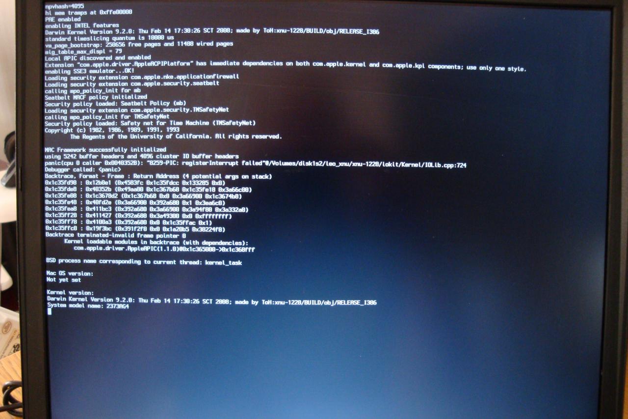

breakingbad Posted July 17, 2008 Share Posted July 17, 2008 @ Mysticus Hi mate. How ya doing? How was your trip? I remember you said it would be gone of the forum for a few days. Hope everything went fine. I´m having a little trouble updating to 10.5.4 Delta file. I installed it on a test partition but when restarting got this screen. I don´t know what went wrong. I´m using your 1.3 update package, but not the 1.4 one. Do you believe that could be the problem? About the update package, just selected standard options. No kernel changes at all. Hope to hear from you soon. []´s ----------------------------------------------------------------------------------------------------------------------------------------------------------------------------- Hi. Still me. More news about my problem on updating to 10.5.4 with Delta file. Here are the screens. You can see that all the proccess goes fine and before rebooting the system recognizes that is 10.5.4 installed version. I used the standard options for the installation. After rebooting, it shows this screen. Seems to be something about my keyboard. It´s the last line shown in the log and the comes the message: "Still waiting for root device" Waiting on you people... []´s Link to comment https://www.insanelymac.com/forum/topic/109102-complete-updates-for-newbies-and-all-currently-1055-combo-only-intel-cpus/page/22/#findComment-822891 Share on other sites More sharing options...

breakingbad Posted July 18, 2008 Share Posted July 18, 2008 @breaking bad: i dont know how you got that pcgenusb2 but it is creating conflict in your system... get rid of it... and if u installed kalyway 10.5.2 as base system, you should check my guide pic on the nforce topic, u have to deselect it when installing... you can however try this: boot using -v -f this should load nforceata and load the system hopefully later delete S/L/E/IOUSBFamily.kext/Contents/Plugins/PCGenUSBEHCI.kext Hi mate. I don't know either why I got this message. I'm using the Kalyway 10.5.2 DVD as base system but never selected any kind of option about PCGenUSB or something. Just got that message. As I'm working right now, I can't try to fix it right now, but I'll do it ASAP. Thnx for the repply. I hope that this change take effect to my system. []'s Link to comment https://www.insanelymac.com/forum/topic/109102-complete-updates-for-newbies-and-all-currently-1055-combo-only-intel-cpus/page/22/#findComment-823669 Share on other sites More sharing options...

breakingbad Posted July 18, 2008 Share Posted July 18, 2008 @ Mysticus. Hi mate. Well, booting with -v -f worked for me just fine. I´m justing having trouble with the path you told me to follow to delete the PCGenUSBEHCI.kext because in my SYSTEM>LIBRARY>EXTENSIONS folder there´s only the IOSUBFamily.kext but as a file not as a folder and the part of CONTENTS>PLUGINS doesn´t have. Am I looking for it in the wrong place/folder? Waiting on you. []´s Link to comment https://www.insanelymac.com/forum/topic/109102-complete-updates-for-newbies-and-all-currently-1055-combo-only-intel-cpus/page/22/#findComment-824120 Share on other sites More sharing options...

Mysticus C* Posted July 18, 2008 Author Share Posted July 18, 2008 @ Mysticus. Hi mate. Well, booting with -v -f worked for me just fine. I´m justing having trouble with the path you told me to follow to delete the PCGenUSBEHCI.kext because in my SYSTEM>LIBRARY>EXTENSIONS folder there´s only the IOSUBFamily.kext but as a file not as a folder and the part of CONTENTS>PLUGINS doesn´t have. Am I looking for it in the wrong place/folder? Waiting on you. []´s right click on the kext file and choose show contents it will bring up another finder window with the contents... and open contents/plugins... kext files are actually folders u just dont know it yet sort of containers... Link to comment https://www.insanelymac.com/forum/topic/109102-complete-updates-for-newbies-and-all-currently-1055-combo-only-intel-cpus/page/22/#findComment-824209 Share on other sites More sharing options...
breakingbad Posted July 18, 2008 Share Posted July 18, 2008 right click on the kext file and choose show contents it will bring up another finder window with the contents... and open contents/plugins... kext files are actually folders u just dont know it yet sort of containers... Hi mate. Know I understand why couldn´t find the specified folder. That´s the reason that keeps always getting me back here. I´m restoring my TEST Partition so I can apply the 10.5.4 Delta Update file. I was wondering... to my working partition, should I delete the PCGenUSBEHCI.kext before installing the update file or just after the update proccess? []´s Link to comment https://www.insanelymac.com/forum/topic/109102-complete-updates-for-newbies-and-all-currently-1055-combo-only-intel-cpus/page/22/#findComment-824235 Share on other sites More sharing options...
Mysticus C* Posted July 18, 2008 Author Share Posted July 18, 2008 Hi mate.Know I understand why couldn´t find the specified folder. That´s the reason that keeps always getting me back here. I´m restoring my TEST Partition so I can apply the 10.5.4 Delta Update file. I was wondering... to my working partition, should I delete the PCGenUSBEHCI.kext before installing the update file or just after the update proccess? []´s whenever u want... Link to comment https://www.insanelymac.com/forum/topic/109102-complete-updates-for-newbies-and-all-currently-1055-combo-only-intel-cpus/page/22/#findComment-824320 Share on other sites More sharing options...
