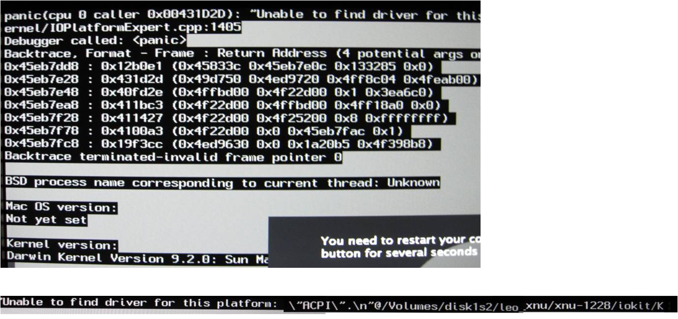

bigpcman Posted June 27, 2008 Share Posted June 27, 2008 Hello All, I have tried the 10.5.3 update (1.4a) on an unmodified iATKOS 2.0i stable install in a Dell Precision 360. The update completes without any problems. However, the subsequent boot fails as a result of a panic call. See message in screen capture image. The boot process appears to be looking for the ACPI driver in disk1s2/leo... The system is loaded on disk0s1 so I don't know why the boot process is trying to access disk1s2. I should also mention by way of background that whenever I reboot the system the iATKOS 2.0i install disk must be in the dvd drive or else the boot fails. Does anybody know what steps I should take next? Link to comment https://www.insanelymac.com/forum/topic/109102-complete-updates-for-newbies-and-all-currently-1055-combo-only-intel-cpus/page/19/#findComment-798279 Share on other sites More sharing options...

NSCXP2005 Posted June 27, 2008 Share Posted June 27, 2008 Hello All,I have tried the 10.5.3 update (1.4a) on an unmodified iATKOS 2.0i stable install in a Dell Precision 360. The update completes without any problems. However, the subsequent boot fails as a result of a panic call. See message in screen capture image. The boot process appears to be looking for the ACPI driver in disk1s2/leo... The system is loaded on disk0s1 so I don't know why the boot process is trying to access disk1s2. I should also mention by way of background that whenever I reboot the system the iATKOS 2.0i install disk must be in the dvd drive or else the boot fails. Does anybody know what steps I should take next? I have the same problem aswell as you, I hope somebody can help us fix this problem Link to comment https://www.insanelymac.com/forum/topic/109102-complete-updates-for-newbies-and-all-currently-1055-combo-only-intel-cpus/page/19/#findComment-798630 Share on other sites More sharing options...

Mysticus C* Posted June 27, 2008 Author Share Posted June 27, 2008 @nscx: you guys are pre booting from dvd which is loading kernel and pre boot settings from dvd and trying to boot from disk1s2 which seems to be your active partition otherwise it wouldnt bother looking at that location... so what i mean in short is you have bootloader problem in the first place bcoz u r using dvd to boot, you cant boot from hdd itself? you gotta fix this first... if both of u have same problem exactly same messages, means your system is already scrambled... the update package has nothing to do with bootloader... but if you say you were able to boot from hdd but this update broke it? than story is different,,, u can give new update a try... but make sure you know what you are doing... like some systems esp laptops or some certain mobos has acpi problem in their bios, so they need to use older acpi driver... make sure you replace acpi driver from one of your previous ones... (meaning if u start clean this new update package will backup your extensions folder so you can grab teh files, from backupkexts folder, if you wanna do this update on top of previous one, i m not sure i made acpi backup in previous one... check previous backup folder named bakcups, or else you gotta grab your previous acpi driver somehow...) good luck... Link to comment https://www.insanelymac.com/forum/topic/109102-complete-updates-for-newbies-and-all-currently-1055-combo-only-intel-cpus/page/19/#findComment-798789 Share on other sites More sharing options...
