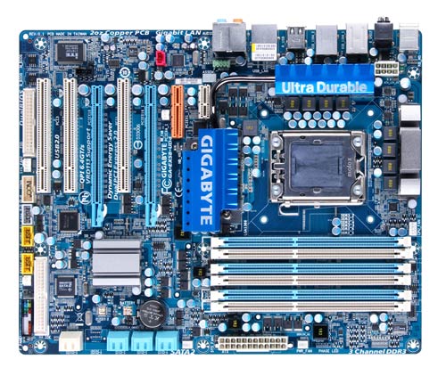

#90
Posted 06 September 2010 - 02:14 PM
Sounds great! I have HD3 with 3 old PCI cards (1 Core and 2 Accel) currently installed in a G5, is there any X58 board that you can recommend for those cards?
Looks like GA-EX58-UD4 is the only X58 with 3 PCI slots:
But there's a PCI Express X16 stuck in between those PCI's, and the length of internal protools cables is quite short...

Posted 07 September 2010 - 10:18 PM
Hi XLR,
Yes, only the UD4 in the EX58 series has 3 PCI slots.
But it will be very hard to get one. It is a bit old, and no one looks to have one.
Do a search.
A friend that was searching that specific model for the very same reason than you ended to purchase a GA-EP45-UD3R. The only problem he had was some conflict with IQRs. He could solve the conflict woking with DSDTSE app.
Do a search.

Posted 15 September 2010 - 03:31 PM
That heatsink may be a problem.
IMHO gigabyte with cartri's bios is the only way to go.
check out the Gigabyte GA-P43-ES3G and buy a few in case.
I have a quite stable system with PCI core and process cards. I got into HaX because I wanted to save $7k
and my old G5 was a dog. I had some kernal panics, but I think they were Network related. My system is in my signature.
