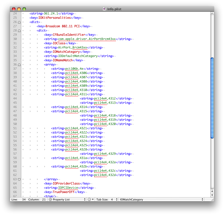

Since it seems to be sort of difficult for new users to edit kext-files, I've written a small script which automatically adds the PCI IDs of all Broadcom wireless cards, which are AirPort compatible.
And this is where I need your feedback: Please post your Broadcom device IDs in this topic, if you have simply added them to the AppleAirPortBrcm4311.kext. Then I can add them to my script so new users can simply download the script and get their Broadcom wireless card to work.
So please post the PCI ID and maybe a little description (at least if the card is 802.11a, b or g).
Note: Only post the PCI ID if you simply have to add the ID to AppleAirPortBrcm4311.kext in order to get it working!

Anybody has progress with Dell Wireless WLAN 1520 Half MiniCard (0x435314E4)? I have AppleAirPortBrcm43224.kext loaded but not network .

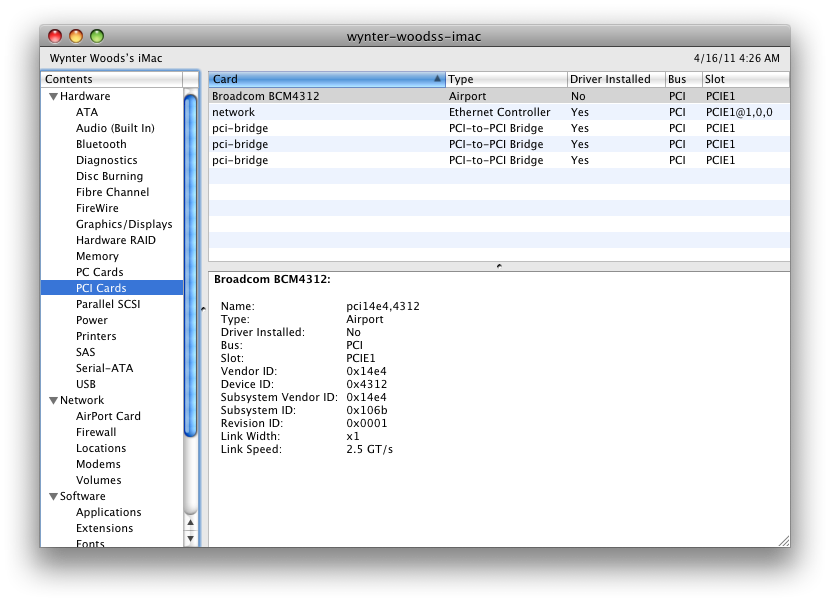

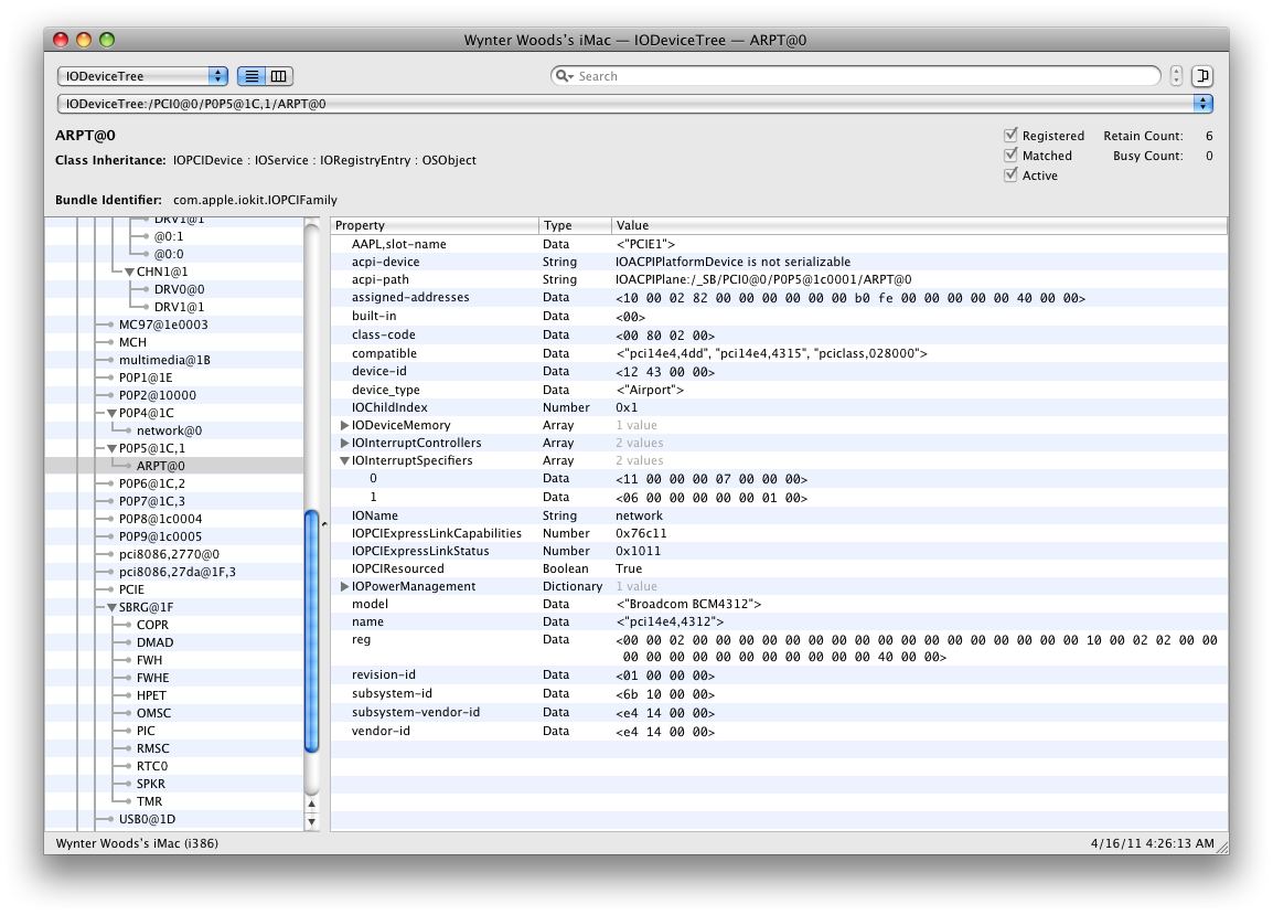

I've been dealing with this issue for a while now. I have a Broadcom 4312 wifi + bluetooth chip attached to the PCI-E slot in my MSI Wind PC (the nettop). After playing around with the DSDT for a while I think I may have gotten OSX to believe my chip is an Airport, but it tells me that there is no driver installed for it. I'm attaching images showing:
1) The system profiler showing the broadcom 4312 listed as an airport
2) The info.plist inside of my broadcom driver kext.
3) IORegistryExplorer open to my bcm4312
As well as the DSDT file I used to achieve this. Note that you should NOT directly use my DSDT as it is specific to my computer. I am putting the DSDT up in case someone with more DSDT knowledge than myself can find a bug in the patch I have made. The change necessary is in P0P5.
Any thoughts as to how to get OSX to know that the driver IS installed?
EDIT: I should also mention that the Bluetooth portion of the card is working, so it's not that the card isn't turned on or receiving power. Bluetooth has worked right out of the box, but wifi has had issues.
Thanks for your answer. Unfortunately, I do not know much about editing DSDT. I thought the kext was available for your card.
zerotri,
So far I was able to repeat your steps. I also edited my DSDT and got brcm43224 listed in system profiler, but no driver loaded. I also flashed my card with free firmware according to ubuntu forum
http://ubuntuforums.org/archive/index.php/t-1617380.html
After this the card was redetected in windows and linux, but no change in osx. If somebody can modify this free firmware for osx...
