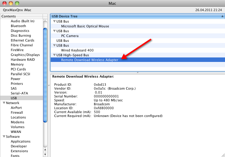

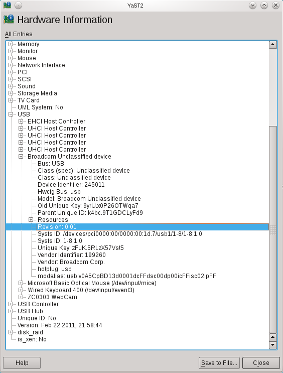

Hi my friends ;)
Usb device web site: http://www.airties.com/product-details.asp...ers&dil=eng
USB\VID_0A5C&PID_BD13&REV_0001
http://www.pcidatabase.com/search.php?vend...r_search=Search
BCM4323 Intensi-fi® XLR Single-Chip 802.11n USB Solution
I installed the iAtkos S3 v2 on my computer. I have not changed a setting in any phase of installation. So I did the installation with the current settings. But usb wireless device does not work. Thank you in advance for your help. Best regards.
I have yours same adapters and problems!! can anyone help us??
