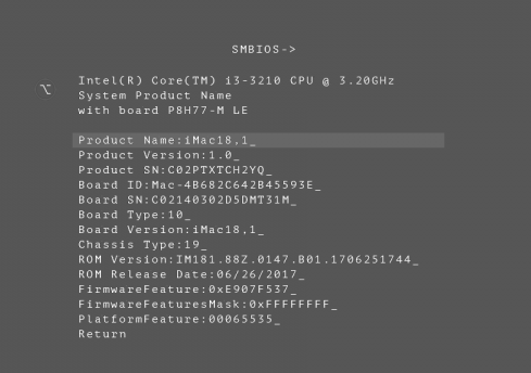

1.Bootloader version r4092
2.FF 0xE97F537
3.FFM 0XFFFFFFFF
4.BIOSROM IM181.88Z.0147.B01.1706251744
PlatfromFeature: 00065535

I've been doing some more tests and I'm glad to tell you that with clover 4092, iMac18,1 SMBIOS with BIOS version:IM181.88Z.0147.B01.1706251744 BIOS Release Date: 06/26/2017 I was able to install macOS High Sierra DP 2 Update 1 with no problem, No OSInstall.mpkg error with all of my other Hard Disk Drives attached and with having clover installed on the EFI partition on all other hard disks.
Whoaa..  :wub:but if I'm using @cyberdev's r4092 (BOOT.efi && CLOVERX64.efi only) together with iMac18,1 SMBIOS with BIOS version:IM181.88Z.0147.B01.1706251744 BIOS Release Date: 06/26/2017, I always get this awesome red on black "RIP" logs; right b4 clover bootscreen appears. Fyi, my working SMBios should to be MBP10,1. Even if I got boot with iMac 18,1, I can't see my Graphics (GF119) to works (blackcreen). I'm using Legacy-GPT scheme; trying Install macOS 10.13 Beta DP1. Couldn't get any log.. hmmmb.

i saw it. but there is no difference in both 4092 and 4101.
i said
1.FF 0xE97F537 - same(4092,4097,4101)
2.FFM 0XFFFFFFFF - same(4092,4097,4101)
3.BIOSROM IM181.88Z.0147.B01.1706251744 - in r4092, use dp1 bios rom info, i just updated bios rom info followed beta2 up1 in 4101. (4092=4097, 4101)
4.PlatfromFeature: same(4092,4097,4101)

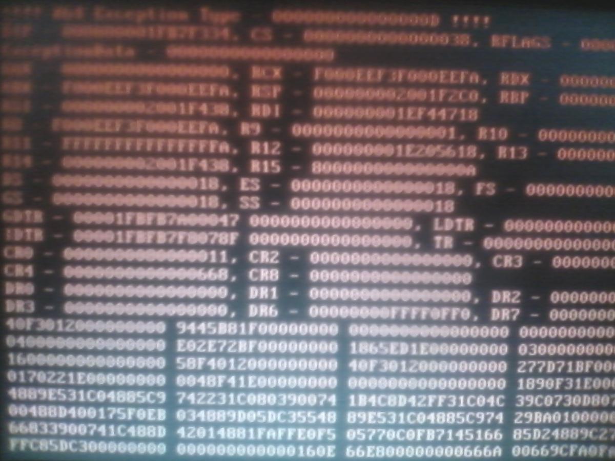

Ok but the sad thing is that I just can't use the 4101 on my Ivy Bridge because of the freezing problem and unfortunately I don't have any other system at my disposal right now to test it.
But I will test the clover that Badruzeus sent me tomorrow to see if it makes any difference. I will check with both iMac17,1 and iMac18,1 later to see if I still get frozen.
Same for me with FakeCPUID 0x0306A0 for my G1840 celeron

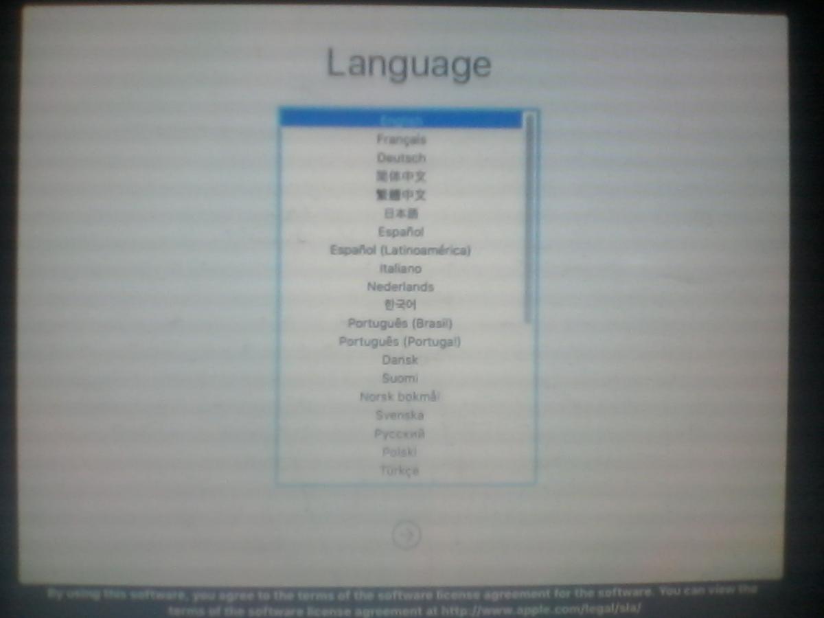

Hi @Sherlocks, for report only..
I recently use Enoch r2885 (Test_Version) for trying 10.13 DP1 from USB, it boots just fine begun with "Language Selection Menu" (afaik this menu doesn't appear if using Clover). Just thinking that I could bypass the issue.. but unfortunately it also gives same "OSInstall.mpkg" error message after clicking next button below.  :lol:. What different is I placed "/System/Library/Kernels/kernel" (since Enoch / Chameleon ask this). OFC, using a working SMBios from Sierra & below versions (MBP10,1), and also 2017 Platform Datas (iMac18,1 Bios Version & Release date too, etc). But it doesn't make a sense.
The only test I didn't try yet is plugging out my SATA drive since (looks like) another OSes inside it cause problem, or another reasons. Thanks
