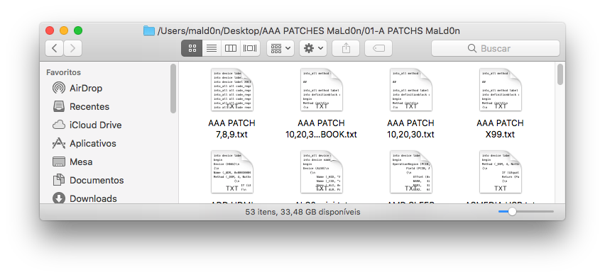

What patches do you apply to the DSDT via MacIASL for 8 series motherboards ? If you're apply other patcher from other sources can you give a me link ?
Thanks !
all patches is here
2007/2012
http://www.insanelymac.com/forum/topic/235523-dsdt-auto-patcher/
i just create others, update some

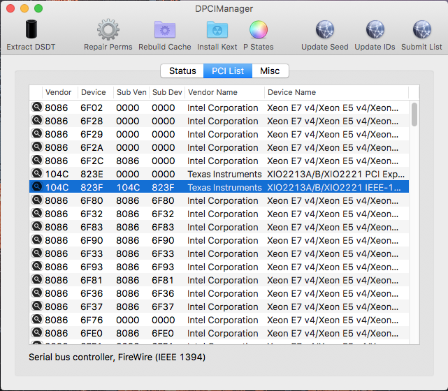

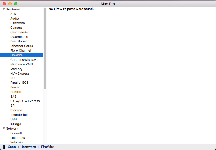

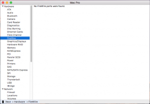

Thank you MaLd0n. The only component that isn't listed (and not seen) is the firewire............ :(
but is listed with DPCIManager
Do you know why?
Do you know why?

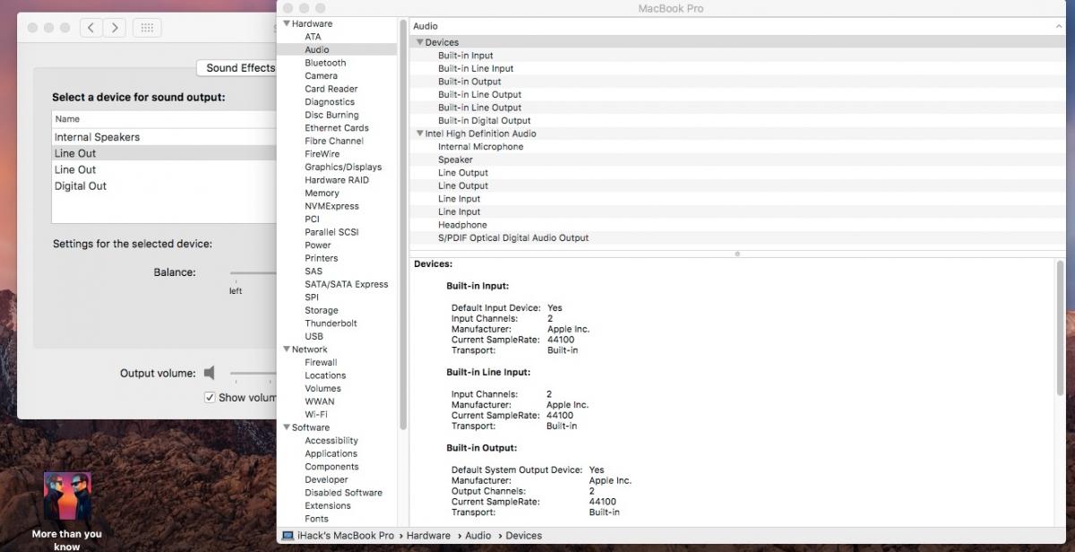

clean install Sierra (again) always stuck in bios after changing CLOVER folder, I will more carefully with this one. :rolleyes:
finally I can boot using my old config.plist (again) and add your DSDT.aml. after restart it detect in SystemReport but still no sound/mic

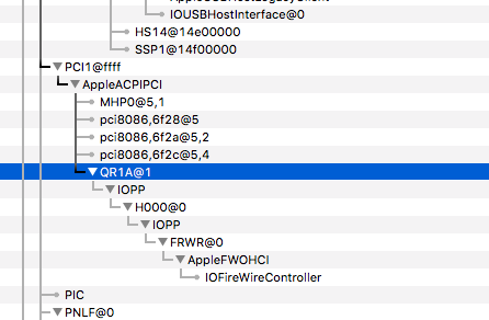

firewire is load
dont work if u connect device?
run it again and send me with new files
attachicon.gifRunMe.app.zip
i don't apply nothing in firewire, just create a missing device
I tried to change slots and now it works perfectly. It was not seen on any slot assigned to cpu2.
Evidently OSX want only the slots assigned to cpu1.
Thank you for your help :)
u need try other layout-id
