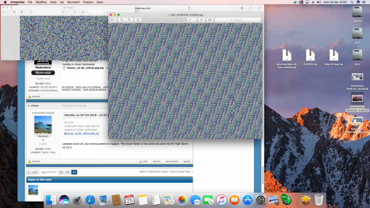

vinpo Posted February 24, 2018 Share Posted February 24, 2018 all is ok u test with other usb3 device? Update ur clover bootloader Clover_v2.4k_r4416.pkg.zip updated clover efi, but nothing seems to happen. The clover folder is the same you send me for High Sierra 10.13.3 On opening some pictures something strange happens... there's no image, only freeze! 1 Link to comment https://www.insanelymac.com/forum/topic/323052-guide-el-capitan-sierra-high-sierra-mojave-catalina-on-intel-5-6-7-8-9-chipset-series-nehalem-sandybridge-ivybridge-haswell-broadwell/page/46/#findComment-2597183 Share on other sites More sharing options...

MaLd0n Posted February 25, 2018 Author Share Posted February 25, 2018 updated clover efi, but nothing seems to happen. The clover folder is the same you send me for High Sierra 10.13.3 On opening some pictures something strange happens... there's no image, only freeze! look like a video problem But which one? Already tried some of the combinations, but with no luck so far. need a test 1 Link to comment https://www.insanelymac.com/forum/topic/323052-guide-el-capitan-sierra-high-sierra-mojave-catalina-on-intel-5-6-7-8-9-chipset-series-nehalem-sandybridge-ivybridge-haswell-broadwell/page/46/#findComment-2597231 Share on other sites More sharing options...

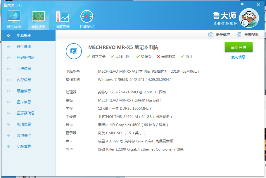

dandinggeL Posted February 26, 2018 Share Posted February 26, 2018 Hey big bro, if you have free time, do me a favour , that will be appreciate... my laptop is running 10.11.6, and I installed 10.12.6 a few days ago, I use same DSDT and SSDT files, most problems had been resolved,,,but the wake still exist since 10.11.6, I know little about DSDT, I installed with a set of EFI of another boy,,,we are using a same mode, I try to inject EDID with Clover,,,failed,,, Problem: sleep-> sleep light flash (OK) -> wake up ... black screen...reboot( after 1 minute) and forgive my poor English ( CET 4 failed) files.zip Time stamp Domain Message Duration Delay ========== ====== ======= ======== ===== UUID: 14C65C20-FD24-4D3F-AE4B-22B031809BD6 2018-02-26 11:35:48 +0000 Notification Display is turned off 2018-02-26 11:35:48 +0000 Assertions Kernel Idle sleep preventers: -None- 2018-02-26 11:35:48 +0000 Assertions PID 53(powerd) Created InternalPreventSleep "com.apple.powermanagement.darkwakelinger" 00:00:00 id:0x0xd000004c5 [system: SRPrevSleep kCPU] 2018-02-26 11:36:03 +0000 Assertions PID 53(powerd) TimedOut InternalPreventSleep "com.apple.powermanagement.darkwakelinger" 00:00:15 id:0x0xd000004c5 [system: SRPrevSleep kCPU] 2018-02-26 11:36:03 +0000 Sleep Entering Sleep state due to 'Clamshell Sleep': Using AC (Charge:100%) 0 secs 2018-02-26 11:36:03 +0000 Assertions PID 53(powerd) Created InternalPreventSleep "PM configd - Wait for Device enumeration" 00:00:00 id:0x0xd000004d5 [system: BGTask SRPrevSleep kCPU] 2018-02-26 11:36:03 +0000 DarkWake DarkWake [CDN] due to /HID Activity: Using AC (Charge:100%) 1 secs 2018-02-26 11:36:03 +0000 Assertions PID 53(powerd) Created InternalPreventSleep "com.apple.powermanagement.acwakelinger" 00:00:00 id:0x0xd000004d6 [system: BGTask SRPrevSleep kCPU] 2018-02-26 11:36:03 +0000 Assertions Kernel Idle sleep preventers: IODisplayWrangler 2018-02-26 11:36:03 +0000 Notification Display is turned on 2018-02-26 11:36:04 +0000 Wake DarkWake to FullWake [CDNVA] due to HID Activity: Using AC (Charge:100%) 27 secs 2018-02-26 11:36:04 +0000 Kernel Client Acks Delays to Wake notifications: [AppleHDADriver driver is slow(msg: SetState to 1)(435 ms)] [CodecCommanderPowerHook driver is slow(msg: SetState to 2)(523 ms)] 2018-02-26 11:36:15 +0000 Assertions PID 53(powerd) Released InternalPreventSleep "PM configd - Wait for Device enumeration" 00:00:11 id:0x0xd000004d5 [system: BGTask SRPrevSleep kCPU] 2018-02-26 11:36:31 +0000 PM Client Acks Delays to Wake notifications: [com.apple.apsd timed out(28000 ms)] 2018-02-26 11:36:31 +0000 Assertions PID 92(mDNSResponder) Created MaintenanceWake "mDNSResponder:maintenance" 00:00:00 id:0x0xd000004e4 [system: BGTask SRPrevSleep kCPU] Sleep/Wakes since boot at 2018-02-26 09:00:15 +0000 :0 Dark Wake Count in this sleep cycle:1 Time stamp Domain Message Duration Delay ========== ====== ======= ======== ===== UUID: 61DCBD88-04E9-40D3-ACEF-F9C36E3177DA 2018-02-26 11:36:31 +0000 Sleep Entering DarkWake state due to 'Clamshell Sleep': Using AC (Charge:100%) 2018-02-26 11:36:31 +0000 Assertions PID 53(powerd) Created InternalPreventSleep "com.apple.powermanagement.darkwakelinger" 00:00:00 id:0x0xd000004e8 [system: BGTask SRPrevSleep IPushSrvc kCPU] 2018-02-26 11:36:31 +0000 Assertions PID 92(mDNSResponder) Released MaintenanceWake "mDNSResponder:maintenance" 00:00:00 id:0x0xd000004e4 [system: BGTask SRPrevSleep IPushSrvc kCPU] 2018-02-26 11:36:33 +0000 Notification Display is turned off 2018-02-26 11:36:33 +0000 Assertions PID 53(powerd) Summary InternalPreventSleep "com.apple.powermanagement.darkwakelinger" 00:00:02 id:0x0xd000004e8 [system: SRPrevSleep IPushSrvc kCPU] 2018-02-26 11:36:33 +0000 Assertions PID 53(powerd) Summary InternalPreventSleep "com.apple.powermanagement.acwakelinger" 00:00:29 id:0x0xd000004d6 [system: SRPrevSleep IPushSrvc kCPU] 2018-02-26 11:36:33 +0000 Assertions PID 77(apsd) Summary InteractivePushServiceTask "com.apple.apsd-wakeconnection-push.apple.com" 00:00:02 id:0x0x12000004e5 [system: SRPrevSleep IPushSrvc kCPU] 2018-02-26 11:36:33 +0000 Assertions Kernel Idle sleep preventers: -None- 2018-02-26 11:36:46 +0000 Assertions PID 53(powerd) TimedOut InternalPreventSleep "com.apple.powermanagement.darkwakelinger" 00:00:15 id:0x0xd000004e8 [system: SRPrevSleep IPushSrvc kCPU] 2018-02-26 11:36:46 +0000 Summary- [system: SRPrevSleep IPushSrvc kCPU] Using AC(Charge: 100) 2018-02-26 11:36:49 +0000 Assertions PID 53(powerd) TimedOut InternalPreventSleep "com.apple.powermanagement.acwakelinger" 00:00:45 id:0x0xd000004d6 [system: SRPrevSleep IPushSrvc kCPU] 2018-02-26 11:36:49 +0000 Summary- [system: IPushSrvc] Using AC(Charge: 100) 2018-02-26 11:36:49 +0000 Sleep Entering Sleep state due to 'Clamshell Sleep': Using AC (Charge:100%) 2018-02-26 11:36:49 +0000 Assertions PID 77(apsd) Released InteractivePushServiceTask "com.apple.apsd-keepalive-push.apple.com" 00:00:10 id:0x0x12000004f1 [system: IPushSrvc] 2018-02-26 11:40:03 +0000 BatteryHealth Battery health: Check Battery Sleep/Wakes since boot at 2018-02-26 09:00:15 +0000 :0 Dark Wake Count in this sleep cycle:0 Time stamp Domain Message Duration Delay ========== ====== ======= ======== ===== UUID: (null) 2018-02-26 11:40:04 +0000 Start powerd process is started 2018-02-26 11:40:04 +0000 Summary- [system: No Assertions] Using AC(Charge: 100) 2018-02-26 11:40:04 +0000 Assertions Kernel Idle sleep preventers: IODisplayWrangler 2018-02-26 11:41:07 +0000 Assertions PID 42(UserEventAgent) Released BackgroundTask "com.apple.metadata.mds_stores.power" 00:01:01 id:0x0xb00000135 [system: PrevIdle BGTask] 2018-02-26 11:41:17 +0000 Assertions PID 42(UserEventAgent) Released BackgroundTask "com.apple.metadata.mds.power" 00:01:11 id:0x0xb00000134 [system: PrevIdle BGTask] 2018-02-26 11:41:17 +0000 Assertions PID 334(AddressBookSourceSync) Released PreventUserIdleSystemSleep "Address Book Source Sync" 00:01:00 id:0x0x1000001a6 [system: BGTask] 2018-02-26 11:41:17 +0000 Assertions PID 273(UserEventAgent) Released BackgroundTask "com.apple.AddressBook.ScheduledSync" 00:01:00 id:0x0xb000001a7 [system: BGTask] 2018-02-26 11:41:46 +0000 Assertions PID 77(apsd) Released ApplePushServiceTask "com.apple.apsd-login" 00:01:32 id:0x0xb00000162 [system: IPushSrvc] Sleep/Wakes since boot at 2018-02-26 11:40:04 +0000 :0 Dark Wake Count in this sleep cycle:0 Time stamp Domain Message Duration Delay ========== ====== ======= ======== ===== UUID: FFF7AD7C-C1B0-4325-8718-DEEB042AB6B9 2018-02-26 11:42:32 +0000 Notification Display is turned off 2018-02-26 11:42:32 +0000 Assertions Kernel Idle sleep preventers: -None- 2018-02-26 11:42:32 +0000 Assertions PID 53(powerd) Created InternalPreventSleep "com.apple.powermanagement.darkwakelinger" 00:00:00 id:0x0xd00000203 [system: SRPrevSleep kCPU] 2018-02-26 11:42:47 +0000 Assertions PID 53(powerd) TimedOut InternalPreventSleep "com.apple.powermanagement.darkwakelinger" 00:00:15 id:0x0xd00000203 [system: SRPrevSleep kCPU] 2018-02-26 11:42:47 +0000 Sleep Entering Sleep state due to 'Software Sleep pid=97': Using AC (Charge:100%) 2018-02-26 11:43:15 +0000 PM Client Acks Delays to Sleep notifications: [com.apple.apsd timed out(28000 ms)] 2018-02-26 12:43:45 +0000 BatteryHealth Battery health: Check Battery Sleep/Wakes since boot at 2018-02-26 11:40:04 +0000 :0 Dark Wake Count in this sleep cycle:0 1 Link to comment https://www.insanelymac.com/forum/topic/323052-guide-el-capitan-sierra-high-sierra-mojave-catalina-on-intel-5-6-7-8-9-chipset-series-nehalem-sandybridge-ivybridge-haswell-broadwell/page/46/#findComment-2597867 Share on other sites More sharing options...
MaLd0n Posted February 26, 2018 Author Share Posted February 26, 2018 Hey big bro, if you have free time, do me a favour , that will be appreciate... my laptop is running 10.11.6, and I installed 10.12.6 a few days ago, I use same DSDT and SSDT files, most problems had been resolved,,,but the wake still exist since 10.11.6, I know little about DSDT, I installed with a set of EFI of another boy,,,we are using a same mode, I try to inject EDID with Clover,,,failed,,, Problem: sleep-> sleep light flash (OK) -> wake up ... black screen...reboot( after 1 minute) and forgive my poor English ( CET 4 failed) files.zip Feb 26 11:40:08 Ones-MacBook-Pro loginwindow[97]: IASGetCurrentInstallPhaseList: no install phase array set Feb 26 11:40:08 Ones-MacBook-Pro loginwindow[97]: IASGetCurrentInstallPhase: no install phase set Feb 26 11:40:11 Ones-MacBook-Pro softwareupdate_firstrun_tasks[91]: Host swscan.apple.com isReachable = YES Feb 26 11:40:15 Ones-MacBook-Pro installd[325]: installd: Starting Feb 26 11:40:15 Ones-MacBook-Pro installd[325]: installd: uid=0, euid=0 Feb 26 11:40:35 Ones-MacBook-Pro softwareupdate_notify_agent[441]: AssertionMgr: Take com.apple.softwareupdate.NotifyAgentAssertion assertion with type BackgroundTask for pid 441 Feb 26 11:40:35 Ones-MacBook-Pro softwareupdate_notify_agent[441]: Running for LoginDone Feb 26 11:40:35 Ones-MacBook-Pro softwareupdate_notify_agent[441]: Waiting 1 seconds before sending the notification to App Store Feb 26 11:40:36 Ones-MacBook-Pro softwareupdated[442]: softwareupdated: Starting with build 10.11.6 (15G31) Feb 26 11:40:36 Ones-MacBook-Pro softwareupdated[442]: /Library/Bundles does not exist - watching for directory creation Feb 26 11:40:36 Ones-MacBook-Pro softwareupdated[442]: BackgroundActivity: Activity check-in with Interval 21600 Feb 26 11:40:36 Ones-MacBook-Pro softwareupdated[442]: Adding client SUUpdateServiceClient pid=441, uid=501, installAuth=NO rights=(), transactions=0 (/System/Library/CoreServices/Software Update.app/Contents/Resources/softwareupdate_notify_agent) Feb 26 11:40:36 Ones-MacBook-Pro softwareupdate_notify_agent[441]: Notifying with params: { AutomaticCheckDisabled = 1; UpdateNotificationsOnly = 1; } Feb 26 11:40:36 Ones-MacBook-Pro softwareupdate_notify_agent[441]: appstoreupdateagent notified Feb 26 11:40:36 Ones-MacBook-Pro softwareupdated[442]: Removing client SUUpdateServiceClient pid=441, uid=501, installAuth=NO rights=(), transactions=0 (/System/Library/CoreServices/Software Update.app/Contents/Resources/softwareupdate_notify_agent) Feb 26 11:40:37 Ones-MacBook-Pro softwareupdate_notify_agent[441]: All notifications finished - exiting Feb 26 11:40:37 Ones-MacBook-Pro softwareupdate_notify_agent[441]: AssertionMgr: Cancel com.apple.softwareupdate.NotifyAgentAssertion assertion for pid 441 Feb 26 11:40:41 Ones-MacBook-Pro softwareupdate_firstrun_tasks[91]: BuildTagCache: Building tag cache if necessary using catalog host swscan.apple.com Feb 26 11:40:41 Ones-MacBook-Pro softwareupdated[442]: Adding client SUUpdateServiceClient pid=91, uid=200, installAuth=NO rights=(), transactions=0 (/System/Library/CoreServices/Software Update.app/Contents/Resources/softwareupdate_firstrun_tasks) Feb 26 11:40:41 Ones-MacBook-Pro softwareupdated[442]: BuildTagCache: Cache is current Feb 26 11:40:41 Ones-MacBook-Pro softwareupdate_firstrun_tasks[91]: BuildTagCache: Finished Feb 26 11:40:41 Ones-MacBook-Pro softwareupdated[442]: Removing client SUUpdateServiceClient pid=91, uid=200, installAuth=NO rights=(), transactions=0 (/System/Library/CoreServices/Software Update.app/Contents/Resources/softwareupdate_firstrun_tasks) send me a full files run it and wait finish RunMe.app.zip 1 Link to comment https://www.insanelymac.com/forum/topic/323052-guide-el-capitan-sierra-high-sierra-mojave-catalina-on-intel-5-6-7-8-9-chipset-series-nehalem-sandybridge-ivybridge-haswell-broadwell/page/46/#findComment-2597871 Share on other sites More sharing options...

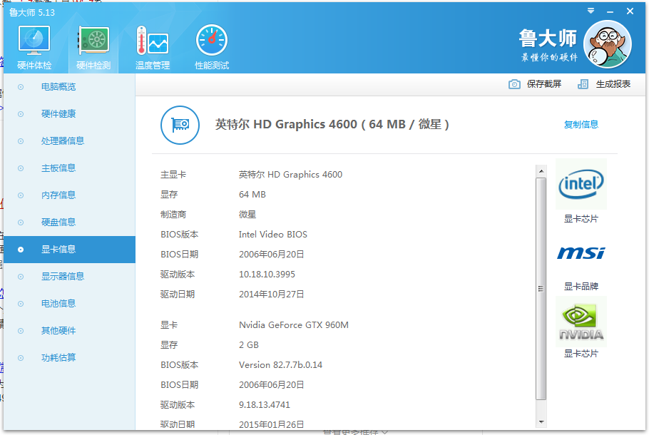

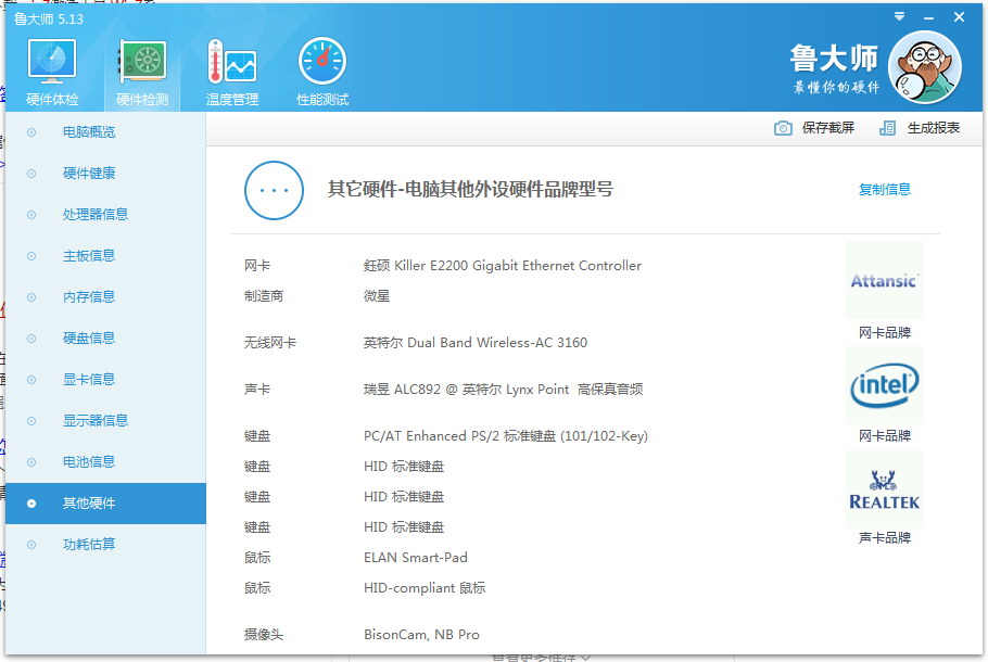

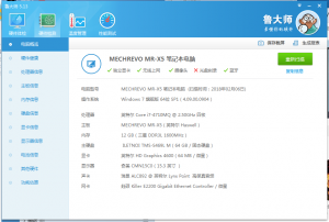

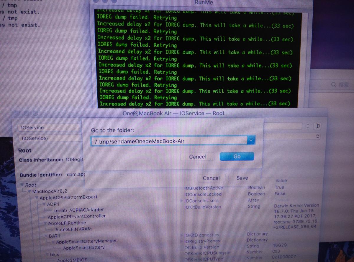

dandinggeL Posted February 26, 2018 Share Posted February 26, 2018 Run it in 10.11.6... Send me Ones-MacBook-Pro.zip Sorry , I am outside for lunch just now My device information ... and screen EDID CMN15C0.txt But something wrong when I run in 10.12.6 1 Link to comment https://www.insanelymac.com/forum/topic/323052-guide-el-capitan-sierra-high-sierra-mojave-catalina-on-intel-5-6-7-8-9-chipset-series-nehalem-sandybridge-ivybridge-haswell-broadwell/page/46/#findComment-2597883 Share on other sites More sharing options...
MaLd0n Posted February 26, 2018 Author Share Posted February 26, 2018 Run it in 10.11.6... Send me Ones-MacBook-Pro.zip Sorry , I am outside for lunch just now My device information ... and screen EDID QQ截图20180206133910.png 其他.png QQ截图20180206144150.png CMN15C0.txt But something wrong when I run in 10.12.6QQ20180226-0.jpg ur notebook have a two gpus? CLOVER.zip stay with USB Stick for tests 1 Link to comment https://www.insanelymac.com/forum/topic/323052-guide-el-capitan-sierra-high-sierra-mojave-catalina-on-intel-5-6-7-8-9-chipset-series-nehalem-sandybridge-ivybridge-haswell-broadwell/page/46/#findComment-2597893 Share on other sites More sharing options...
dandinggeL Posted February 26, 2018 Share Posted February 26, 2018 Yes,,, HD4600 and GTX 960M 1 Link to comment https://www.insanelymac.com/forum/topic/323052-guide-el-capitan-sierra-high-sierra-mojave-catalina-on-intel-5-6-7-8-9-chipset-series-nehalem-sandybridge-ivybridge-haswell-broadwell/page/46/#findComment-2597983 Share on other sites More sharing options...

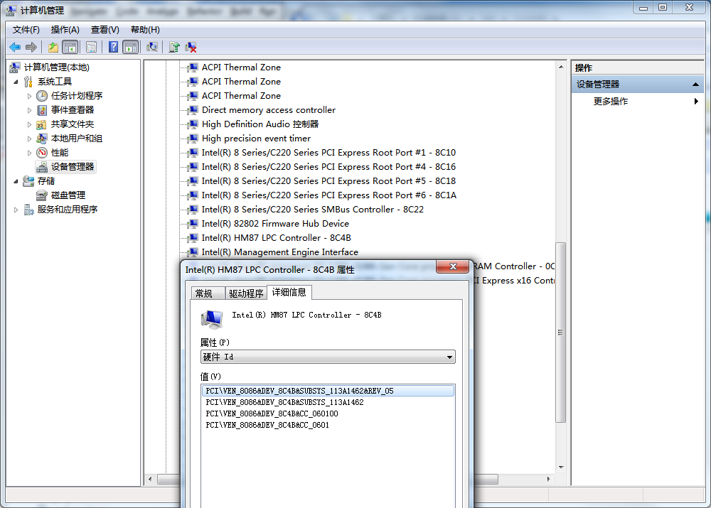

MaLd0n Posted February 26, 2018 Author Share Posted February 26, 2018 Yes,,, HD4600 and GTX 960M 显卡.png what device u disable DGPU? PEG0/PEGP? 2 Link to comment https://www.insanelymac.com/forum/topic/323052-guide-el-capitan-sierra-high-sierra-mojave-catalina-on-intel-5-6-7-8-9-chipset-series-nehalem-sandybridge-ivybridge-haswell-broadwell/page/46/#findComment-2598027 Share on other sites More sharing options...
dandinggeL Posted February 26, 2018 Share Posted February 26, 2018 DGPU? PEG0/PEGP?。。。I dont known this ,efi folder was copied from another bro,,,we are the same mode ,all hardware,.,sorry and another bad news。。。my system broke down ,,,I deleted 10.11.6 then installed 10.12.6,,,so , I thought I still have to trouble you , sorry maybe that bro had disabled, 1 Link to comment https://www.insanelymac.com/forum/topic/323052-guide-el-capitan-sierra-high-sierra-mojave-catalina-on-intel-5-6-7-8-9-chipset-series-nehalem-sandybridge-ivybridge-haswell-broadwell/page/46/#findComment-2598069 Share on other sites More sharing options...
