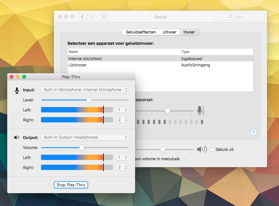

Quinzie XO Posted September 18, 2017 Share Posted September 18, 2017 @Quinzie XO, @Chris1111, @ricoc90 and all other Optiplex 790 users. Try this with Lilu 1.1.7: trial_new_Codec_Optiplex790_LayoutID16.zip Front Mic now as internal Mic with boost 3. Back Mic as LineIn with Boost 3. LayoutID 16 (10) DSDT/HDEF: "layout-id", Buffer (0x04) { 0x10, 0x00, 0x00, 0x00 }, Whats the default layout ID in the DSDT.aml for Optiplex 790 in post 1 ? Thanks - Quinzie Link to comment Share on other sites More sharing options...

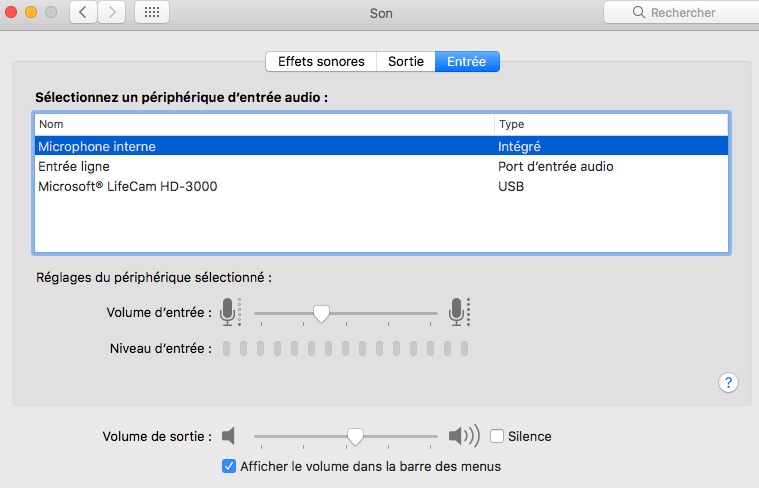

chris1111 Posted September 18, 2017 Share Posted September 18, 2017 @Quinzie XO, @Chris1111, @ricoc90 and all other Optiplex 790 users. Try this with Lilu 1.1.7: trial_new_Codec_Optiplex790_LayoutID16.zip Front Mic now as internal Mic with boost 3. Back Mic as LineIn with Boost 3. LayoutID 16 (10) DSDT/HDEF: "layout-id", Buffer (0x04) { 0x10, 0x00, 0x00, 0x00 }, Works Thank you Show as Internal Mic I record a little track for you MacPeet The best.m4a.zip 4 Link to comment Share on other sites More sharing options...

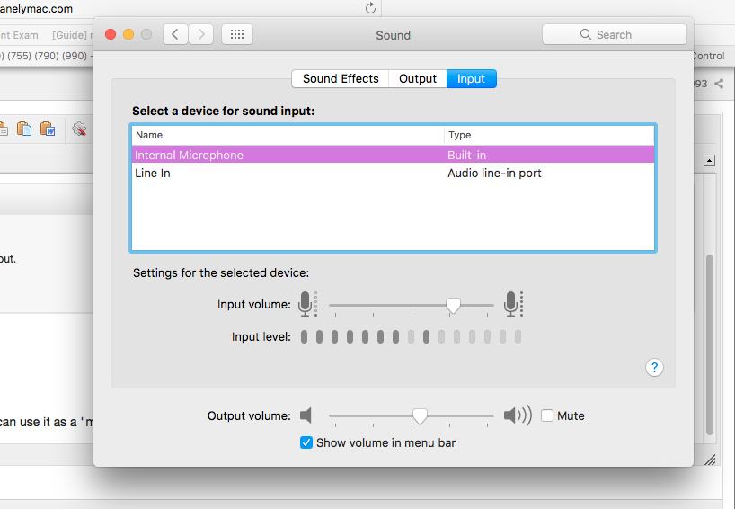

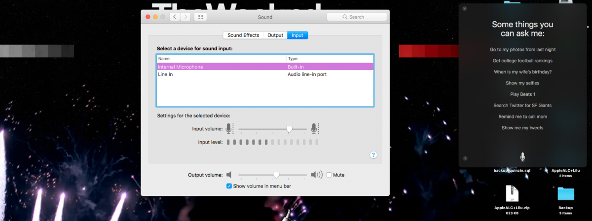

Quinzie XO Posted September 19, 2017 Share Posted September 19, 2017 DSDT.aml.zip Edit: You also have to test the Trial AppleALC from Post # 1075 with the new DSDT. Until now no download from you. Then please do not say, it does not go! So ive tried to but alas no dice! Im still having the same problem! Since it works for rico I'm beginning to think it might be a problem with my board ? I mean it works in Windows! And now its like it hears my voice but just not enough! I have attached a screen shot - Quinzie Link to comment Share on other sites More sharing options...
chris1111 Posted September 19, 2017 Share Posted September 19, 2017 So ive tried to but alas no dice! Im still having the same problem! Since it works for rico I'm beginning to think it might be a problem with my board ? I mean it works in Windows! And now its like it hears my voice but just not enough! I have attached a screen shot - Quinzie Did you try in Front 1 Link to comment Share on other sites More sharing options...
Quinzie XO Posted September 19, 2017 Share Posted September 19, 2017 Did you try in Front I tried both back and front! Then whenever I try to say anything to Siri, its as if she didn't hear me lol - Quinzie Link to comment Share on other sites More sharing options...
Guest ricoc90 Posted September 19, 2017 Share Posted September 19, 2017 I tried both back and front! Then whenever I try to say anything to Siri, its as if she didn't hear me lol - Quinzie Yeah... women, huh?! How's it with other apps? Download soundsource for example, it's a little app that plays back sound input. Like I said, for me both my mic ports are working, though Siri only receives input from the front port. Link to comment Share on other sites More sharing options...
chris1111 Posted September 19, 2017 Share Posted September 19, 2017 Preferance System/Siri Settings like thats Yes Siri not working also here with this setup, but Microphonne works with my old setup and my Life cam its work Link to comment Share on other sites More sharing options...
Guest ricoc90 Posted September 19, 2017 Share Posted September 19, 2017 @Chris1111 Yup, but for me the port on the back has the exact same issue as Quinzie XO. Either Siri doesn't hear me at all, or wrong (for example, when I say "everything okay?", Siri will respond with "Who do you want to call?". It's like the sound input is too noizy for Siri to make something of it, while in other apps the sound input is completely fine. But Again, this is only when the mic is connected to the back port. Siri works fine when the mic is connected to the front port. Link to comment Share on other sites More sharing options...
chris1111 Posted September 19, 2017 Share Posted September 19, 2017 @Chris1111 Yup, but for me the port on the back has the exact same issue as Quinzie XO. Either Siri doesn't hear me at all, or wrong (for example, when I say "everything okay?", Siri will respond with "Who do you want to call?". It's like the sound input is too noizy for Siri to make something of it, while in other apps the sound input is completely fine. But Again, this is only when the mic is connected to the back port. Siri works fine when the mic is connected to the front port. With a my Cam @Chris1111 Yup, but for me the port on the back has the exact same issue as Quinzie XO. Either Siri doesn't hear me at all, or wrong (for example, when I say "everything okay?", Siri will respond with "Who do you want to call?". It's like the sound input is too noizy for Siri to make something of it, while in other apps the sound input is completely fine. But Again, this is only when the mic is connected to the back port. Siri works fine when the mic is connected to the front port. Not here even with my Cam, I need roll back my DSDT and AppleALC for make it work Siri with the Life Cam Link to comment Share on other sites More sharing options...
Quinzie XO Posted September 19, 2017 Share Posted September 19, 2017 @Chris1111 Yup, but for me the port on the back has the exact same issue as Quinzie XO. Either Siri doesn't hear me at all, or wrong (for example, when I say "everything okay?", Siri will respond with "Who do you want to call?". It's like the sound input is too noizy for Siri to make something of it, while in other apps the sound input is completely fine. But Again, this is only when the mic is connected to the back port. Siri works fine when the mic is connected to the front port. Hahah so I'm the only that has nothing working looool. Sadness. But let me check other apps and see if it works. Yeah... women, huh?! How's it with other apps? Download soundsource for example, it's a little app that plays back sound input. Like I said, for me both my mic ports are working, though Siri only receives input from the front port. Schermafbeelding 2017-09-19 om 03.11.57.png On it!!! Im doing that right now and getting back to your with the results! - Quinzie EDIT: Tested and this is weird. With Sounsource, if I speak in to the right earpiece then it I can use it as a "mic" i.e. I here my self. But if the right ear piece is in my ear and I talk, then I can't hear my self as much. Super weird though. And also, right now there is no mic connected but the internal input seems to be getting some kind of static input. Ive attached a screenshot. Link to comment Share on other sites More sharing options...

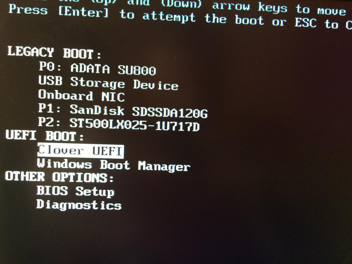

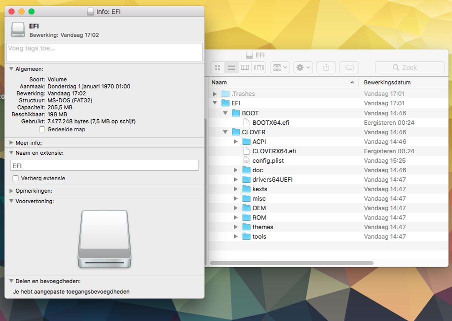

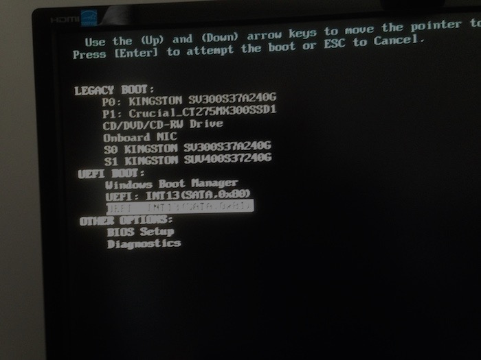

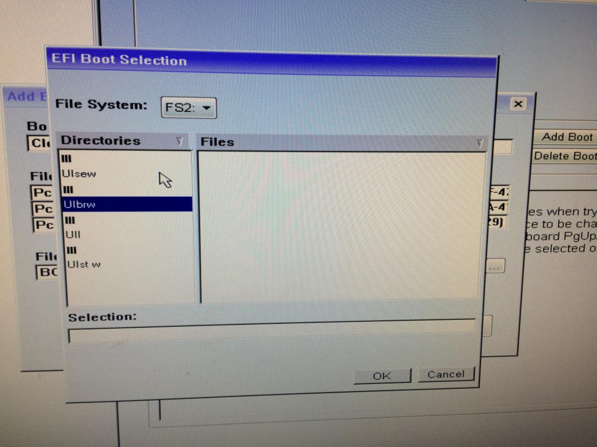

Guest ricoc90 Posted September 19, 2017 Share Posted September 19, 2017 @Chris1111: [since this isn't really a High Sierra issue I'll post it here]I formatted a FAT32 USB and put Clover on it. Changed BIOS mode to UEFI, wanted to add the boot entry for Clover but that indeed made my BIOS freeze.After a reboot I was able to add the boot entry, but it wouldn't let me select the bootfile (text was unreadable and unselectable).I manually pointed to \EFI\CLOVER\CLOVERX64.efi, as well as \EFI\BOOT\BOOTX64.efi but the result was the same: Clover was unbootable. So I guess Clover in UEFI won't work on our machine? Link to comment Share on other sites More sharing options...

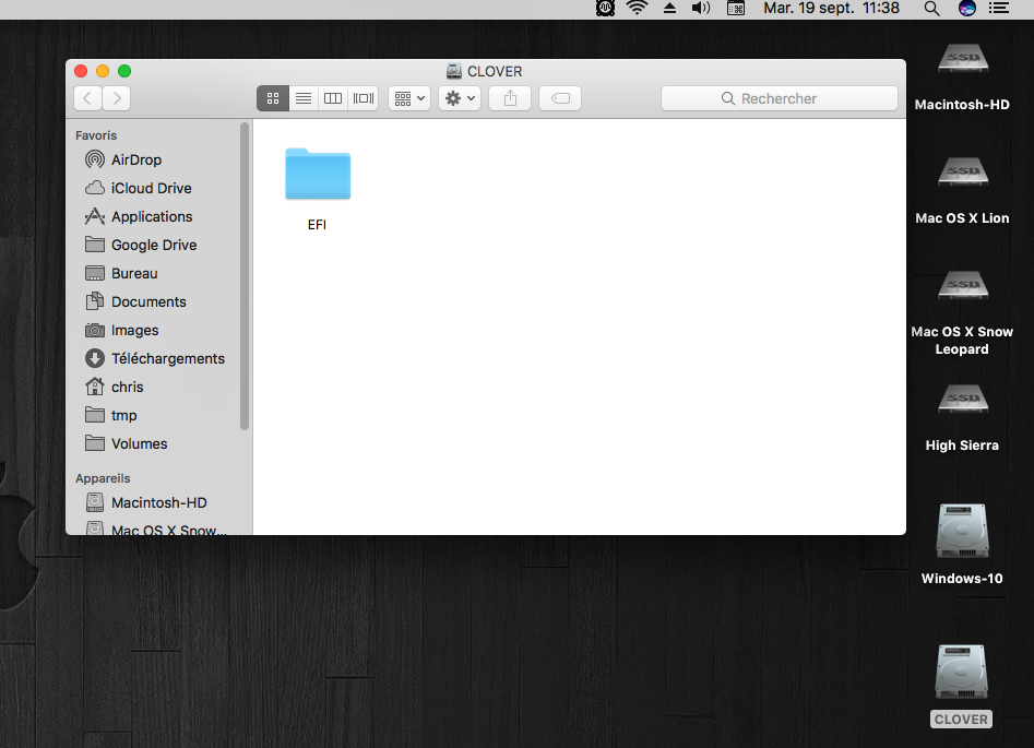

chris1111 Posted September 19, 2017 Share Posted September 19, 2017 @Chris1111: [since this isn't really a High Sierra issue I'll post it here] I formatted a FAT32 USB and put Clover on it. Changed BIOS mode to UEFI, wanted to add the boot entry for Clover but that indeed made my BIOS freeze. After a reboot I was able to add the boot entry, but it wouldn't let me select the bootfile (text was unreadable and unselectable). I manually pointed to \EFI\CLOVER\CLOVERX64.efi, as well as \EFI\BOOT\BOOTX64.efi but the result was the same: Clover was unbootable. So I guess Clover in UEFI won't work on our machine? IMG_0340.JPG IMG_0343.JPG Its work ! Enable UEFI your only have to select USB storage Device in the list If I remember correctly The UEFI entry is ad by default after Also your only to ad A default Volume UEFI to Boot Link to comment Share on other sites More sharing options...
Guest ricoc90 Posted September 19, 2017 Share Posted September 19, 2017 Its work ! Enable UEFI your only have to select USB storage Device in the list If I remember correctly The UEFI entry is ad by default after But then it's under Legacy boot options. Clover does not show up in the UEFI boot list if I don't add it manually... When I do add it manually, it doesn't boot (screen stays just black) Link to comment Share on other sites More sharing options...

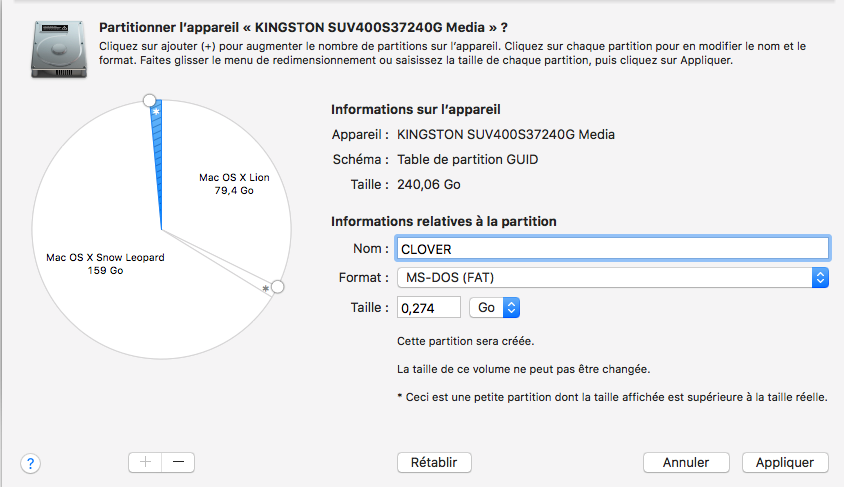

chris1111 Posted September 19, 2017 Share Posted September 19, 2017 But then it's under Legacy boot options. Clover does not show up in the UEFI boot list if I don't add it manually... When I do add it manually, it doesn't boot (screen stays just black) Schermafbeelding 2017-09-19 om 17.02.18.png Ok better like that Create a small Fat 32 Part , name CLOVER on any SSD you have Put your EFi Folder on CLOVER fat 32 Partition See Picture Enable UEFI and you have new Entry by default Just boot This is my CLOVER EFI Fat 32 Partition EDIT ****** I had tested it a few months ago already, its work good But I disable the UEFI because I did not find it stable after my bios is freeze Link to comment Share on other sites More sharing options...
