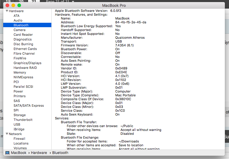

After adding this AR9485 kext file wifi is working fine on OSx el capitan. In Bluetooth preference panel if i search any device like android phone, iPhone, Bluetooth head set wont appears in panel.
how to do get appear a device in Bluetooth preference panel ??

answer for abhinasia  fix your USB port,  copy iousbhostfamily.kext on your desktop and modify iousbhostfamily.kext/content/plugin/appleusbehcipci.kext/content/info.plist defending your dsdt port  after that install iousbhostfamily.kext alongside usbinjectall.kext in /S/L/E I m sure that will work
my bluetooth is working 100%

Thank you..
I have already change the port number all ports are USB 2.0 but did not change number like Usbconnector 0 to 225 which means internal connector  that Bluetooth and camera are connected. Need to change that number to get work ??
