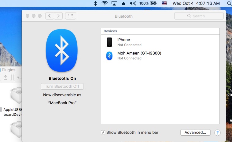

ameenjuz Posted October 4, 2017 Share Posted October 4, 2017 answer for abhinasia fix your USB port, copy iousbhostfamily.kext on your desktop and modify iousbhostfamily.kext/content/plugin/appleusbehcipci.kext/content/info.plist defending your dsdt port after that install iousbhostfamily.kext alongside usbinjectall.kext in /S/L/E I m sure that will work my bluetooth is working 100% Link to comment https://www.insanelymac.com/forum/topic/312045-atheros-wireless-driver-os-x-101112-for-unsupported-cards/page/17/#findComment-2507998 Share on other sites More sharing options...

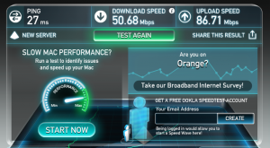

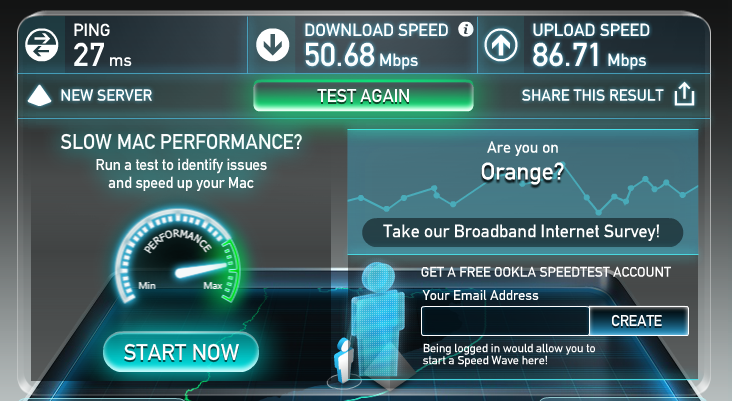

seb30 Posted October 7, 2017 Share Posted October 7, 2017 Hi, i have a AR9485 with your kext on mac os 10.12.6, but the wifi is very slow (-1mega), how to resolve it please? 2 Link to comment https://www.insanelymac.com/forum/topic/312045-atheros-wireless-driver-os-x-101112-for-unsupported-cards/page/17/#findComment-2510944 Share on other sites More sharing options...

seb30 Posted October 18, 2017 Share Posted October 18, 2017 Someone can help me for my slow wifi problem with ath9485 and this kext (v21) pls? Normaly i have 70-80Mbps... 1 Link to comment https://www.insanelymac.com/forum/topic/312045-atheros-wireless-driver-os-x-101112-for-unsupported-cards/page/17/#findComment-2518243 Share on other sites More sharing options...

Apple Hunter Posted October 23, 2017 Share Posted October 23, 2017 In AR9485 WiFi is working fine but Bluetooth panel show ON status scanning device but wont appear device in panel even it wont off. i have tried by adding usbinject.kext and change iousb kext info by adding number 255 for internal not worked same i have created ssdt for USB. added all type of Bluetooth kext then update Os X 10.11.6 to 10.12.6 still same issues. which method will get fix this issues please help ??.. Link to comment https://www.insanelymac.com/forum/topic/312045-atheros-wireless-driver-os-x-101112-for-unsupported-cards/page/17/#findComment-2521198 Share on other sites More sharing options...
seb30 Posted October 23, 2017 Share Posted October 23, 2017 In terminal for completly disable bluetooth: defaults write /Library/Preferences/com.apple.Bluetooth.plist ControllerPowerState 0 1 Link to comment https://www.insanelymac.com/forum/topic/312045-atheros-wireless-driver-os-x-101112-for-unsupported-cards/page/17/#findComment-2521432 Share on other sites More sharing options...
Apple Hunter Posted October 24, 2017 Share Posted October 24, 2017 In terminal for completly disable bluetooth: defaults write /Library/Preferences/com.apple.Bluetooth.plist ControllerPowerState 0 Then it will get work Link to comment https://www.insanelymac.com/forum/topic/312045-atheros-wireless-driver-os-x-101112-for-unsupported-cards/page/17/#findComment-2521669 Share on other sites More sharing options...

Sevillator Posted November 3, 2017 Share Posted November 3, 2017 Someone can help me for my slow wifi problem with ath9485 and this kext (v21) pls? Normaly i have 70-80Mbps... I have the same problem as you. I previously had an atheros AR9380 but I changed it to atheros AR9485 with bluetooth. I have this kext (v16 version) but wifi is too slow in some networks. In my home where I have an ADLS with 10 Mbps and I can get the 10 Mbps. However, in other networks like in the university I only get 1 Mbps or lower, and I should have 60-70Mbps. Also bluetooth is not working fine, every time is switched on and I cant switch it off or connect to other bluetooth devices. Did you find any solution? Thanks :-) Link to comment https://www.insanelymac.com/forum/topic/312045-atheros-wireless-driver-os-x-101112-for-unsupported-cards/page/17/#findComment-2528231 Share on other sites More sharing options...
