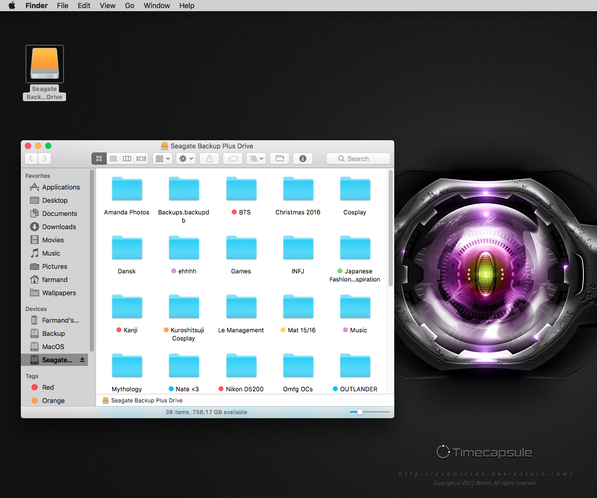

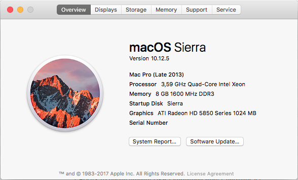

I installed Sierra without any problem, and everything is working apart from USB3 and native Power Management (this one shouldn't be a problem, but I didn't have time to fix it).
USB3 ports give me headaches. They work sort of:
1. When I plug external Usb hard drives they get mounted and they show on the desktop

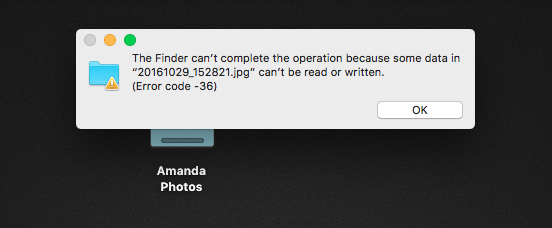

2. I can browse files on the disk, but I can't copy files from and to external hard disk drive
I get this error:

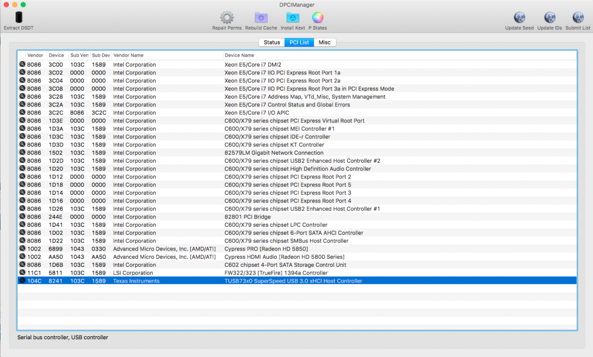

About this Mac:
From DPCI Manager:
And here are my settings from my config.plist :
If anyone here knows how to patch DSDT to get USB3 to work please point me in the right direction.

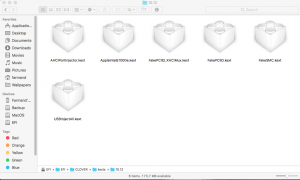

This is for Clover and vanilla Mac OS install (createinstallmedia method).
First part:
1. Do you have the latest BIOS? I can see there is no AHCI option in your BIOS, only RAID+AHCI and IDE.
2. Try to disable Virtualisation Technology (VTx) as well. It is enabled in your BIOS.
Second part:

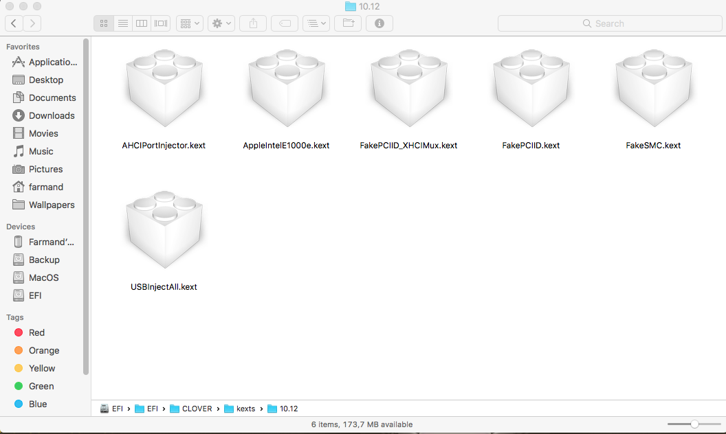

You have definitely problem with USB ports. You have to have these two kexts in you USB/EFI/Clover/kexts/Other folder (or 10.11 if you use 10.11 folder):
FakePCIID_XHCIMux.kext and FakePCIID.kext
Without them you won't be able to boot successfully.
Important: Don't use USB3 port to boot from it. It probably doesn't work properly.
I also have:
USBInjectAll.kext
Here is the screenshot of my EFI/Clover/kexts/Other folder (and I am successfully running Sierra 10.12.5):
Third part:

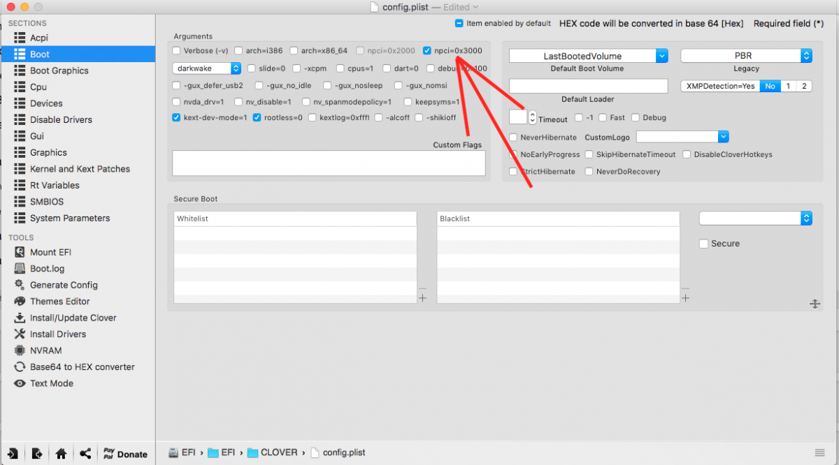

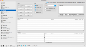

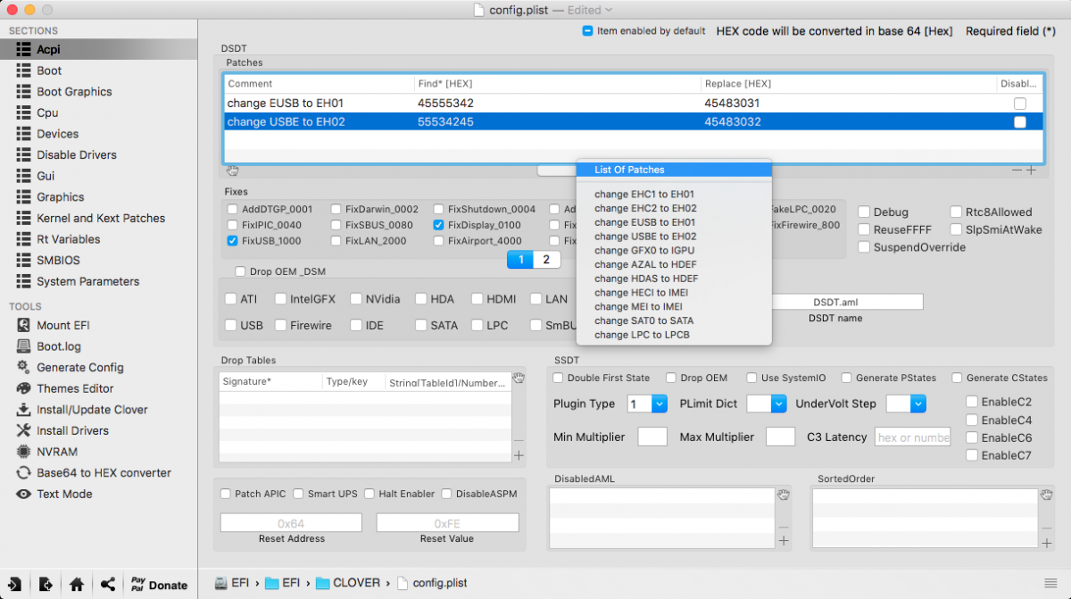

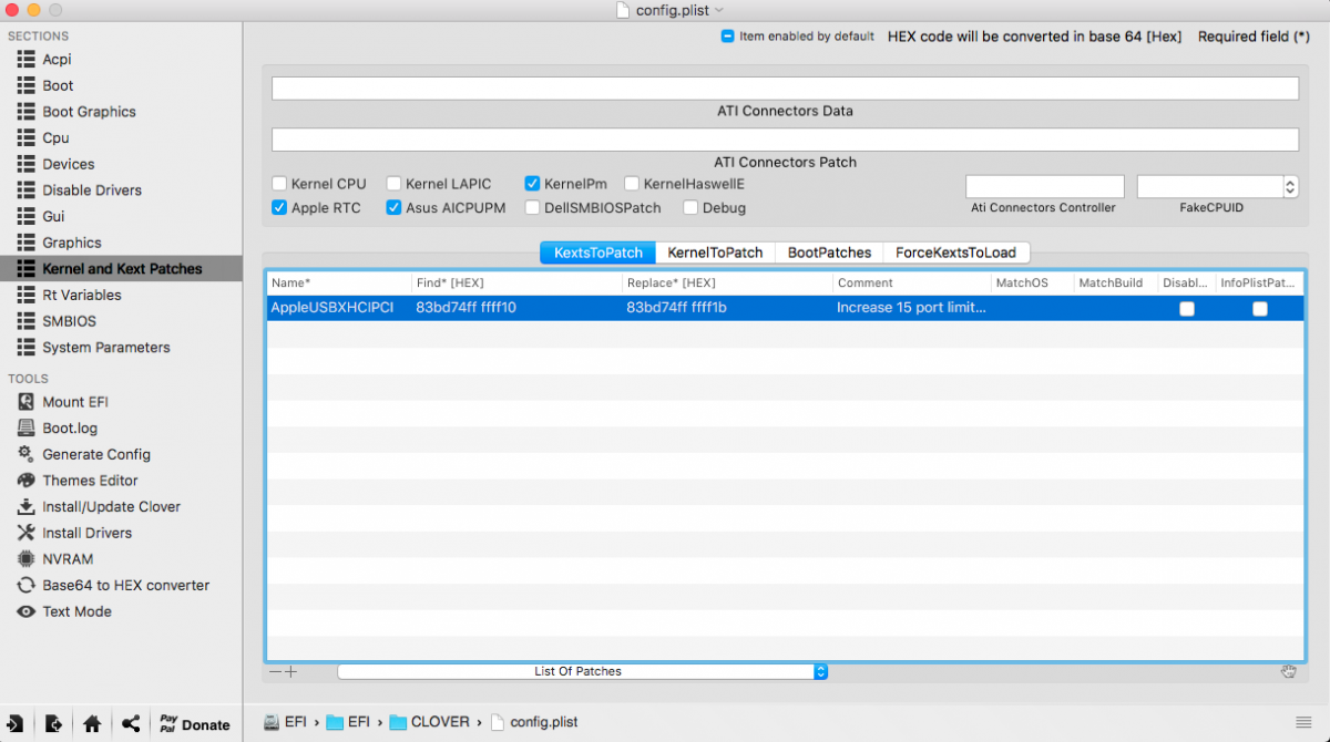

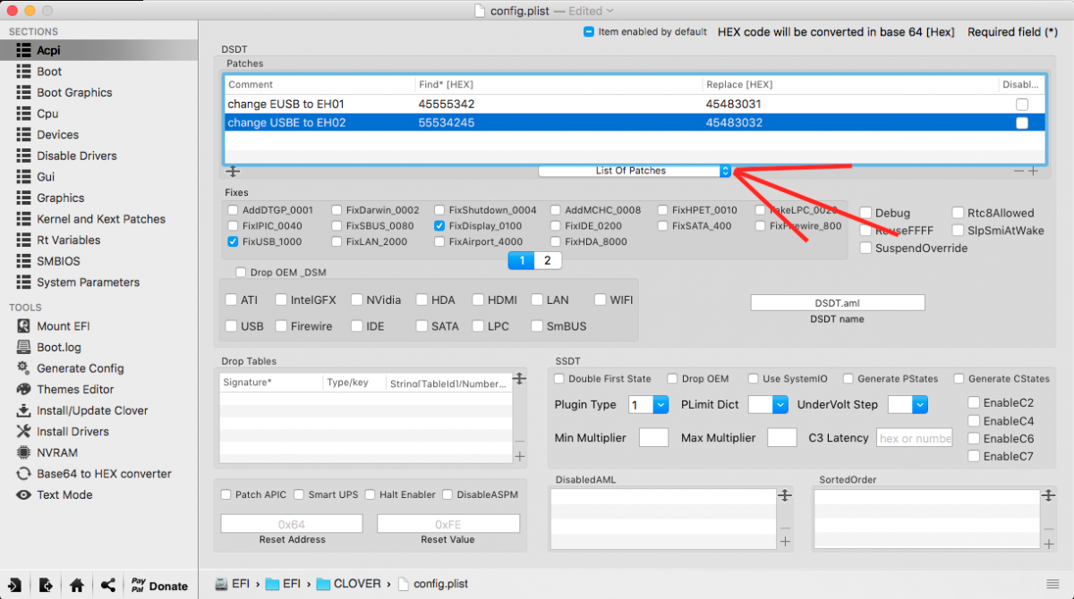

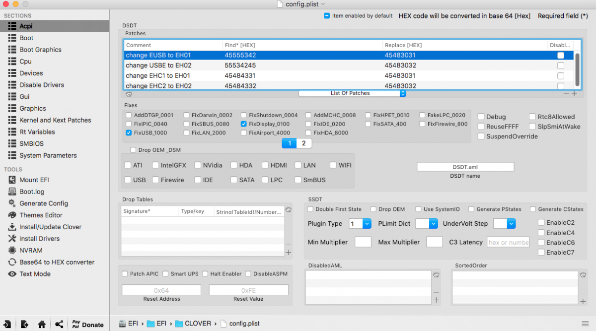

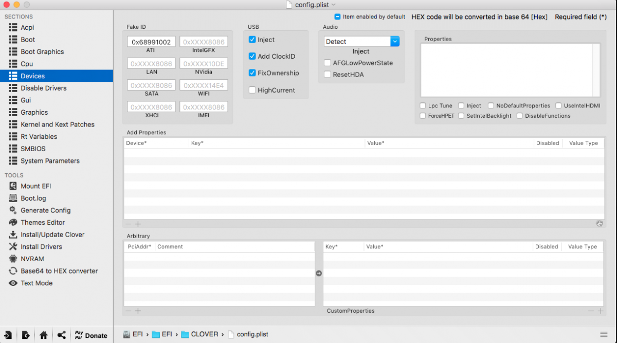

Open your config.plist in Clover Configurator and add these two patches under AHCI tab:

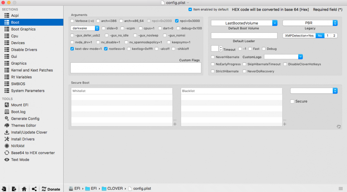

Under Boot tab try to check npci=3000 (I was not able to boot without it):

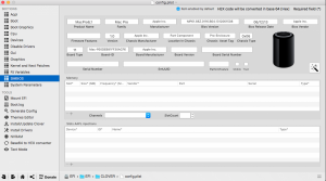

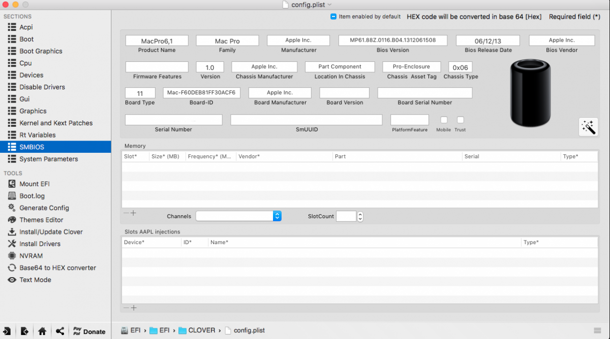

If I were you I would use either MacPro 5.1 or MacPro 6.1 SMBIOS, and not iMac SMBIOS which you are using right now.

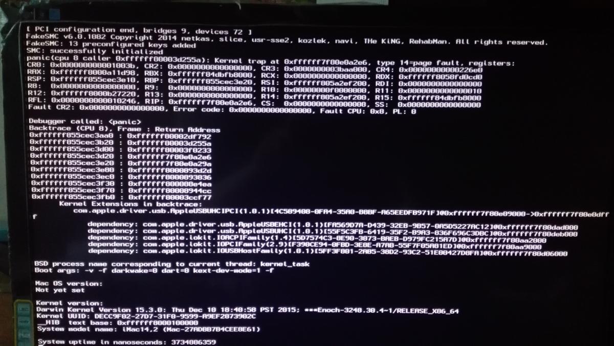

I have some questions regarding the Clover method of getting Sierra and I'd be most grateful if someone would answer them.
Previously when I tried it I couldn't get past this screen (which eventually turned into this). I then gave up and tried Chameleon. I got it to install but it seems like the graphics card won't enable since I can only have two displays and not three. iMessage and FaceTime was also not working, and all guides was pointing to use Clover. I've read a bit on this thread and people seems to be successful.
I have a Z400 Xeon Quad 3.06 GHz (should be Mac Pro 5.1 in SMBIOS, right?) with a GTX 780 (nVidia Web drivers, right?). Now, how would I get past the screen I mentioned above? Is it an USB problem or HDD problem? Perhaps I didn't use the correct kexts (as shown by antialias above) and thus it didn't find the right components? Some in this thread mention that you need a SATA port controller since the installation process will not recognize the hard drives. Have I understood correctly, and in that case, would a SATA to USB adapter work too?
Someone mentioned AHCI mode in BIOS. I'm on version 3.60 and as far as I remember I only have RAID + AHCI, would this be a problem?
Also worth mentioning: if everything works as intended I would like to replace the Windows installation on the SSD and put that on the HDD instead. What boot loader mode should I use in that case? Previously I've used legacy mode but if I replaced Windows would this change to UEFI? Other tips?
Thanks in advance!
Thanks for the links. I managed to get past the other screen.

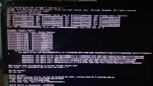

I'm currently stuck at this screen instead. The solution seems to be your comment here. However, I don't really understand. Following the instructions that you linked to, wouldn't that do stuff to the already existing legit Mac of mine (as the terminal is running on my partition)? Where would I enter those values you commentated with? Please do elaborate.
Thanks! I got past the panic error. Now I'm stuck here instead: first it says busy timeout[0], (240s), kextd wait(0): "AppleACPICPU" and then after a while I get past it and one of my monitors become Mac-gray colored while the other is black.
I found this answer, but it is pointing to use the newest Clover, which I am (r4907). Any ideas?

Could it be wrong SMBIOS? The config that kif.007 send used iMac14,2. I'll try replacing it to MacPro5,1 and report back.
