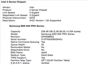

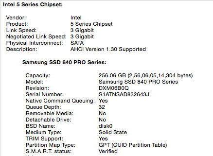

Among others setting I have the following on config.plist KernelAndKextPatches section. However the TRIM Support always set to No.
Until I manually patch the binary using the second method.
I still want to have it patched by Clover if possible. Any idea what is wrong? Clover version is 3055.

That's strange !
I've got the same values in my config.plist with clover 3050 and my two SSD have the TRIM enabled.
Do you have AHCI enable in your bios ? (I'm not sure it's related...)
That's strange !
Thanks for the hint, I reviewed that plist section and there are 2 things:
- one of the key had the value set to False ==> changed to false
- one of the tag was malformed : key> ==> fixed this to <key>
I copied back the original binary, run the kextcache -prelinked-kernel, and reboot, TRIM now is set to YES
