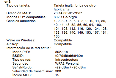

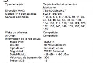

I m using a BCM94322HM8L now, a Dell DW1510. Native support. it works out of the box as the original one. Also  I have ordered a BCM94360HMB that is a wifi/bluetooth card, just to see if i can enable Handoff and Instant Hotspot.
BCM94322HM8L works like a charm. I you need one, just let me know cause I have two more that i´m not using and i can send you one. Also i have the soft to get rid of the white list.

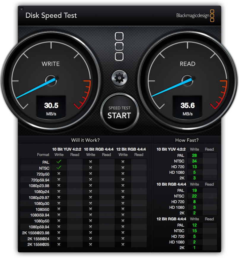

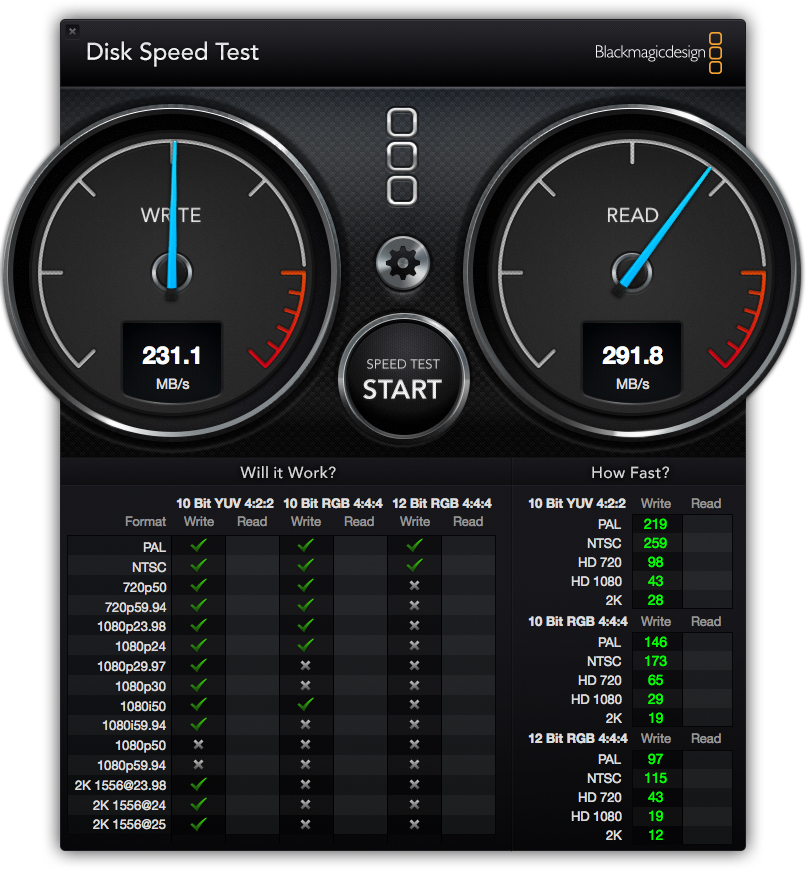

Meanwhile, maybe some other one is interested on this. I had tried with some PCMCIA cards to USB 3.0, patched, and the performance was very poor. I have just received and tried this one, works out of the box, no patches.
http://www.ebay.com/itm/350600627667?ru=http%3A%2F%2Fwww.ebay.com%2Fsch%2Fi.html%3F_from%3DR40%26_sacat%3D0%26_nkw%3D350600627667%26_rdc%3D1
and these are the results, on the the native USB 2.0 and with this card. Tried on my TDK USB 3.0 external SSD. For a few bucks, I think it´s worth.
Hope it helps.
