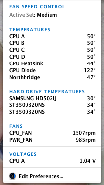

Hi dood,
Now being I have use DSDT by copy from here everything works fine ie. auto+manual sleep and wake up by mouse/keboard/PWRB
but CPU temperature is very high as attached pic and file.
I have tried to modified My own DSDT(extracted via abuntu live CD) by your guide when i used it CPU temp is ok around 50 -60 c but
Auto/Manual Sleep did not work as before.
can you show me your config. and DSDT?
Thanks a lot

I'm unfamiliar with other methods, but I suppose PX40 could be renamed LPCB by the decompiler that howboutjoe used.
It could be named WXYZ and still function, a way to determine the right section is to look for `Name (_ADR, 0x001F0000)'.
Would you attach your base dsdt.dsl?

Thanks for posting your version 2 X58A-UD5 DSDT. Whilst it is a little bit different it is not as far removed as the v2 UD3 board.
For example you still have a Device PX40 not an LPC which is good (most probably)!
I have modded your DSDT with the relevant parts of d00d's guide, with the exception of 16,17 and 18 as they were not needed on my X58A board. If you still have problems sleeping or restarting this can be added back in later. Use Asere 1.1.9 bootloader.
Here's the file:
Attached File  dsdt.aml.zip   6.93KB   39 downloads
