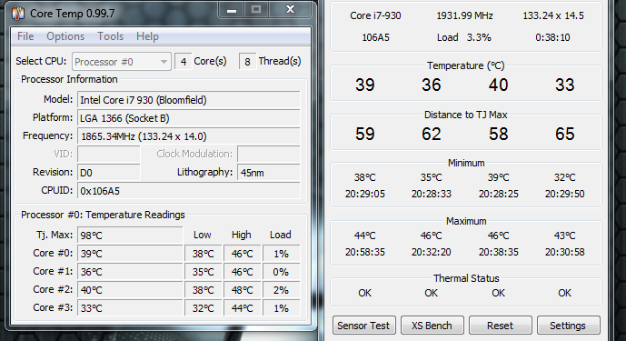

jhrfc Posted June 26, 2010 Share Posted June 26, 2010 Be aware that some of the plug-ins associated with FakeSMC could effect your C-States and increase core temperature. I'm not sure what your hardware setup is but your core temps seem a tad bit high. Check to see if you still have c-states active. Thanks for the reply. My temps don't seem to have increased since i installed the new famkesmc. I'm running a ud5 with the DSDT mods from this thread. I'm currently overclocked to 3.2ghz. I've a nero cooler and even with the prime cpu torture test or an hoor or so I don't get over 90. my setup ud5, i920 @3.2ghz aska nero cooler. Cheers Jon Thanks for the reply. My temps don't seem to have increased since i installed the new famkesmc. I'm running a ud5 with the DSDT mods from this thread. I'm currently overclocked to 3.2ghz. I've a nero cooler and even with the prime cpu torture test or an hoor or so I don't get over 90.my setup ud5, i920 @3.2ghz aska nero cooler. Cheers Jon Link to comment https://www.insanelymac.com/forum/topic/196771-ga-ex58-and-ga-x58a-dsdt-native-power-management-modifications/page/37/#findComment-1499267 Share on other sites More sharing options...

sasta Posted June 27, 2010 Share Posted June 27, 2010 I have everything working great right now. My kernel log shows turbo ratios 111122. My only problem is that even though I overclock my cpu (i980x) I don't see that in my OSX. It just gives me stock numbers 3.33Ghz and geekbench munbers are the same as non overclocked. Do you know why is that ? Link to comment https://www.insanelymac.com/forum/topic/196771-ga-ex58-and-ga-x58a-dsdt-native-power-management-modifications/page/37/#findComment-1499455 Share on other sites More sharing options...

sasta Posted June 28, 2010 Share Posted June 28, 2010 Even though I have patched my dsdt according to your post d00d, my i980x doesn't load c-states ? That's why I guess SL can't load my overclocked settings and "see" my i980x with stock frequency. Any idea how I can force c-states to load? Link to comment https://www.insanelymac.com/forum/topic/196771-ga-ex58-and-ga-x58a-dsdt-native-power-management-modifications/page/37/#findComment-1500237 Share on other sites More sharing options...

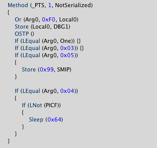

Dajjal Posted June 30, 2010 Share Posted June 30, 2010 Ok guys i seem to be having some fluctuations in temps between windows 7 64 & Snow leopard.I tried the new fakesmc an saw that the voltage is changing so this means that speedsteppin is workin right?,Also Shutdown does not work,First time i tried it the screen came dark an i got the message that u have to hold down your power button ........etc,now it jus hangs.This is my second build an i 'm using Rankrotten's extra folder. Concering the temps, in my previous build i was using CruiSAr's files an Windows an Snow was like 1-2 Degree in difference,but now it's like 8-10 Degrees above windows,What's going on here?Ideas anyone?Here are some screens. Link to comment https://www.insanelymac.com/forum/topic/196771-ga-ex58-and-ga-x58a-dsdt-native-power-management-modifications/page/37/#findComment-1501276 Share on other sites More sharing options...
d00d Posted June 30, 2010 Author Share Posted June 30, 2010 Ok guys i seem to be having some fluctuations in temps between windows 7 64 & Snow leopard.I tried the new fakesmc an saw that the voltage is changing so this means that speedsteppin is workin right?,Also Shutdown does not work,First time i tried it the screen came dark an i got the message that u have to hold down your power button ........etc,now it jus hangs.This is my second build an i 'm using Rankrotten's extra folder. Concering the temps, in my previous build i was using CruiSAr's files an Windows an Snow was like 1-2 Degree in difference,but now it's like 8-10 Degrees above windows,What's going on here?Ideas anyone?Here are some screens.yesDid you do the item 16 shutdown modification? Are you are using Rankrotten's GA-X58A-UD5 extra folder which includes it's DSDT, on your GA-EX58-UD5? If so, that would explain why you are having problems. Interesting like you, I had higher GPU temps up to 57C after sleep when changing to macpro3,1But now after a while and sleeping system a few times without rebooting, gpu temps at idle have reduced Cheers Jon Thanks, I'll try it again if Apple aor NVIDIA doesn't release a fix soon. Link to comment https://www.insanelymac.com/forum/topic/196771-ga-ex58-and-ga-x58a-dsdt-native-power-management-modifications/page/37/#findComment-1501496 Share on other sites More sharing options...

d00d Posted June 30, 2010 Author Share Posted June 30, 2010 @ dood No i'm using his files on the X58A-UD5,On my previous system (EX58-UD5) i used CruiSAr's files. Ok, then does CruiSAr's DSDT have the item 16 shutdown modification? Link to comment https://www.insanelymac.com/forum/topic/196771-ga-ex58-and-ga-x58a-dsdt-native-power-management-modifications/page/37/#findComment-1501615 Share on other sites More sharing options...

Dajjal Posted June 30, 2010 Share Posted June 30, 2010 Ok, then does CruiSAr's DSDT have the item 16 shutdown modification? I used openhaltrestart kext with cruiSAr's DSDT because i was using a 4670 GPU. CruiSAr's DSDT Ramkotten DSDT Link to comment https://www.insanelymac.com/forum/topic/196771-ga-ex58-and-ga-x58a-dsdt-native-power-management-modifications/page/37/#findComment-1501888 Share on other sites More sharing options...
d00d Posted June 30, 2010 Author Share Posted June 30, 2010 My 2 cents. The info is still incomplete (as "GSATA" is some JMB and i dont know which) and i still did not studied the X58A. If you think that this information is irrelevant and redundant, please, ask-me and i should delete it. It is linked to a PNG that will be updated with the same name always, and will in the future include some info only relevant to my project so when / if this time comes, just say so and I will delete it ok?I hope it helps: PS: PEX information for LAN in X58A is not confirmed PS2: About the "groups" : *The UD4P is equal to UD5/Extreme except for the scope for the TPM Security Chip. I made a protest against this (anti)Tech here: UD4P USERS BEAWARE (The chip normally is used only for good purposes in GB boards, but still keeps usable for not so great purposes for some, and as so the UD4P DSDT is overridable by UD5/Extreme. *The Group B has the 2 identical UD3R DSDTs with only IRQ changes to UD4. UD4 allocates one more line to pic/apic in hub0 compared to DS4, it shall make no harm based on many tests did on P45 gigabyte platform. In the end UD3R DSDT can be used as source for all boards in Group B *Group C is really identical, the latest bios dsdt will work for them all. PS3: This is a scrap to be tested, not a rule written on stone. Be welcome to correct and - besides still not having the time to read this thread i will want to compare my ported from p45 dsdts with these tables when they are ready. For now I am working in removing TPM from UD4P, as soon as i have a complete work i can send you the dsdts. PS4: About groupability and lans: having a 2nd addressed Lan device wont hurt those with only one ethernet. PS5: Sorry for editing so many times, if you think this is a not-clean post please say it so so i will remove it. Looks good, keep up the good work!GA-X58A-UD9 has 8111E, not D. I used openhaltrestart kext with cruiSAr's DSDT because i was using a 4670 GPU. I don't see what one has to do with the other, but does adding the item 16 shutdown modification fix it? Link to comment https://www.insanelymac.com/forum/topic/196771-ga-ex58-and-ga-x58a-dsdt-native-power-management-modifications/page/37/#findComment-1502011 Share on other sites More sharing options...

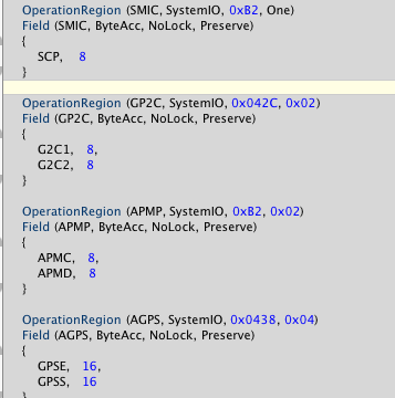

d00d Posted July 6, 2010 Author Share Posted July 6, 2010 In bios the DSDTs of X58As are identicalI saw that GA-X58A-UD7 rev 1.0 and GA-X58A-UD3R rev 1.0 differ in the address base in `Device (PCI0.EXPL)'. Link to comment https://www.insanelymac.com/forum/topic/196771-ga-ex58-and-ga-x58a-dsdt-native-power-management-modifications/page/37/#findComment-1506130 Share on other sites More sharing options...
cartri Posted July 6, 2010 Share Posted July 6, 2010 I saw that GA-X58A-UD7 rev 1.0 and GA-X58A-UD3R rev 1.0 differ in the address base in `Device (PCI0.EXPL)'. Depends on versions. EXPL is wonderlanded to 1458ABCD 1458ABC1 (1458 means gigabyte) in many bioses cause EXPL is the 0c02 post hub adressing device, its responsible for addressing the devices, what is already done by the other 0c02 plug and plays, cause they are basing themselfs that the OS will not use it. On latest versions for: UD3R 1.0 F6j UD3R 2.x FA UD5 1.0 F6i UD5 2.x FA UD7 F7r you should find corrected addresses after gigabyte asking award to fix it. I use F4000000 04000000 for darwin compatibility but the whole chamelleon needs to change in order to correctly address gigabyte, and this device should have much more space, now im using C0000000 (correspondent to Hub0, the pci bridge) as base address but its also not correct as the devices connected to the 1st 2 pegs have address 10000000 and 60000000, the other 2 pegs should get 90000000 and C0000000 (pex0) as bases. but its all wrong. they are fixing it, but you know... award is the chinese work exploitation company of phoenix... we cant expect much. The team changed, at last its minds. sorry for entering your thread PS: changing this addresses only work in bios level, and if chamelleon dont override them later... Link to comment https://www.insanelymac.com/forum/topic/196771-ga-ex58-and-ga-x58a-dsdt-native-power-management-modifications/page/37/#findComment-1506136 Share on other sites More sharing options...
d00d Posted July 7, 2010 Author Share Posted July 7, 2010 Depends on versions. EXPL is wonderlanded to 1458ABCD 1458ABC1 (1458 means gigabyte) in many bioses cause EXPL is the 0c02 post hub adressing device, its responsible for addressing the devices, what is already done by the other 0c02 plug and plays, cause they are basing themselfs that the OS will not use it.On latest versions for: UD3R 1.0 F6j UD3R 2.x FA UD5 1.0 F6i UD5 2.x FA UD7 F7r you should find corrected addresses after gigabyte asking award to fix it. I use F4000000 04000000 for darwin compatibility but the whole chamelleon needs to change in order to correctly address gigabyte, and this device should have much more space, now im using C0000000 (correspondent to Hub0, the pci bridge) as base address but its also not correct as the devices connected to the 1st 2 pegs have address 10000000 and 60000000, the other 2 pegs should get 90000000 and C0000000 (pex0) as bases. but its all wrong. they are fixing it, but you know... award is the chinese work exploitation company of phoenix... we cant expect much. The team changed, at last its minds. sorry for entering your thread PS: changing this addresses only work in bios level, and if chamelleon dont override them later... Thanks, your input is both welcome and valued in this thread. Link to comment https://www.insanelymac.com/forum/topic/196771-ga-ex58-and-ga-x58a-dsdt-native-power-management-modifications/page/37/#findComment-1506154 Share on other sites More sharing options...
