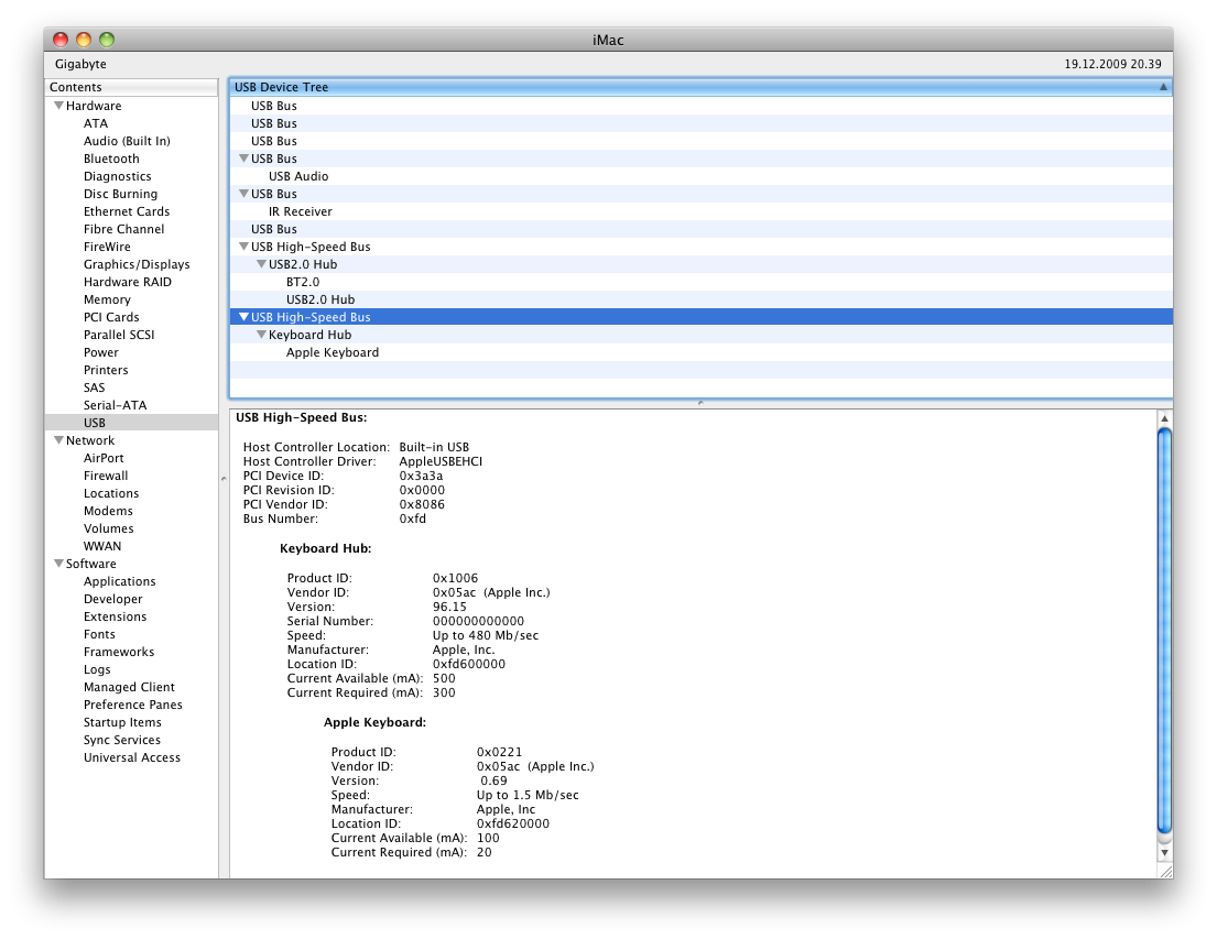

Is it the hub that lets you wake via the keyboard of some DSDT patch?
It's a DSDT patch, my ehci devices now look like this:
Device (EHC1)            {                Name (_ADR, 0x001D0007)                Name (_PRW, Package (0x02){0x0D,0x03})                OperationRegion (PMCR, PCI_Config, 0x52, 0x2F)                Field (PMCR, ByteAcc, NoLock, Preserve)                {                    PMSS,   16,	                Offset (0x2E),                    WRTA,   1                }           }            Device (EHC2)            {                Name (_ADR, 0x001A0007)                Name (_PRW, Package (0x02){0x0D,0x03})                OperationRegion (PMCR, PCI_Config, 0x52, 0x2F)                Field (PMCR, ByteAcc, NoLock, Preserve)                {                    PMSS,   16,	                Offset (0x2E),                    WRTA,   1                }            }
and this is what I added under device LPC
Method (^_INI, 0, NotSerialized)				{					Store (0x01,\_SB.PCI0.EHC1.WRTA)					Store (0xC9C2,\_SB.PCI0.EHC1.PMSS)					Store (0x00,\_SB.PCI0.EHC1.WRTA)								Store (0x01,\_SB.PCI0.EHC2.WRTA)					Store (0xC9C2,\_SB.PCI0.EHC2.PMSS)					Store (0x00,\_SB.PCI0.EHC2.WRTA)				}
Funny thing is that the register that I modified doesn't really do anything, it is only used to show OS capabilities of Ehci device.
WOW! so your aluminum KB is working just by plugging it on a USB hub? mind showing a pic of that 'special' hub hehe? i have two 4-port hub here (Belkin and a chinese brand) and both of them don't work..
i have no problem waking from a wired mouse though may it be connected to a hub or directly to my machine.
No, I meant that now USB2.0 hub connected devices work for wake up, including Apple keyboard

Both work, I can connect my keyboard to a usb hub or directly to motherboard and wake up using it.

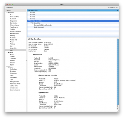

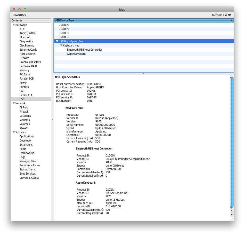

I just got mine working. I got so interested in why USB2.0 hubs wouldn't work that I went out to buy one :P Now I can wake up using both my aluminium keyboard and a mouse connected to powered USB2.0 hub.
The red part might be key here. GigaByte USB hubs are underpowered?
Here we go. Bits 6-8 are the onces I was referring to with being underpowered.
BTW: I would have used PWRC instead of PMCR since that's what it is.
Edit: You don't need register 0x80 when you re-write it a little:
OperationRegion (PWRC, PCI_Config, 0x52, 0x02)
Field (PWRC, ByteAcc, NoLock, Preserve)
		, 6,
	AUXC, 3,  // Auxiliary Current.
		, 7
And then call Store (0x07, AUXC).
