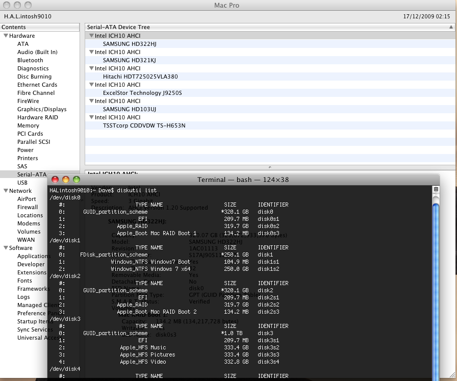

FKA Posted December 17, 2009 Share Posted December 17, 2009 Here is a version I assembled for my GA-EP35-DS4. Give this a whirl. The only extra is my GFX1 card a 512MB 8800GT.dsdt_EP35_DS4_FKA.dsl.zip as we say in Scouse land - Ta La' - works for me! Now Master Jedi- I have an issue that I know effects others - I'm booting a SW RAID (sure this is issue generally) also, my drives keep switching around. mainly my boots are 1s3 and 2s3 (this in it's self is odd as my 2 RAID'd drives are 0 ans 1 in BIOS.) but sometimes I have 0s3 and 2s3 or 3s3 etc etc .. i believe IRQ routing table issue ?? http://www.projectosx.com/forum/index.php?...ic=532&st=0 post14 Sh*t annoying especially if making changes to 2 drives (RAID setup.) and each boot you have too look them up! Appol' for OT and appol' if I've missed a fix. Any ideas? D. Link to comment https://www.insanelymac.com/forum/topic/192518-dsdt-fixes-for-gigabyte-boards/page/34/#findComment-1361629 Share on other sites More sharing options...

FKA Posted December 17, 2009 Share Posted December 17, 2009 @FormelyKnownAs: Is the IRQ assignment different when this happens? As far as I can see no: The 2 samsungs (slightly different models I know - can't truat suppliers these days and couldn't be arsed RMAing!) being my RAID drives. Edit: Good news for TSSTcorp drive owners. Read this! worth a pop ! Link to comment https://www.insanelymac.com/forum/topic/192518-dsdt-fixes-for-gigabyte-boards/page/34/#findComment-1361670 Share on other sites More sharing options...
