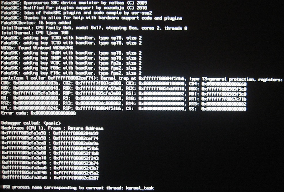

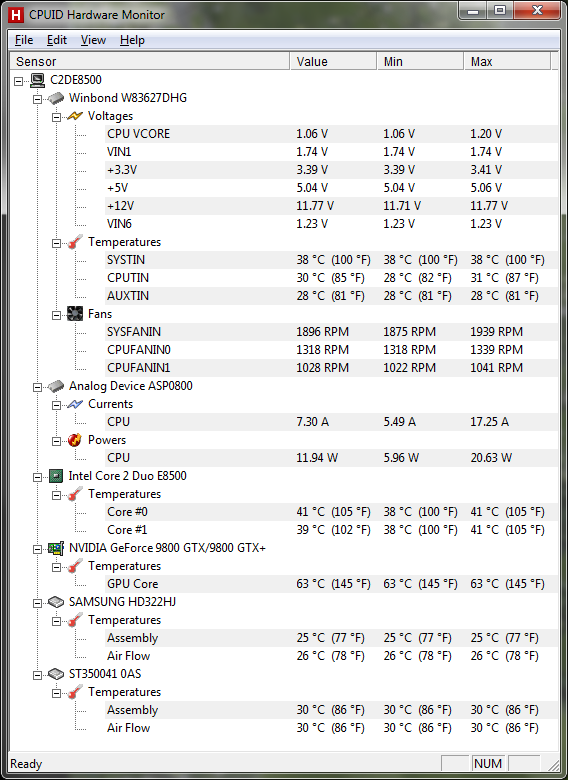

I installed your fakesmc + intelthermal & superio with winbond plugin today.
It works great but AUXTIN and one of my case fans is missing (FAN1 is the CPU fan). Compare with a screenshot of HWMonitor:

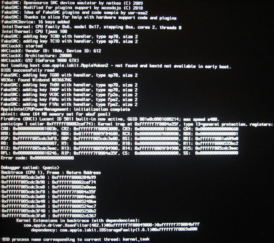

If I add NVClockX I get a kernel panic during boot. The one that doesn't even mention NVClockX was when booting the 10.6.0 install DVD.
Sorry about the quality, there's not enough ambient light here to take good photos in the evening :-)
Nvidia 9800GTX+ on unmodified drivers, motherboard is ASUS P5Q-E.

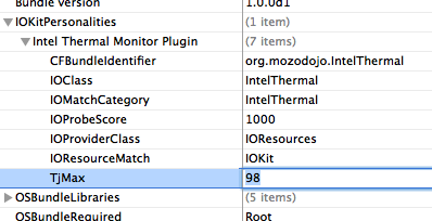

4. IntelThermal trying to autodetect TjMax value. If not using 100. TjMax value could be overriden via info.plist:
