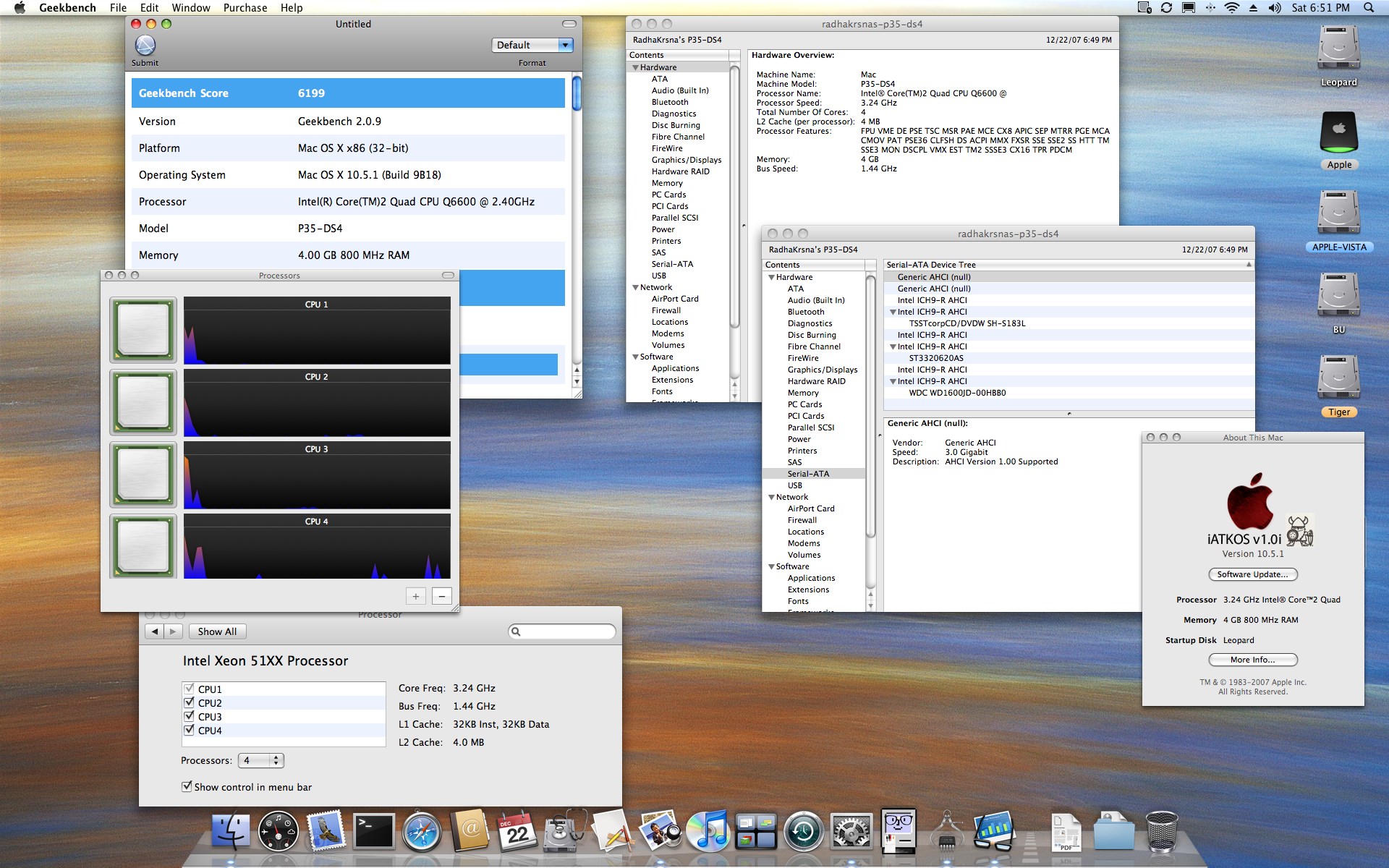

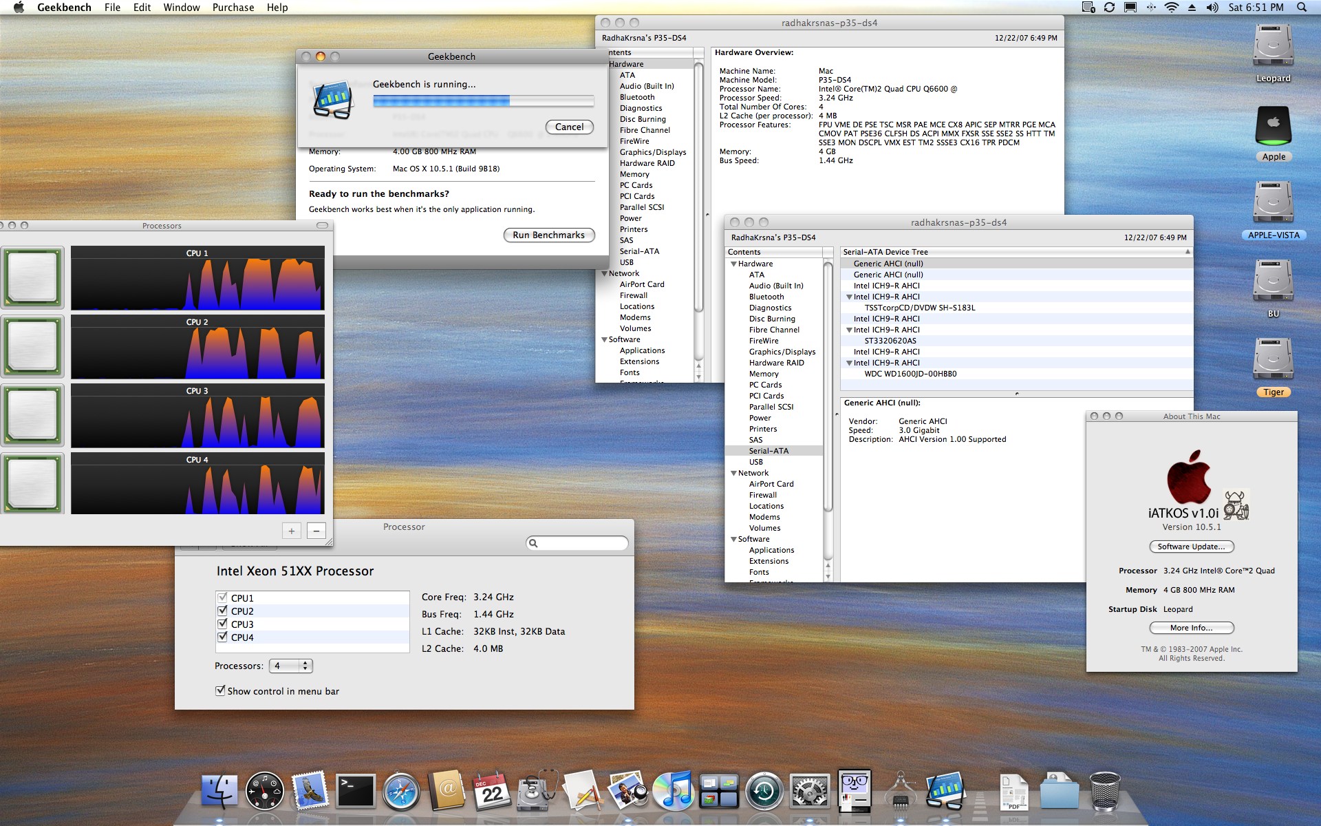

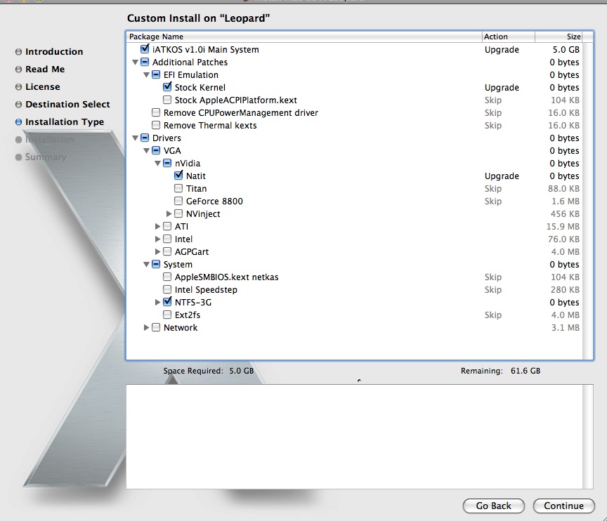

karaakeha1
Posted
First installed 10.4.8 JaS with MBR partition i.e; Leopard
with iATKOS DVD (Disk Utility)again Erased the MBR partition Leopard ( Don't Partition Drive Again)
Run Darwin Script Make sure to enter HDD as 1 Partition 1 for disk0s1
Installed with Main System ,Stock Kernel , Drivers -Natit and NTFS-3G
Bootable Leopard .
Reinstalled the 10.5.1 package (from apple downloads) to make sure EFI installed successfully
System booted after update :)
Sleep ,Time Machine working . NTFS drive working fine Both Read and Write
Four Cores Working fine ,see the picture . From apple Xcodetools Processor prePane See this as Intel Xeon 51XX with Four cores
Didn't installed AppleSMBIOS for netkas. About This mac shows correct Speed , System Profile identified the Correct Processor, Speed and machine Model P35-DS4
Internal Drive icon shows correctly. and Drive shows as internal
P.S Installed Kalyway but internal SATA still shows Yellow as external Drive

anibalin
Posted
@karaakeha1 - hi mate, do you mind posting exactly what drivers/etc you choose at installation? Trully you ended up with a perfect install. Thanks in advance.
