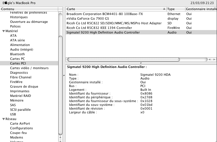

Hi,
First thanks for your answear and for your help !! :(
- Second, I try some of your solution but nothing works :thumbsup_anim:
But I have some idea :
- The only difference with my laptop and your laptop is the release.
two sound kext HDA is the same so I think that the problem don't come to this kext !!!
I use iPC10.5.6 and you no !!
I think you have different kext to me but witch kext ??
Do you think that it can be IOPCIFAMILY ??
I send you a screenshot to my PCI hardware detection, my soundcard is well recognized !!!!

Hi,
First thanks for your answear and for your help !! :)
- Second, I try some of your solution but nothing works :(
OTHER PROBLEM :
+ My USB doesn't mount automatically, I test some iPC patch but witouth result, do you know a good patch ??
Thanks much for your help !!
Egle

Indeed !!
My soundcard problem came to Extension.mkext.
And to solve this problem, I decompiled my mkext file, deleted AppleHDA and rebuild file.
When I reboot, my system load AppleHDA in S/L/E and no in Extra...
So now, my soundcard works very well !!!!
Enjoy 

Chameleon + PC_EFI_V9 boot + hardware support for 10.5.6
Check readme about kexts and features.
V1.4 should be the last build i make. If someone (serious) is interrested to continue and improve this project, PM me.
