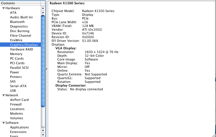

mysoundeditor Posted September 21, 2008 Share Posted September 21, 2008 OK, further still and i think what you told mitch_de will get me thru. I think i may have been wrong in using the DEVID from my PC. It said it was an HD2400 and my software i install on PC is HD2400. But i dug out the box for my card and it is a X1300 after all, so my default install with 10.5.4 set it up correct. I only need to enable to QE quartz extreme. But my system had a natit.kext and natitX1300.kext too are those the two kext you say i shouldnt have. i am just going to read more on the 10.5.x tools i only need to enable Link to comment https://www.insanelymac.com/forum/topic/94090-how-to-ati-radeon-hd-2400-2600-2900-3850-3870-on-leopard/page/13/#findComment-899478 Share on other sites More sharing options...
