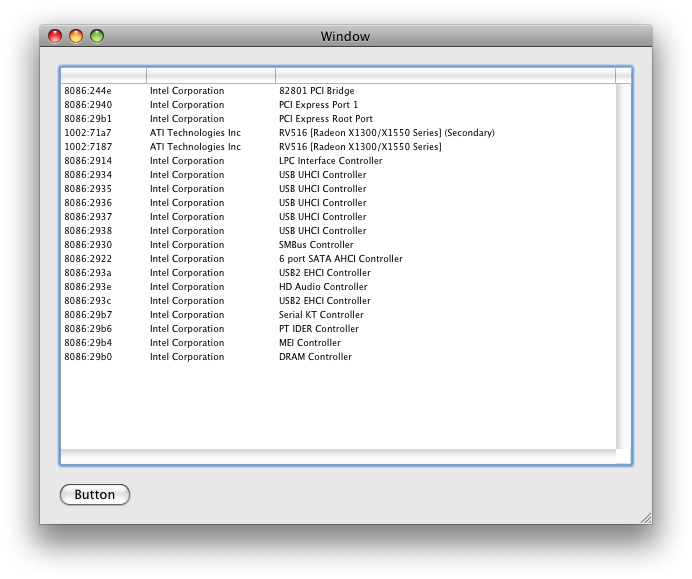

Riotz Posted June 26, 2008 Share Posted June 26, 2008 So does anyone know if this patch would work on a Dell Optiplex 755 which also uses AD1984? Here is a screenshot I took in OSX 10.5.3 with device ids. Riotz Link to comment https://www.insanelymac.com/forum/topic/92676-ad1984-used-in-thinkpad-x61-and-l61-computers/page/3/#findComment-797161 Share on other sites More sharing options...

Riotz Posted June 27, 2008 Share Posted June 27, 2008 Exciting news guys. I tried the kext on my Optiplex 755 but was not able to get it working. I was wondering if I am doing something wrong. I used Kext Helper to try to get it installed. If there is a different way of getting it in there please let me know. Riotz Link to comment https://www.insanelymac.com/forum/topic/92676-ad1984-used-in-thinkpad-x61-and-l61-computers/page/3/#findComment-798443 Share on other sites More sharing options...
mulletman13 Posted June 27, 2008 Share Posted June 27, 2008 Riotz -- this patch was meant for the way Lenovo machines handle the 1984-- which is different than the way your Dell does unfortunately Link to comment https://www.insanelymac.com/forum/topic/92676-ad1984-used-in-thinkpad-x61-and-l61-computers/page/3/#findComment-798476 Share on other sites More sharing options...

Riotz Posted June 27, 2008 Share Posted June 27, 2008 Riotz -- this patch was meant for the way Lenovo machines handle the 1984-- which is different than the way your Dell does unfortunately Ouch ... my dreams of having sound on my hackintosh just died a painful death. I hope someone is able to modify the patch or use from what you have learned to get it working on my dell. In any event you guys did a great job in breaking open this patch. Kudos! Link to comment https://www.insanelymac.com/forum/topic/92676-ad1984-used-in-thinkpad-x61-and-l61-computers/page/3/#findComment-798812 Share on other sites More sharing options...
