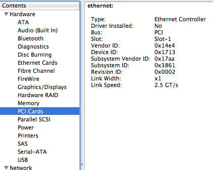

this is from tg3 info sys:
29: PCI 600.0: 0200 Ethernet controller
Model: "Broadcom NetLink BCM5906M Fast Ethernet PCI Express"
Vendor: pci 0x14e4 "Broadcom"
Device: pci 0x1713 "NetLink BCM5906M Fast Ethernet PCI Express"
SubVendor: pci 0x17aa "Lenovo"
SubDevice: pci 0x3861
Driver: "tg3"
Driver Modules: "tg3"

hi ,
not tested 32bit,again to S/L/E/IONetworkingFamily/plugin only
(this is only nobb1x 10.6.3 5787m driver(original apple kext) modded with 1713 ID,it load and connect self assigned if you hex edit only 66 3D 59 16 with 66 3D 13 17 in AppleBCM5701Ethernet.kext/Content/MacOs/AppleBCM5701Ethernet and <string>pci14e4,1713</string> in AppleBCM5701Ethernet.kext/Content/...Info.plist.)
but not really connecting,no surf,someone with the proper knowledge has to fix it,i can't .....
good luck.
Driver: "tg3"
if you want to try to mod it yourself this what is specific to 5906 from freebsd/ bge..driver
const struct bge_revision * bge_lookup_rev(uint32_t);
const struct bge_vendor * bge_lookup_vendor(uint16_t);
